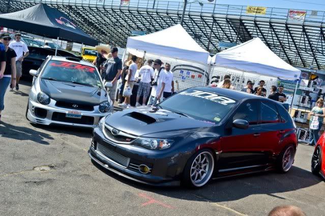

Alans 08 STI
More pics/updates via facebook:
http://www.facebook.com/update_security_info.php?wizard=1#!/profile.php?id=1260657753

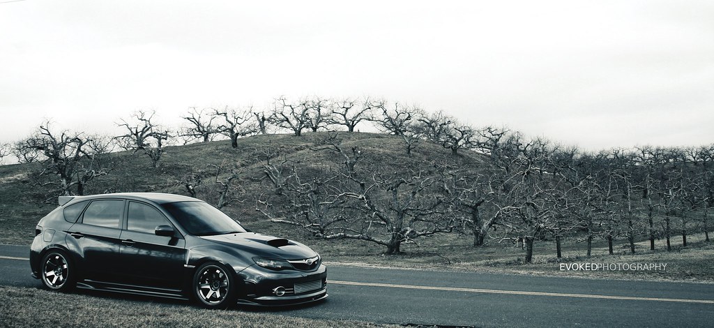

With the help of EVOKED Photography, PERRIN Performance contacted me and asked to use my car in their 2011 marketing plan. Thought it was pretty cool. This will be sent out to all who purchase a perrin fmic.
Thanks Qtip (Evoked) and PERRIN
Featured on:
http://speedhunters.com/archive/2010/11/16/random-snap-gt-gt-pick-your-subaru.aspx
http://www.stancenation.com/2011/04/20/the-dark-side/
http://ivyleagueeast.com/tag/rota/
http://www.rotashop.co.uk/blog/2010/12/rota-grid-drifts-for-when-stance-is-the-answer/
http://ivyleagueeast.com/tag/northeast/

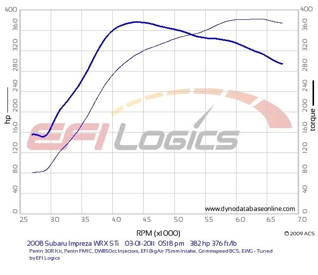

MODS:
EFI Logics Tune
Magnaflow Catback
PERRIN Rotated Downpipe
GT3076 .82AR
PERRIN FMIC
PERRIN EL Header
EFI Logics Custom 73mm MAF
EFI Logics Custom EWG Dump
Walbro 255 pump
Grimmspeed EBCS
DW 850cc Injectors
TIAL Q BOV
PT 46mm EWG
WORK Emotion XD9's 18x10+18 wheels
NSII Tires 235/40/18
BC racing coilover
MR rear lower control arms
MR rear tow arms
Chargespeed full carbon fiber bottomline kit
Titek carbon fiber front duct cover
Carbon fiber spoiler
382HP 376TQ 22psi 93oct ON EFIs heartbreaker dyno
Currently gets 23.5 MPG highway!
