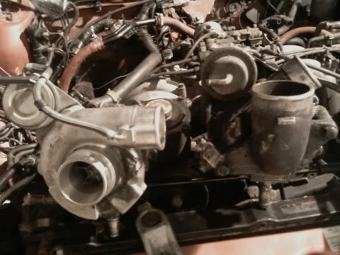

haha, I'm actually working on that right now ... I'm using the td04 though. This is the crappy pic I have for you.
Left is td04 wrx turbo, right is .. I think the vf22, 22t turbo
When I have the tdo4 in, and the intercooler "in place", the intercooler piping lines up height wise, but the intercooler y pipe actually sits in front of the turbo outlet.

Like so ... I need to get a silicone y-pipe, like peter did, and modify that to make it fit.
It might be difficult to use the stock turbo, just because of the angle. I know it's been done .. not sure how tho.
