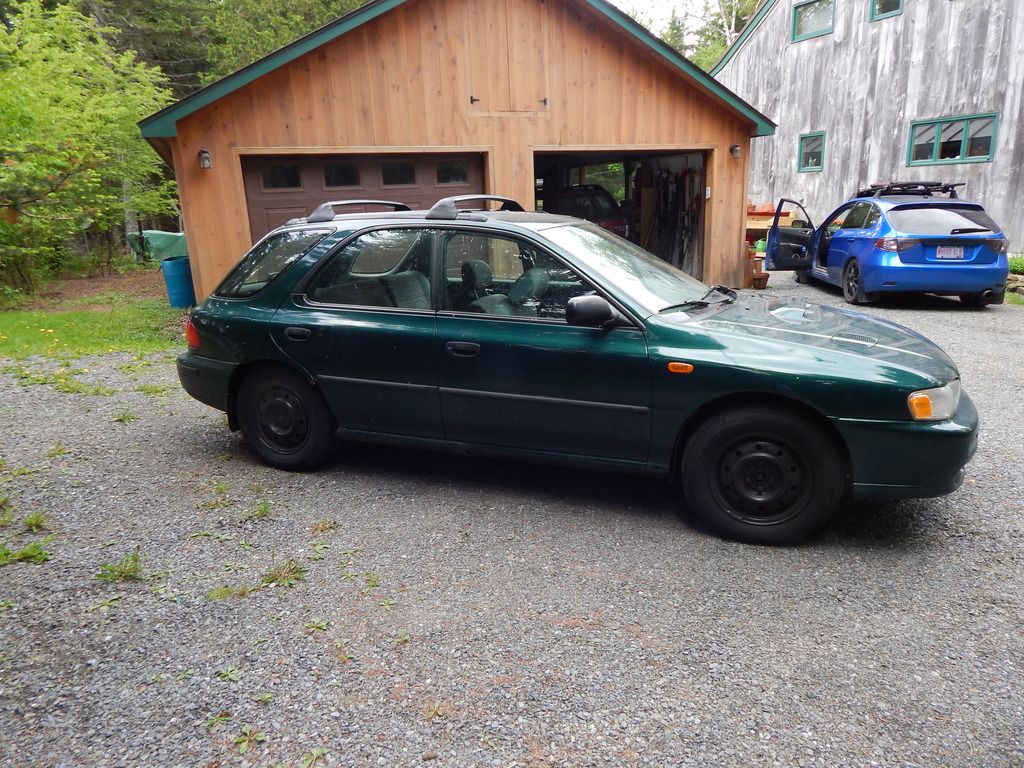

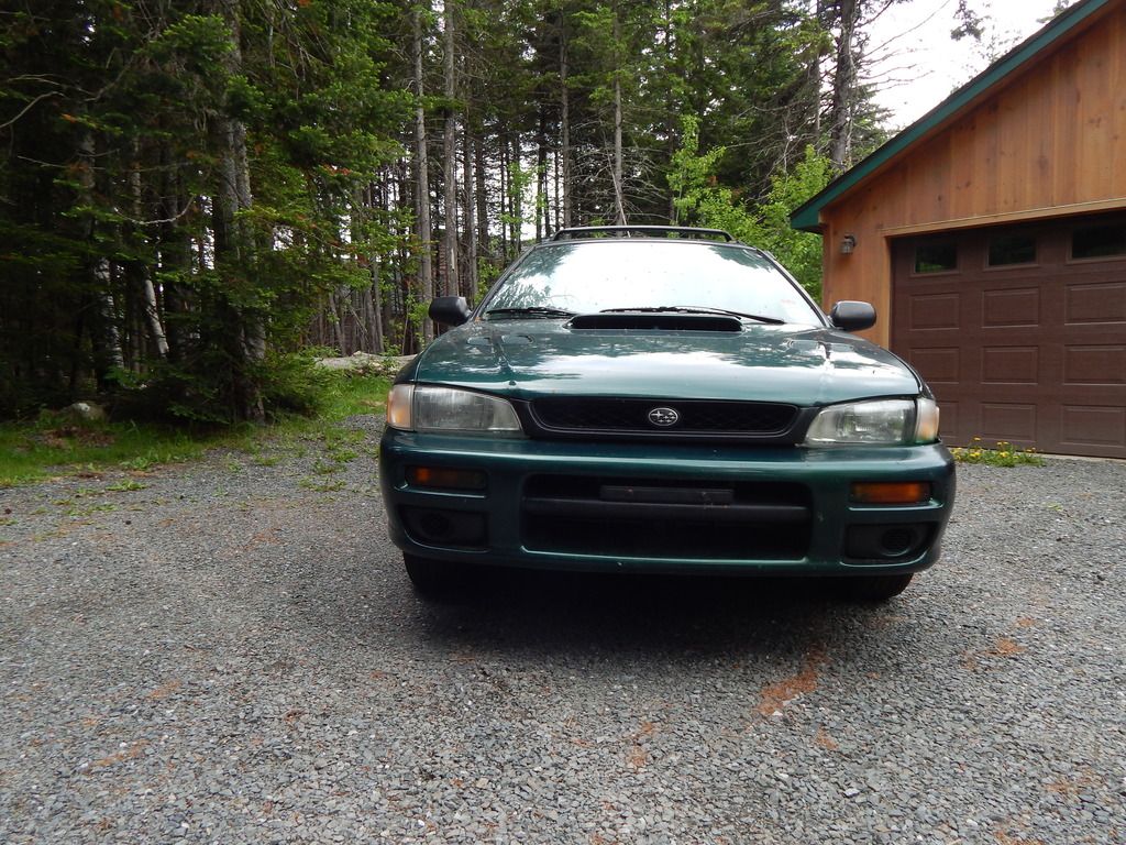

Since my WRX doesn't see dirt anymore do to the excessive sand blasting done to the lower half do to various pits and back roads. I figured it would be a fun project to make a expedition vehicle to do mainer things aka fishing camping mudding driving places cars shouldn't go etc.
Enter the battle wagon!
she's not a gem but for what i plan should be perfect(WRX and Forester photo bomb!)

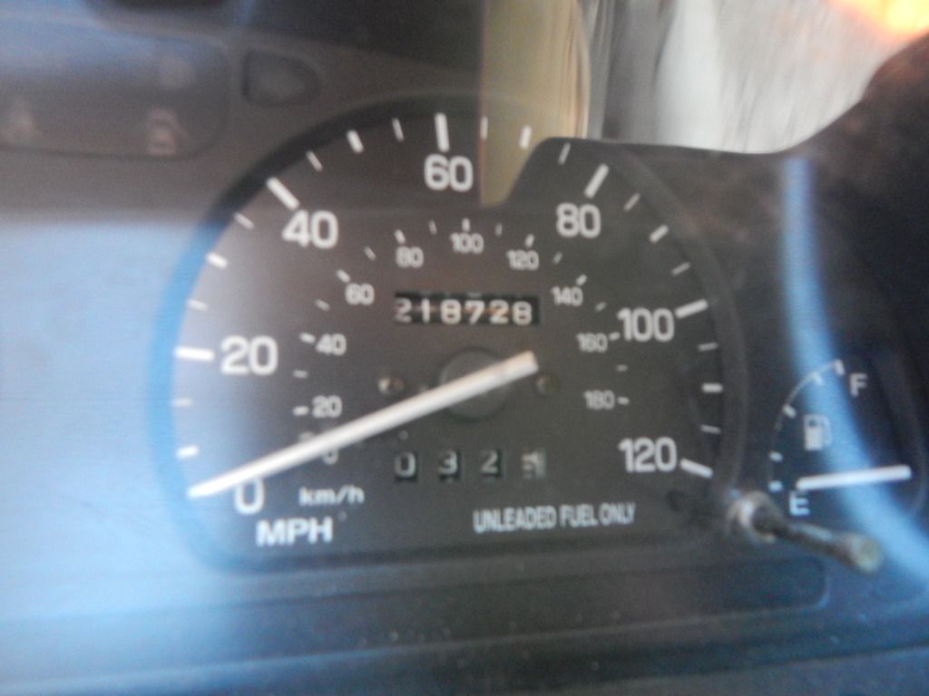

Just a few miles

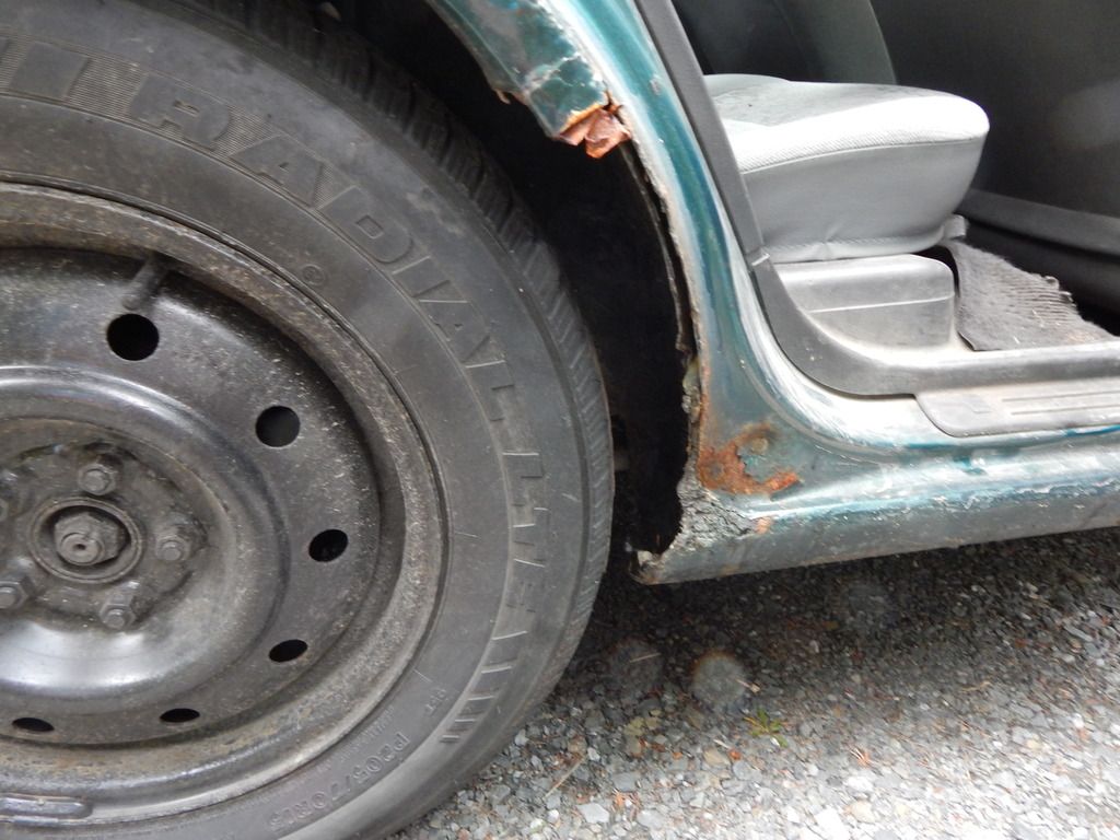

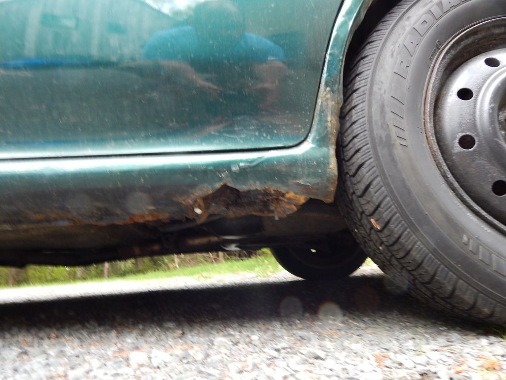

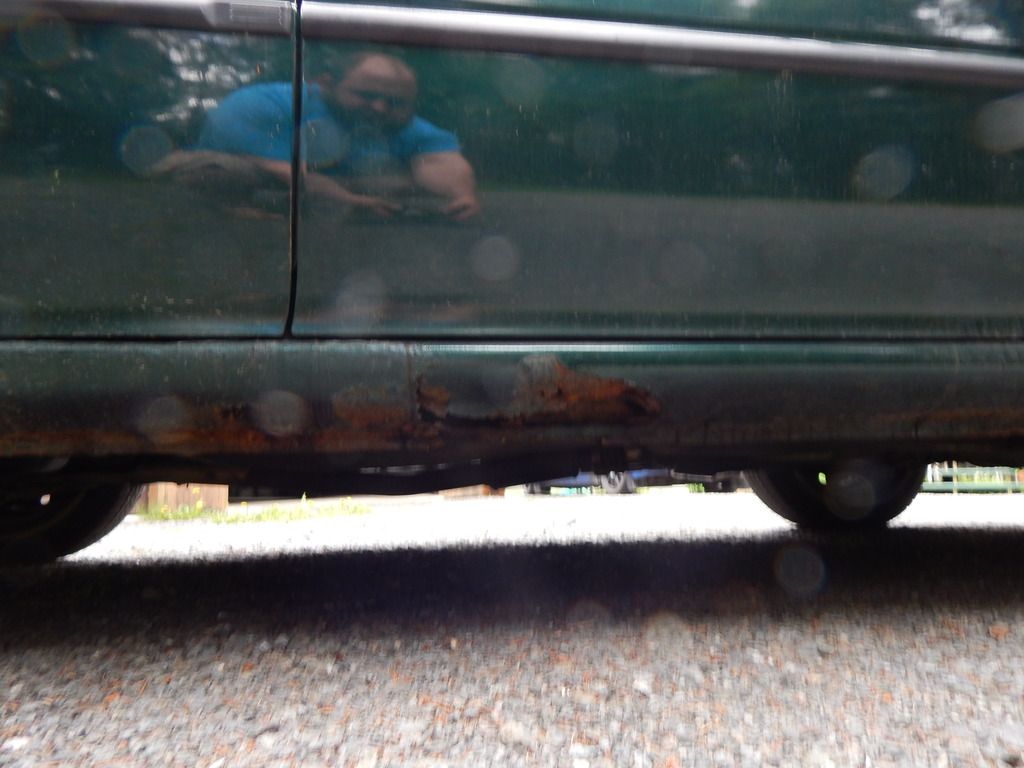

She's got some rust, but a lot of it will be cut out for tire clearance
All the cancer will be cut out of the fenders and the rockers, either square or tube steel will replace the rockers. "diy rocker guards lol"

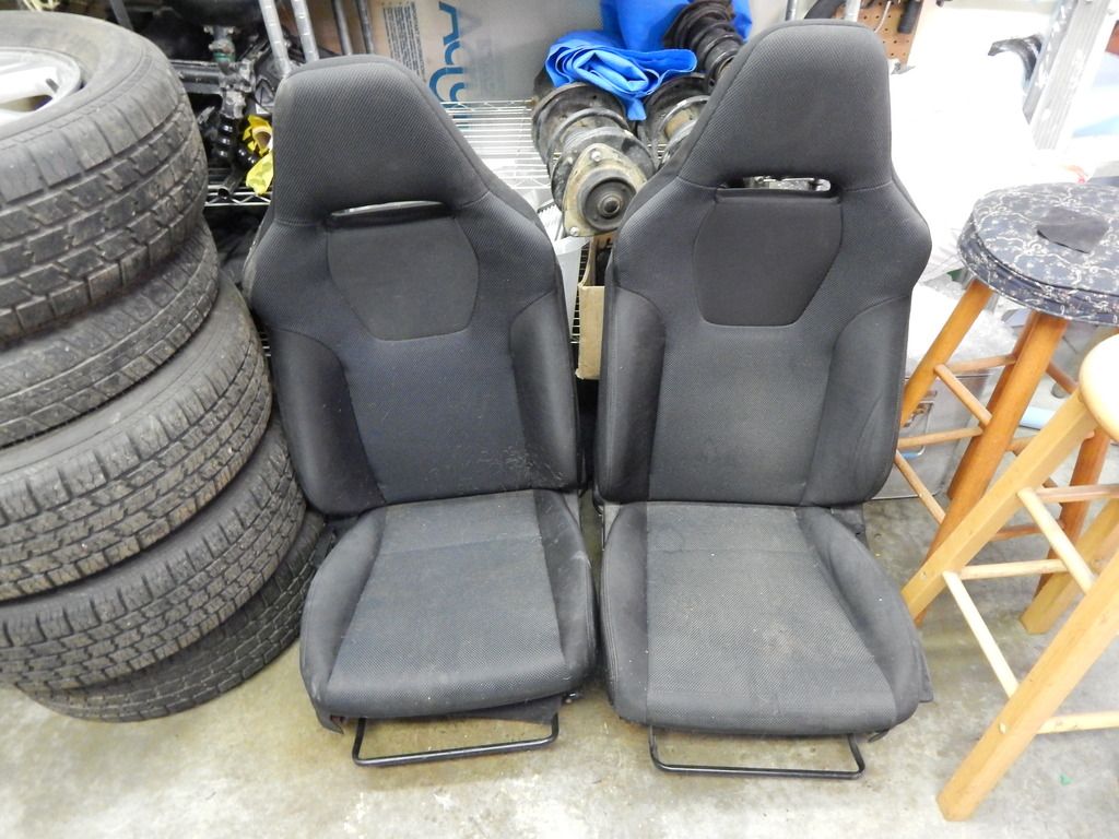

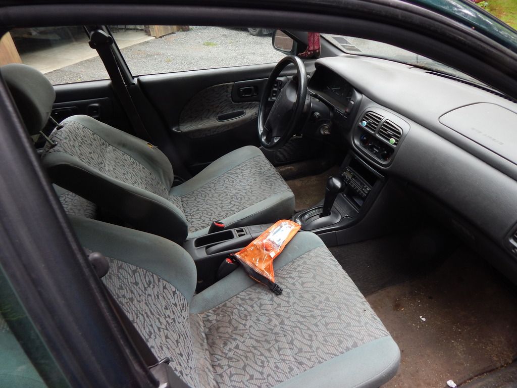

interior isn't in the best shape so all seats rugs and plastic other then the dash will go
 and my old wrx seats will go in.

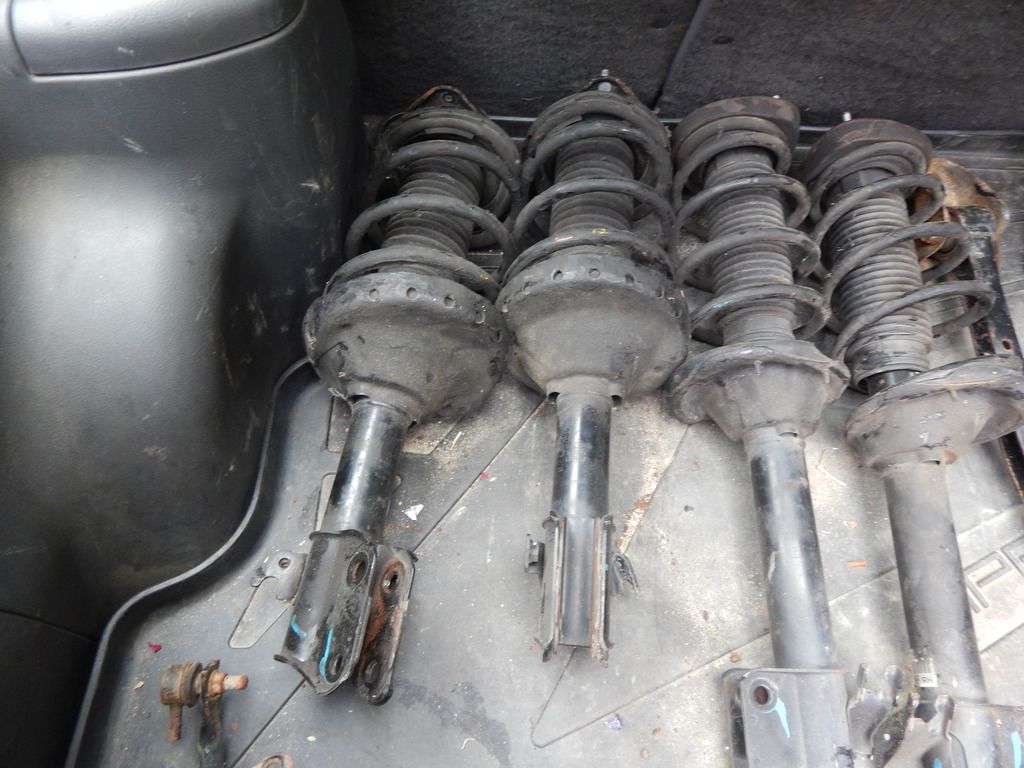

Going to lift it on forester struts(credit to dsmith for the struts)

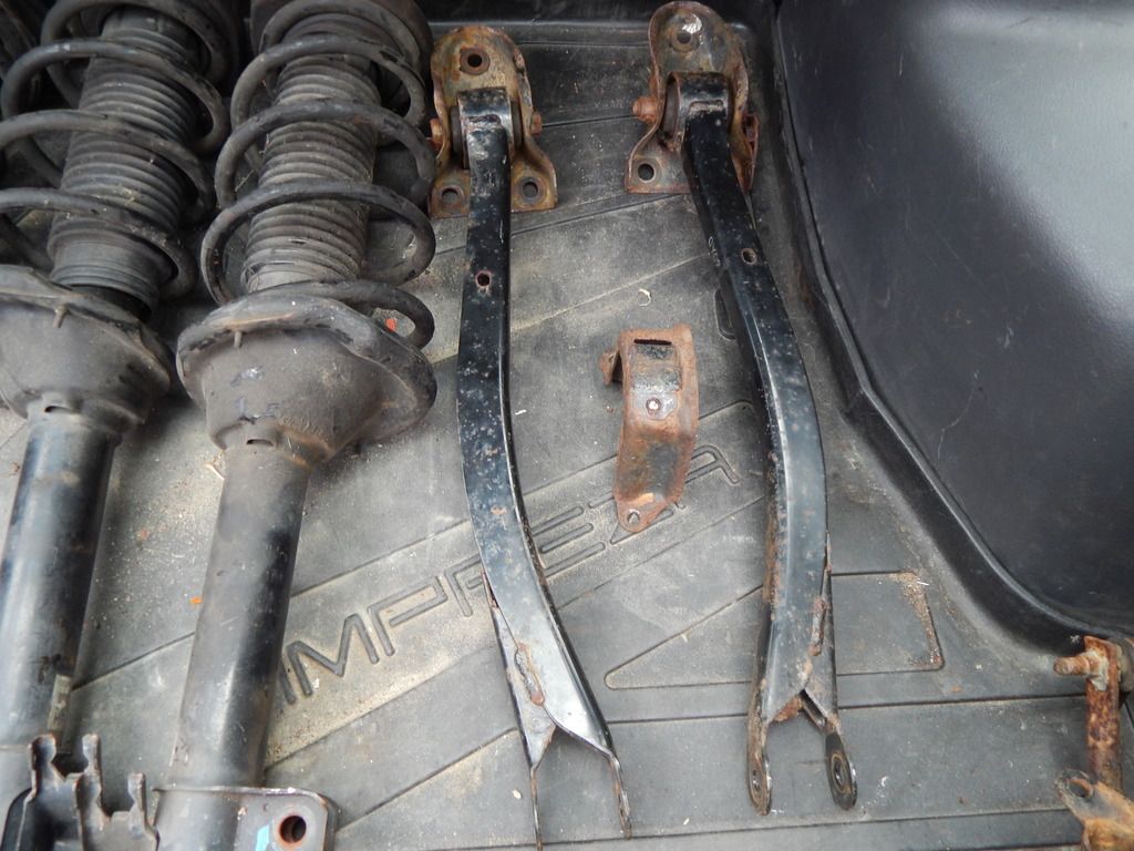

Gabe(SUBARUDE) helped me out with some Forester trailing arms and brackets to correct the geometry in the rear.

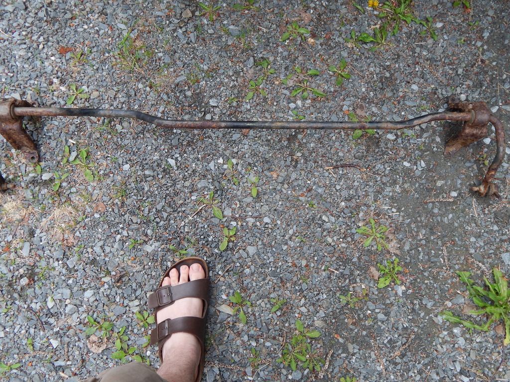

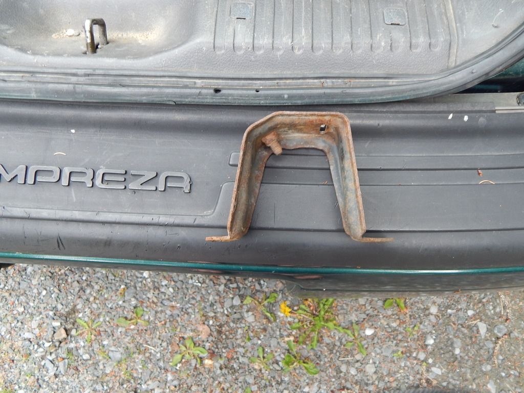

He also hooked me up with extended sway bar brackets and sway bar. Thanks Gabe!
Think they will fit?
Ok so that's the start for the lift. I'm probably going to fab up some strut spacers after I put all the other goodies in.

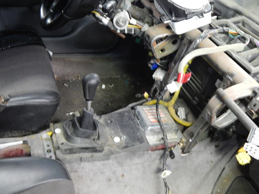

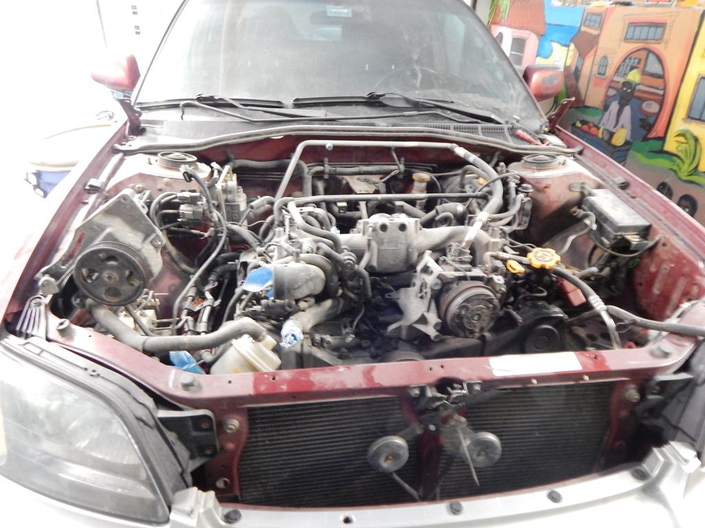

2004 baja turbo! So ill be removing that Doing a harness merge and putting it in the battle wagon!
Did i mention its a 5speed? yea that's going in too! along with the rear diff.

If you plan on lifting it more than just the forester struts, you're going to want to build, or buy a complete lift, that drops both crossmembers, and everything. The forester struts alone are going to be about the max you're going to want to lift it, without dropping everything else, or your axles will die very quickly lol. Looks like a cool project!

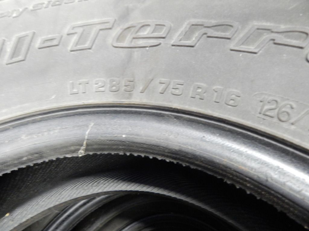

Along with the fact you're going to need a ton of clearancing and lift, and either lower strut lift brackets, or wheel spacers of you're serious about fitting those tires!
yea i plan on fabing up the subframe spacers with some channel steel, what other places need spacers? i know some modification of the driveshaft is needed, either spacers at the center bearing or outback driveshaft right?   I'm looking for some VW rims which are already 5x100 and a 38 offset to combat the huge tire issue. I got the tires from the dump. their in good shape not even to the ware mark yet so i might try it just of sh!ts and grins.
Transmission mount as well, and yeah, blocking the center bearing for the driveshaft down as well. The outback driveshaft will be too long for the Impreza body. You can use a forester one, but it won't be enough. You'll still need to block it down. You're going to need at least 4" crossmember and tranny mount spacers, and probably close for the driveshaft as well, and then 4" on top of the struts too, and then with the forester struts, you gain an extra 2" there. So it's basically a 6" lift, but the crossmembers and stuff will only be 2" higher than normal. Then you gain all the ground clearance from your tires. And you'll also need to extend your steering u joint and all your hoses and stuff too.

That's plenty thick enough. Most guys use 1/4" so yours will be plenty strong.
