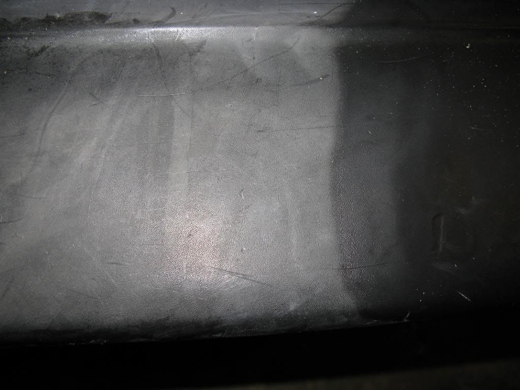

So I recently got in an argument about Back to Black vs. using a heat gun.
Back to Black is a Mothers detailing product that's designed to take old, sunbaked, whitened plastic back to black.
Heat Gun is part of my shade tree tool box. And it's a lot more useful... My theory with this is that it melts the top of the plastic back together, evens it out, and restores the original colour.
As most of you know, I'm a total shade tree mechanic. So the outcome of this thread is going to be obvious
My friend still claims I lost because I did the test on my 23 year old bumper. Apparently that's not fair because it's beyond redemption. Which is true, if you use back to black....
Here are the results. On the left, Back to Black. It couldn't do much. Middle is untouched, an the right is with the heat gun.
