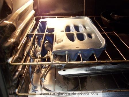

Take headlights out
Put in oven at like 250 for maybe 15 minutes
Pull apart carefully so as to not get the stingy rubber all up in your lights
Take out amber pieces
Paint if you want
Use some extra silicone sealer if you feel they won't go back together (I used it in case)
Let dry. Put back in car. done.!!
On mine and Nates we did 200 degrees, 15-17 minutes. On the 08/09 you can remove the reflector or paint it.

Tail lamps are nothing like the head lamps!! There is no black goo that allows easy separation. The lens is stuck to the back with super glue or melted to it. I literally had to break the lens from the backing. Yes, I have a couple minor cracks in the lens down low. Hopefully it not very noticeable. Goo will be needed to reseal/assemble these bad larrys.
Black gloss laid down on first lamp. I have to cook diner now, my wife is headed out to work, grave yard shift. Other tail lamp later and assembly of first lamp. Hopefully pics will follow....
Dremel and a cut off wheel.
That crossed my mind, and a BFH. Extra time in the oven made separation of the lens easier to snap free. Literally have to break it out of its little heat weld they did to put it together.
The second lamp I had in the oven 1/2 hour and used 2 screw drivers to pry it free. Not really a prying technique, more of getting the blades in the gap and twisting, working the open break around until its all snaps free before it cools off.
Second lens a lot better, cleaner, break. I'm done except for letting the sealant dry.
