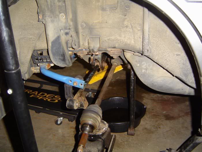

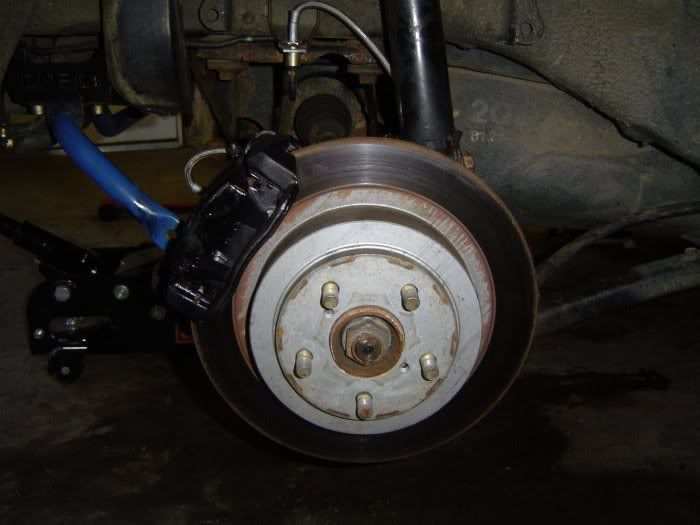

Funny you said that. I've been working on getting the rear stuff off since I talked to you. I have the front left rotor and caliper off but so far the rear hubs won't budge. Any ideas for getting that rear knuckle off? The bolt that holds the lateral link won't come out.
A sh*t ton of PB, a little heat, a huge braker bar w/long pipe extension, a powerful air gun, tons of brute force, lots of 4 letter words, and bam they come right off!!!

Thanks Mang, I got a powerful ass impact gun, just gotta put the heat to 'er next. I managed to get the nut off the front part (of the lateral link bolt) but the rear won't budge.

You may end up having to hit that huge bolt with a sledge. If you end up ruining one or both bolts, Tyler will have a set out of his car, plus i have some left over. Not to mention getting new bolts is easy if that's what it takes to get the knuckles free.
