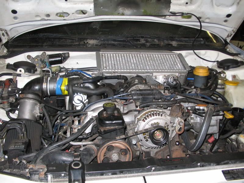

last weekend i put in a vf34, wrx top mount, sti motor mounts, and a big downpipe. Before this my car was having an issue where it was only running wastegate boost and was very slow. After all the new stuff went on it was runnig much better but still having wierd isues. withen the first few minutes of running the car will be smooth and it rips faster then anything i have ever driven. but after a little bit it starts to act sputtery and i need to be careful where i keep the petal. i cant find any vaccume leaks and it seems to be fine at times. im not sure if its an air or fuel thing, but its random and very annoying. if someone around portland wants to drive it lmk. i need this to work well

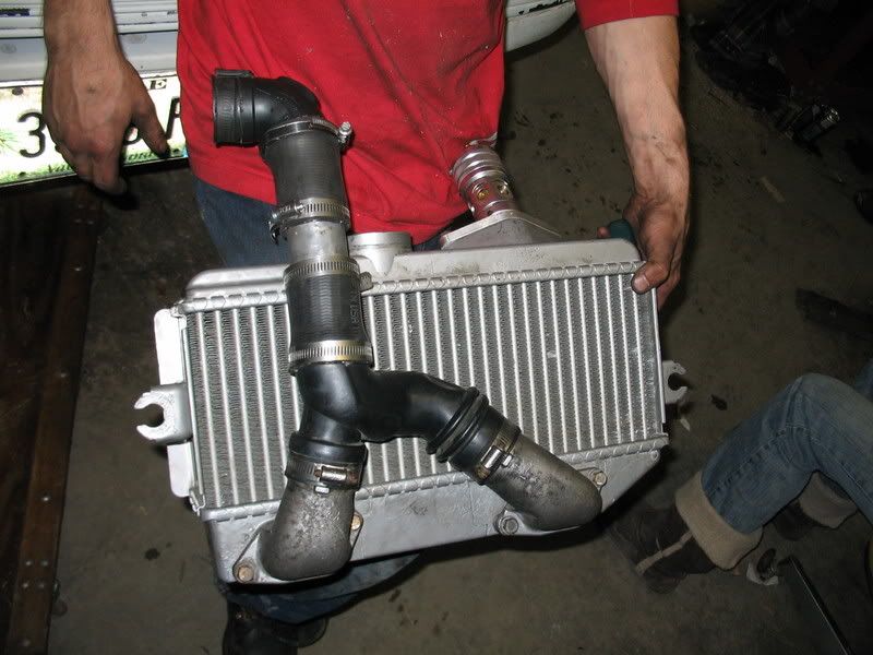

Also check IC piping. Frankenstein setup are known for having leaking issues.
i think its just something telling the ecu to mis-behave. at times the car is running mint and it is absolutly bannanas so i wanna rule out leaky ic piping, its frankenstien style but its also pretty genious and tight. the cel has been off and on for a while and it has these symptoms regardless of the light being off or on. The turbo xs blow off valve is WAY too loud by the way, if somone has a stock re-circ i would love to snag it.

ghetto-tastic

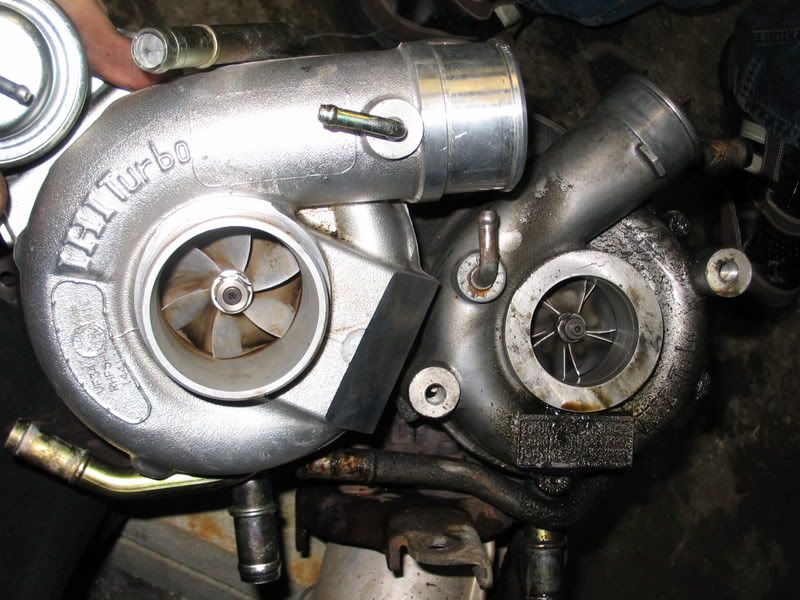

old vs new
all done
your build looks decent, now you're onto the R&D part of the project
pix of the 2 turbos tells the tale
new turbo is so much bigger, the ECU needs guidance on how to deal with it, or add'l capacity/features to cope

How did the IC fit for you. I had to pound on the firewall some and i think i am going to need to shave/trim a little of the IC or TB. Also how tall is your clutch reservoir?

the intercooler was tricky to make fit. we cut off a bit of the underside of the hood/firewall and the intercooler itself. it rests on top of a stock resevior. i could barely fit a little foam chunk between the ic and firewall to stop the rattle
