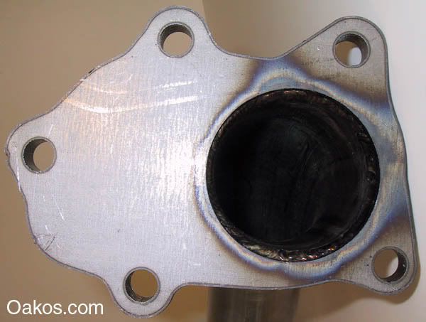

Has anyone thought of buying these cheap flat plate downpipes and cutting the flange for bellmouth style opening?
I have access to all equipment to do this but no downpipe.
you could, although you'll want it to combine back into the exhaust stream farther down stream than that. look at the bosal design. the farther down stream they combine the less turbulence you'll have. it'll also be easier on you because you can just punch a hole in the flange and then weld the far end of the WG tube back to the DP, which is a lot easier than welding all the way around that little 6" pipe.
+1 if you are making it yourself from 2 separate pieces of pipe a divorced setup would probably be easier and function better.
Do you just need the Cad for the DP flange? I can get you that if someone will let me borrow a turbo. I can toss it on the 3D scanner here and give you the Cad file.
