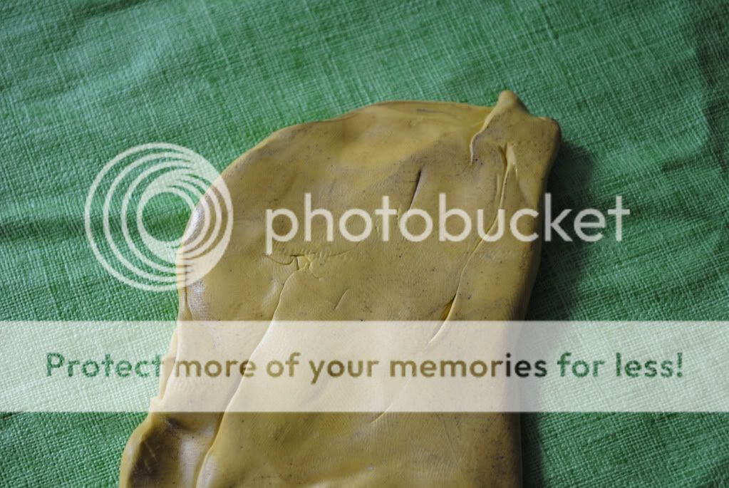

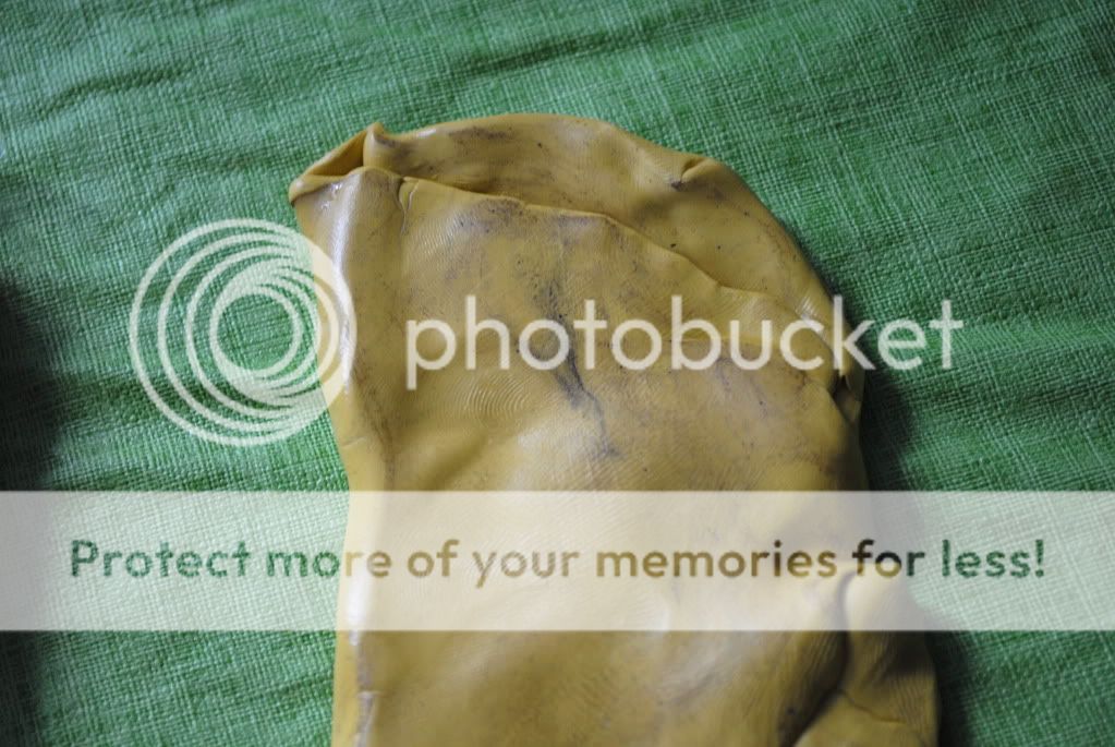

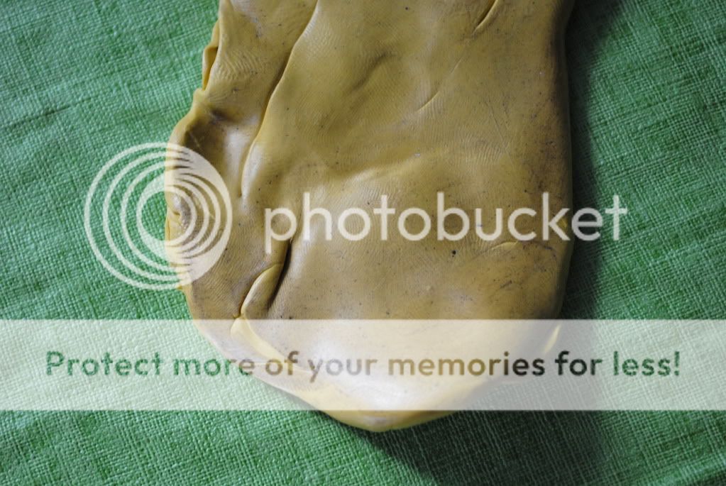

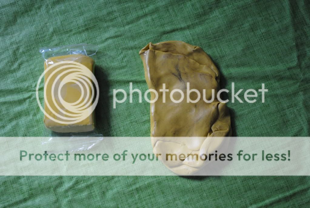

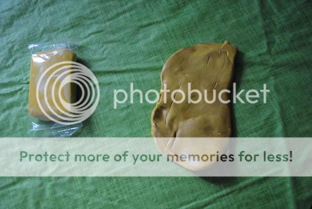

So I washed my car today and wanted to show some you guys that haven't used a clay bar before what it does and you use it after you wash you car and you can buy a clay bar kit at any auto store and what you do is spray stuff on the car and use the clay bar then wipe away pretty easy to do and well ive read on the chat a few times about people asking and seeing if it really helps well heres a few pictures of a new clay bar and the one I used on my car today pretty sure it explains itself...
Clay FTW make sure you fold it over after each pannel though and use lots of quick detailer.

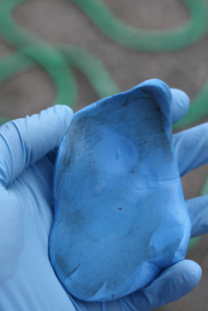

This is from a truck I detailed.
