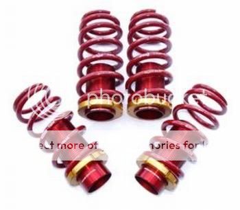

coilover sleeves - cheaper than full systems

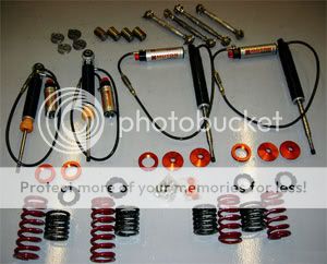

Ok, this is FAR more noble an approach than most take. If this is your reasoning, good for you. Now make sure that you know what exactly you are undertaking. Many coilover systems will advertise that they are two-way or four-way or 32-way adjustable. The more ways advertised doesn't necessarily mean that it is even better. Usually when it says "32-way", it means that there are 32 settings for damping adjustment, and they are most likely still 2-way adjustable. To better explain that, I will borrow this quote from ButtDyno from Nasioc:

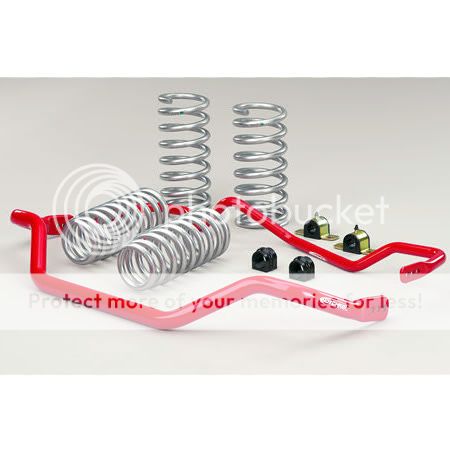

Parts like the Hotchkis TVS might be a better approach to solving your suspension woes than just dumping money on new coils.

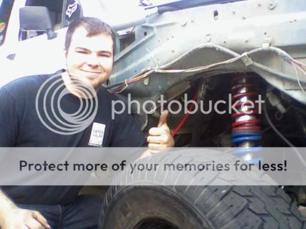

If you can't smile be all thumbs-up-like about your new coilovers like this dude, you shouldn't have bought them.
Quote:
Non-adjustable: height adjustment only (Tein Basic, KW V1. Sometimes referred to as one way adjustable)1 way: height adjustment and one of the following: rebound adjustment, compression adjustment, OR a single knob that changes both compression and rebound (Tein Flex, JIC FLTA2, KW V2)
2 way: height adjustment and separate rebound and compression adjustments (RCE T2, KW V3)
3 way: height adjustment, rebound adjustment, and separate low speed and high speed compression adjustment (AST Raceline)
4 way: height adjustment, low speed and high speed rebound, low speed and high speed compression adjustment. (Motons)
