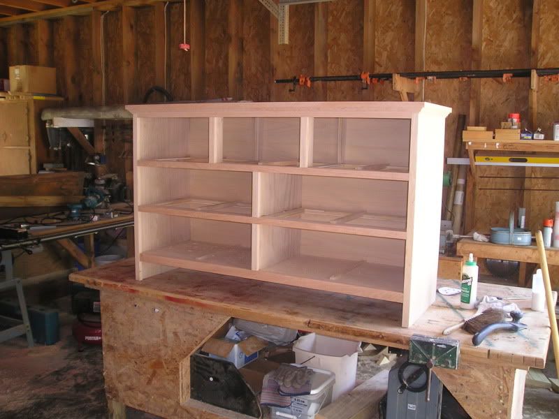

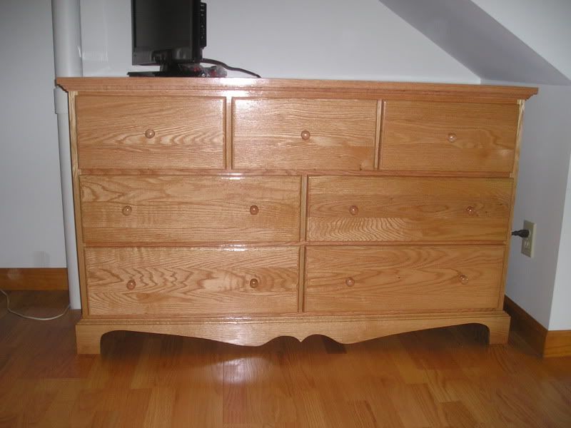

no hurry. I'm finishing building an oak dresser for the wife. she been waiting 13 year for me to make it. She is a good women. Anytime the second half of August.

Wow, that is beautiful! I just built a workbench out of birch. I'll have to show you pics sometime. I'm just getting into woodworking, but so far it is a lot of fun!

Excellent job! Yes, we have to get together soon. Are Monday evenings ok for you? I know you said your weekends are actually Sun/Mon.
