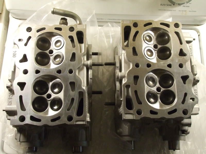

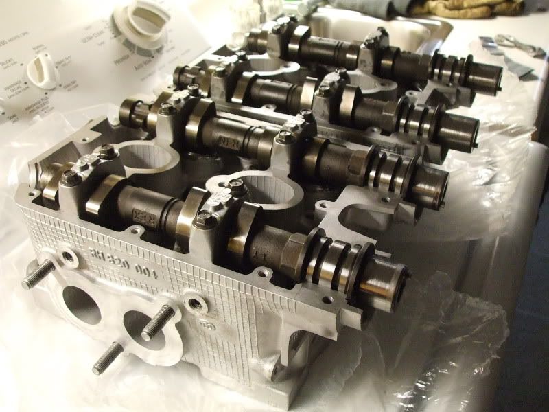

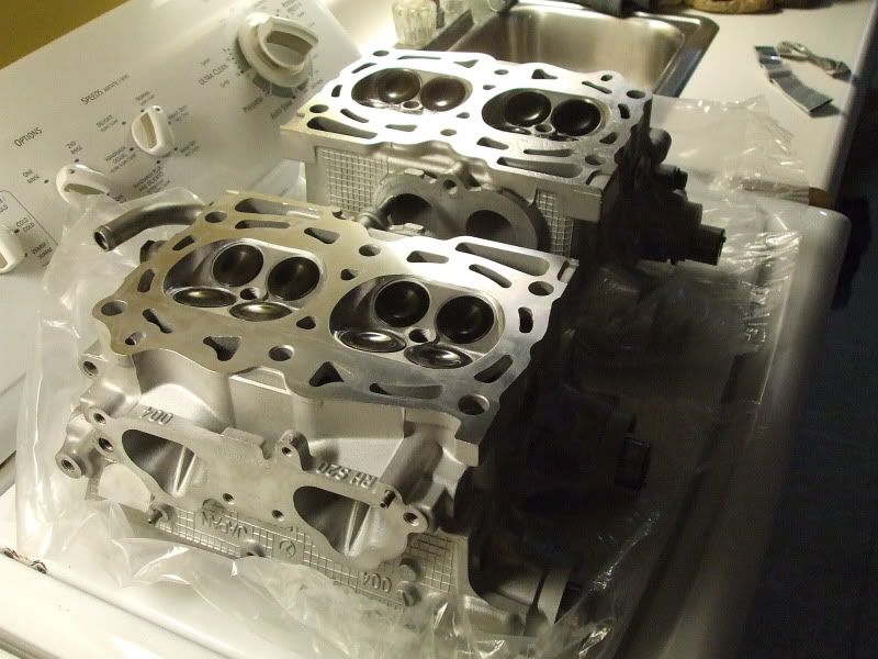

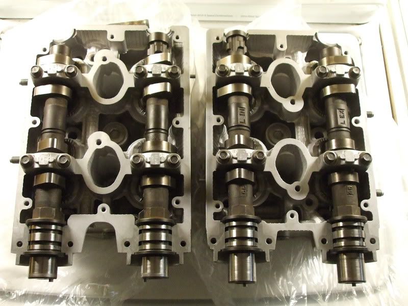

Still cannot believe these heads have 130k miles on them. They look straight out of the box! I had Equilibrium Tuning out in CA do the CNC combustion chamber work and had Butler & MacMaster do a complete valve job. Both did an amazing job!
-EJ205 heads
-Supertech nitrited valves
-Supertech brass guides
-Stock cams and springs

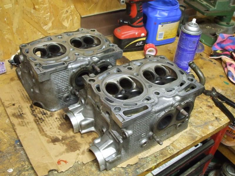

Before:
After:
Hope to have this thing back on the road tomorrow!
Looks amazing
+1
look very clean.

I like the sight of the 2liter, remnants of a solid head can be seen there.. is it the best EJ head?
I noticed no cam casing.. had no idea...
