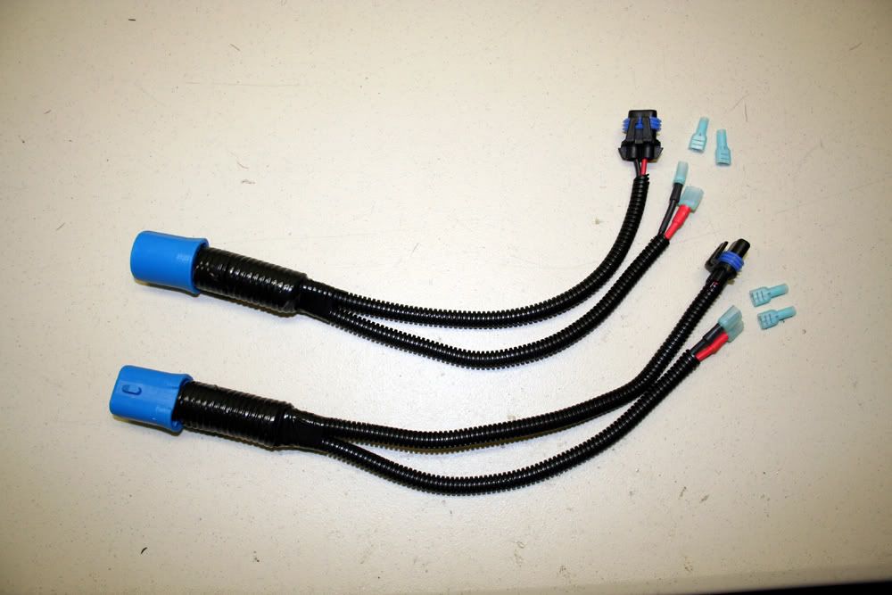

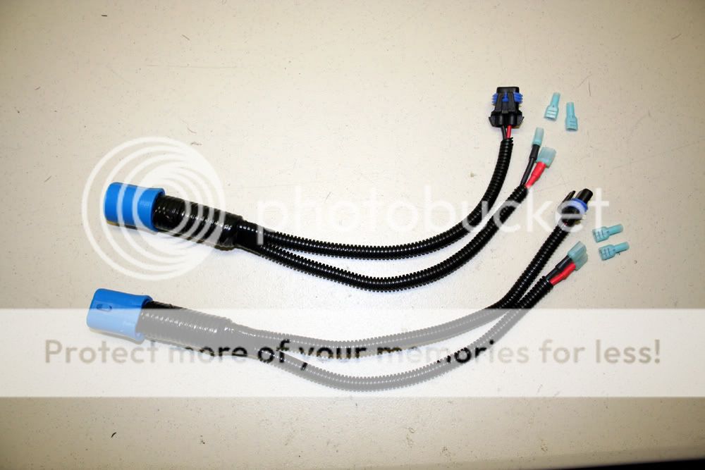

Well, that's one of the problems. I have to use a custom harness to have these headlamps work, since factory USDM 02/03 WRX uses a 9007 low/high bulb, and these projectors use H1 low 9005 high. So right now for a harness, I have H1 male spade connectors, and a 9005 male connector, both wired to a 9007 female plug which plugs into my factory 9007 male connector for power/control.

^OMG you're gonna be a life saver. I tried today and it didn't work. All I did was end up blowing a fuse. Can you tell me how you wired yours? Have any pictures?
