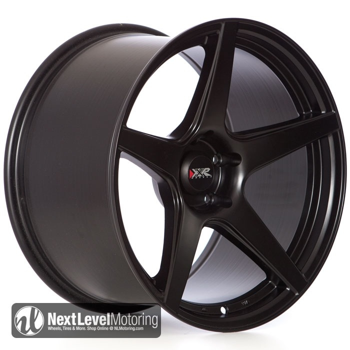

I finally pulled the trigger and ordered new wheels! I ended up going with XXR 535's in flat black and 18x8.75 et35. Now I just need tires so I can get my winter setup off!!

on lowered Foz with those phat rims, you might have clearance issues with 245s. you are in kind of a gray area where you won't find exactly what works til you try. Foz wheel wells are pretty roomy, you 'should' be ok but be prepared for snags.
I ran 245 40 18 on mine with 8"wheels with no issues. Lowered on wrx struts with STi springs.
but Bratman was running 18x8s, not 18x8.75s. that's what I mean about being in a gray area. not saying 'don't do it" but am saying, "be prepared to find it's not as simple as you'd like."
And bratman's didn't need to roll his fenders until he went up to a 245/45/18 cause it was to tall and wide
And 245/40 is the stock size for 08+ STI's
Yeah I ran 18x8.5's with 245 45 18's for a while. Had them rolled because they did rub on big bumps. But the 245 40 18's didn't rub at all, and Gabe ran the same set up without saggy butt spacers on his XT with no issues too. I think they'll be fine, or maybe just need a good roll.
