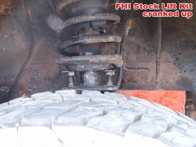

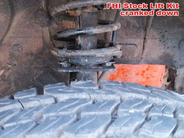

There are two bolts at the top of each shock in the front (kinda rusty, probably need some PB blaster, or torch haha) and if he jack the car up and loosens those bolts the assembly will lower. I think its has like 1' and a 1/2 of lift in it. But keep in mind when you mess with that it'll have to be re-aligned.
And shocks can be bought anywhere I believe. I'll do some looking, because if you end up lifting there are some cheap-ish rancho shocks that are direct fit for the rear, and have more travel (perfect for a 4" body lift. not like I looked into it...)
At the bottom of the spring perch. Ours are down all the way, hopefully they aren't stripped so we can jack it. Not too rusty. BTW, I found the rocker 'repairs.' I have my work cut out for me!
pic from USMB
UP!
DOWN!
