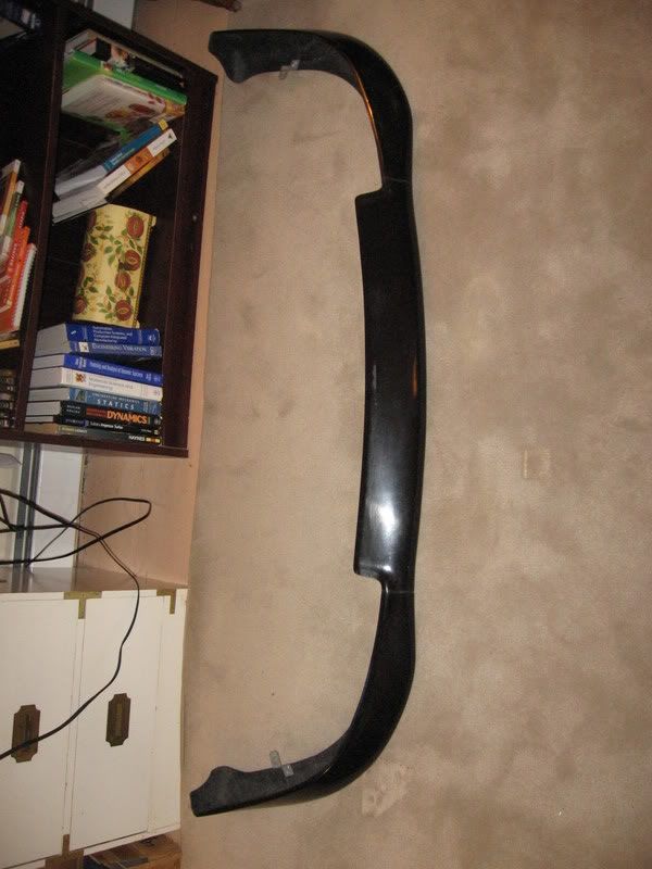

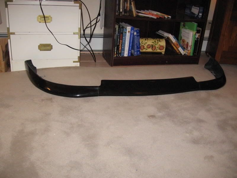

I've been piecing together the exterior bits for my V3 STi transformation and I finally picked a front lip to complete the kit. I also have rear JDM aero guards which I may sell and go with Rally Armor mud flaps... still debating.

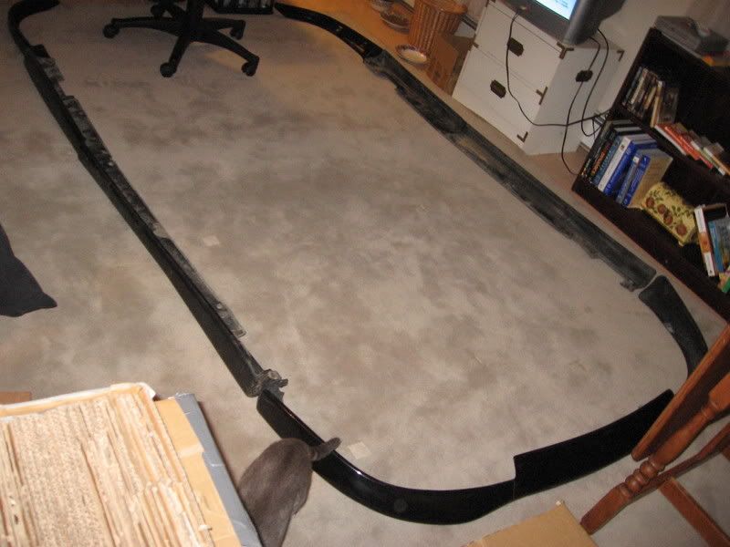

Here's the trim:
And the RA:

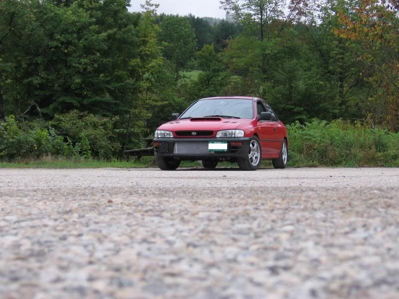

Synopsis on the car for those who aren't familiar:
V1 STi RA drivetrain w/ DCCD trans.

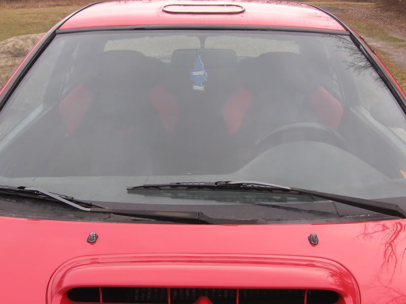

V3 STi seats
An endless list of the usual supporting mods.
Big thanks to HisRoyalRadness for hooking me up with the skirts.

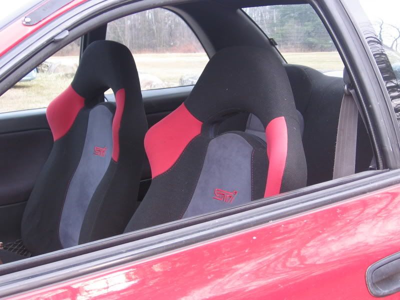

V3/4 have red shoulder bolsters only. V5/6 have red around the top of the seat and along the thigh bolsters.
Getting more and more common these days... unfortunately.
Yeah, getting more common on rs25.com, where 99% of the members live in SoCal
I've never seen seats like that in person tho.
Hehe. True, more common via the forums. This is the only set of JDM seats I've ever seen so far... and I own them. >
Hella comfy and supportive.
