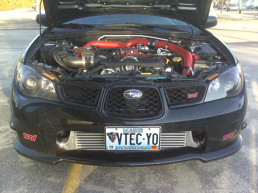

God damn that was a grandma!! 15 hours and two days later its on. I have a bunch of pictures of the whole thing which I will try and figure out how to post here when I get home. It started off easy remove front mount, relocate coolant overflow, bumper, etc.
Then things got difficult when we got to the bumper beam and those 4 freaken bolts, well mainly just the last one was a nightmare 2 hours on that thing heating cutting and pulling it finally comes off. After that cutting the bumper was fun. It came out decent although I still have to tweak it with a razer blade.

Well I have a picture but im to lazy to post it. Can I send it to someone to post it for me? Please ;D

I'd mount that license plate by the holes only, which would allow for better air flow over the IC. Not sure how horribly it would affect cooling system's performance, but hey - until you blow up, you'd have nice cool intake air ;D
Any way you can cool off that intercooler more is better...in theory. I'll defer to the resident thermodynamics guru(s) to answer that one for you.
