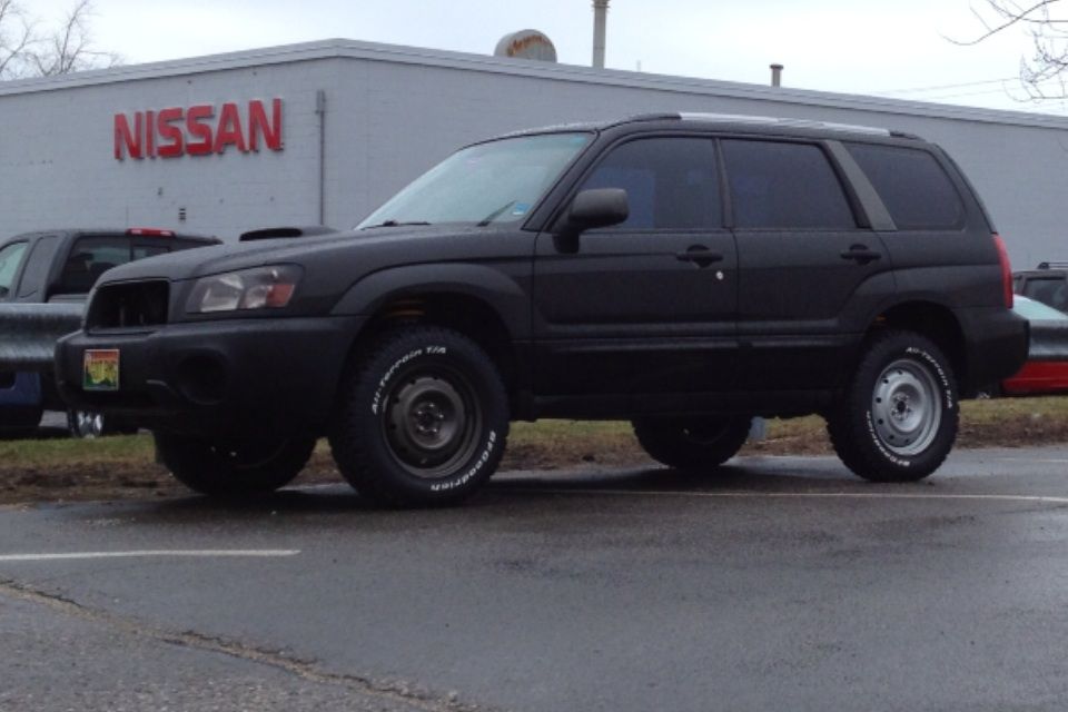

Lift teaser

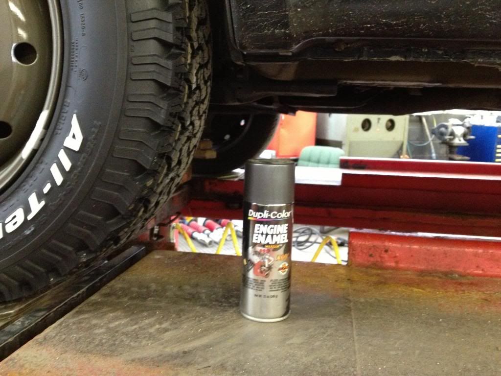

Need to finish painting wheels and take pics. Posting pics from my phone sucks!

I still gotta put the spare on the roof, doesn't fit in the tub anymore..
Getting the rear camber bolts in was a struggle. I had to loosen all the rear bushing bolts so it would relax enough to stretch everything down that far. But the alignment went well. I got it all in the green, and it drives surprisingly well!

What did you use for a lift? Looks good! And you're right, the rear suspension is different on that year Legacy.
Cool! You saved me the trouble of taking it apart!
I used king springs / kyb's, lift blocks, and lots of camber bolts...

And im painting wheels now. Maybe busting out the rhino lining... Paint the whole car with it..lol
Driving down running hill rd and spring st every day cured me of the slammed forester lol
With those all the way up in front i was almost tucking 225/50/16's. my subframe took it pretty hard over the winter :-/
And the Kings are awesome so far! Ride and handling much like the sti pinks and kyb's that i used to run. Just a bit more rigid. Primitive racing sold me everything, tons of $$, but worth every penny. I got all new mounts as well(group N). I like it so much i might put the same setup on my wifes fozz.
