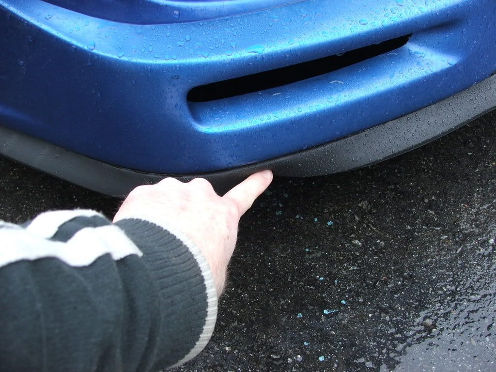

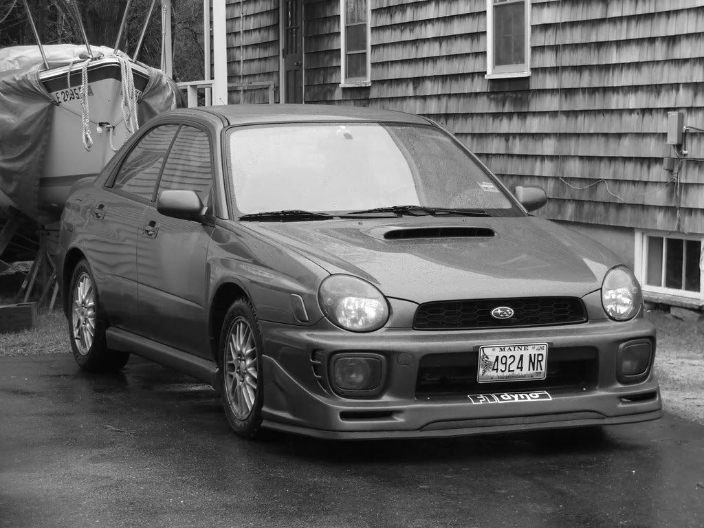

just a quick snapshot in the rain of the lip i just made. cost about $16 in the end.
nearly indestructible too.

i just used garage door sealer, its an L-shaped foam strip that goes under the door. the 9ft length will be enough to go all the way around. in the middle is some random black plastic thing so that it would go straight across.

the only reason i did the plastic corner molding on the lego was to make up for the overly short bumper, something that the garage door sealer wouldnt have hung low enough to do.

1" sheet rock screws with washers on them about every 4". the bigger the better on the washers.
i'm not too worried about it. its gonna take years for them to rust apart, and even then they're only screwed into plastic so they're not that hard to get out with pliers. all those stainless screws probably would have doubled the cost of the project too.
