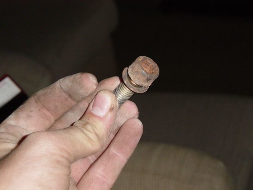

One of these is currently stuck and stripped out (hex head bolt) in the rear diff of the Audi. Been under there for over a half hour cursing at it, but that's not working.
This one little bolt is keeping the pile of raisin from moving under its own power again. Anybody have any suggestions, or even better, wanna come remove it for me? Haha.

if you heat it right, (angle flame away from rest of diff) you probly won't even heat de diff up much
get the bolt head cherry red, grab it with vise grips TIGHT, out she comes
you could try heating it up and putting a pipe wrench to it, or grinding 2 flats on it and making it fit an open ended wrench.
Off to sears I go.
There's just not enough room for a vice grip. It's a very small space, and it's recessed on 3 sides. :BangHead:

is there any way to get a grinder in there? i have had luck turning bolts into flat head screws in the past just grind then add heat. if not.....well get ahold of me if you r close i wouldent mind helping.
Not even close. I'll take a picture of it a little later so you guys can see why it was a pain to reach.
Just got back from sears with the bolt out set. *crosses fingers*
Yay! It worked.

glad to hear you got the one out. with any older car you can save hours just by taking the time to prep your work pb-blaster the hell out of every thing and let it sit and when it seems like some thing is going to go wrong STOP and rethink it befor you break stuff. that is the diffrence between a parts changer and a tech. good luck man keep up the good fight
Most of the bolt heads have simply rusted apart. It's not a simple matter of spraying penetrant and the bolt will come out. Especially these allen head bolts, they've just been sitting under there for so long that there's nothing left to grab onto anymore.

Another trick if you have room is to weld a bolt or nut onto the stripped one.
Either TIG or MIG will heat up the offending fastener in the process.
JT
mild heat and a wax crayon will do the trick too.
heat up the bolt and touch it with a crayon, the wax will get sucked into the threads and act as a lube.
