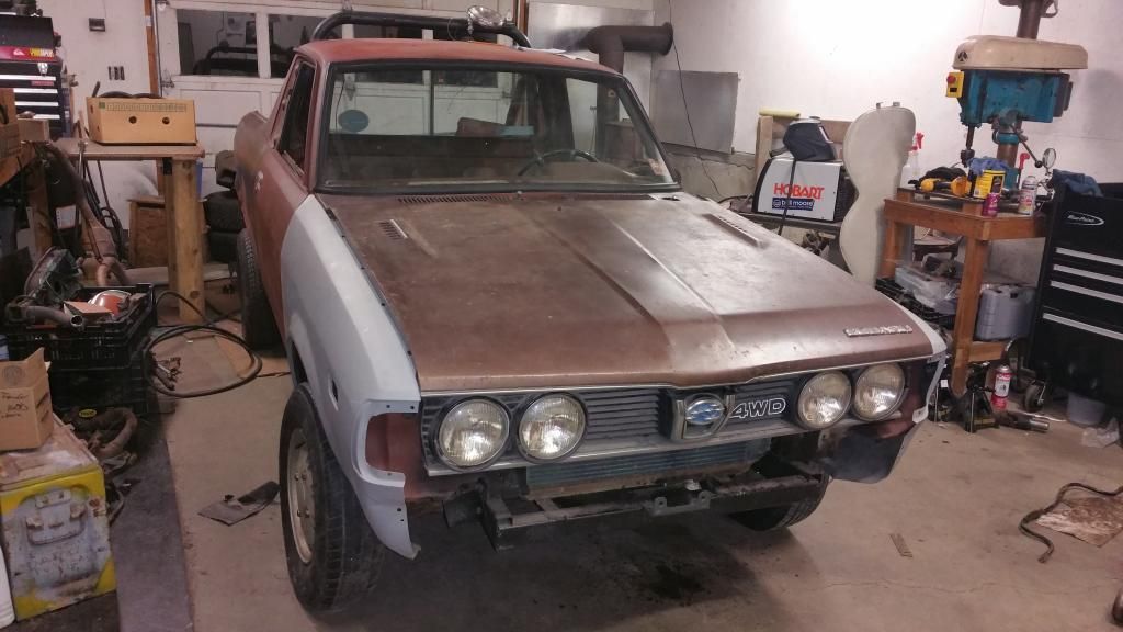

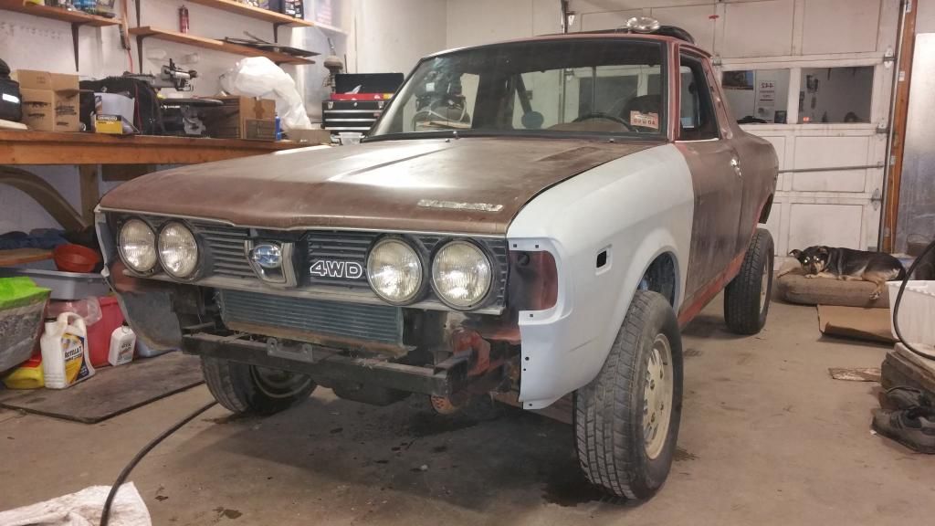

I acquired this from an old friend that had been restoring it, but has lost space and time to work on it. It has a lot of work done to it, including; front and rear ea81 crossmembers and suspension. A small lift on top of that, now has an ea81 and 4 spd dual range transmission, instead of the ea71 and 4spd single range. It still needs some stuff. The front struts will be swapped for EA82 front adjustable struts to help fix the camber it has now. Also needs a little bit of minor bodywork and paint. It's getting a spray can paint job when the weather warms up. I already have wheels and tires that'll be used on this as well. Anyway, here are some pics. It's slowly going back together currently, but should be mostly together soon.

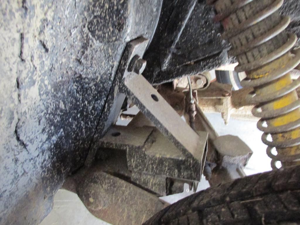

This is the rear conversion block for the ea81 rear crossmembers

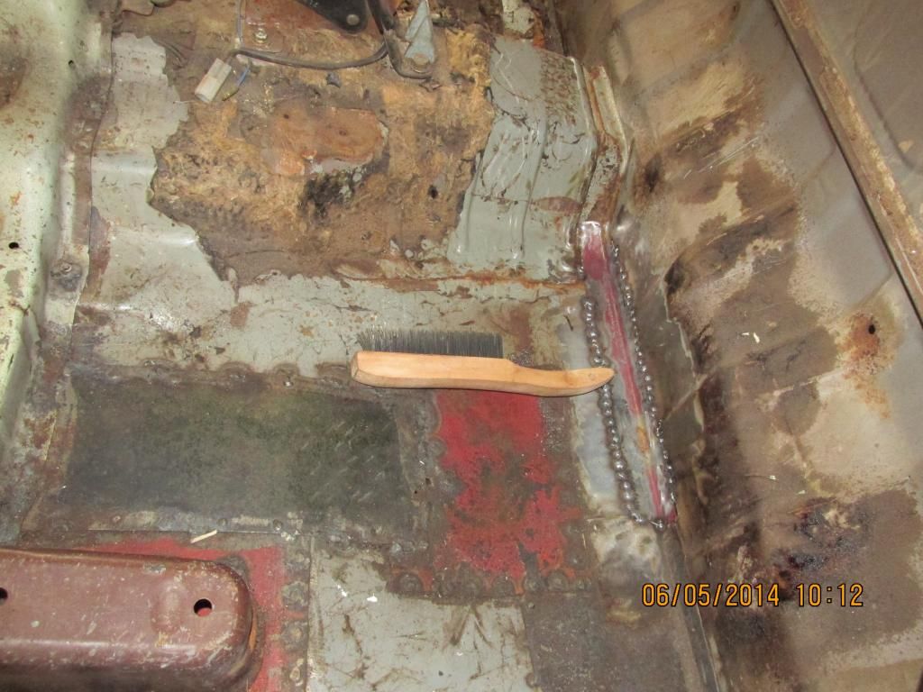

A couple small floor patches

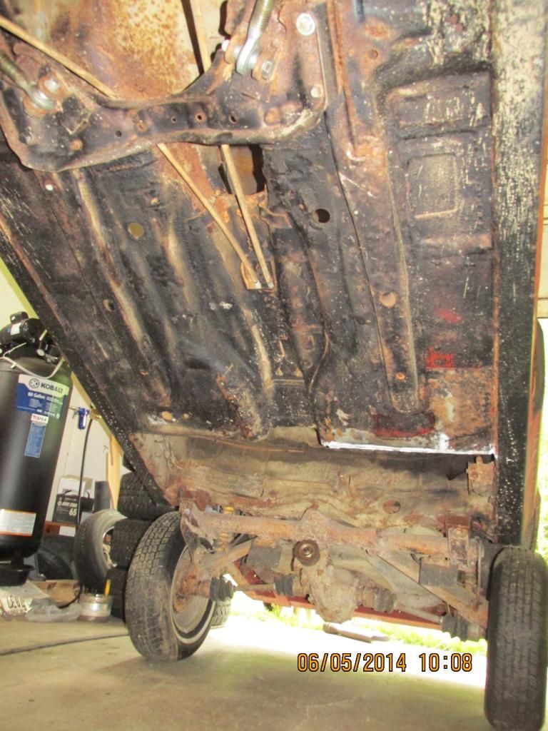

Underside is very clean

Windshield back in
View from the back with rear slider back in

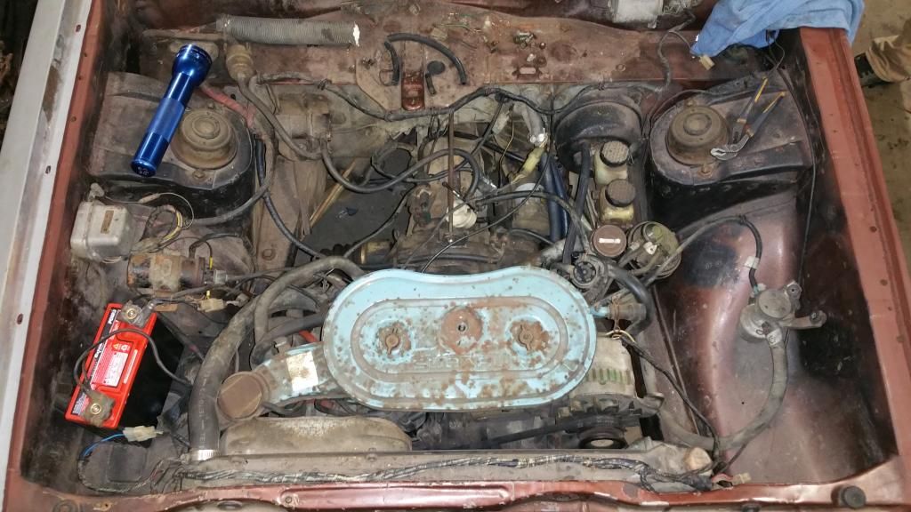

Underhood pic. Still needs some cleaning up, but the motor did run for the first time in its new home the other night.

No kidding. I'd be interested in seeing them. You must have some knowledge about carbs and crap? We're having some issues keeping this running.
Back in high school we could make any old Subaru run, all we needed was vise grips, galvanized chicked feeders for sheet metal to patch the bodies, some carb cleaner, and a hammer, and some string, spray paint from Mardens, big Oak tree with a set of rope falls for engine swaps...etc etc...   The carbs were really finicky, but we had really good luck with the bucket-O-carb-cleaner. It seemed like they were never really out of adjustment, just gunked up.  Just dunk, swish and re-install.  Is it just an idling problem, or all the time? If I ever get more than 10 hours off from work, Id take a look at it... my buddy here  in Litchfield still has that NA silver wagon too, same year as the blue turbo you got off me, may be able to rob some goodies from it if something is wrong with the carb.  It was running last I knew...
It won't stay running. It runs for 5-10 seconds and then dies. Also have an issue with the coil or something hooked up wrong so it runs after the key is shut off, but still dies because of the first issue.
Got the running issue sorted out. So it now runs and shuts off like it's supposed to.

Lol. No bondo. But there are a few weld deals that aren't the prettiest. Those will get massaged a bit before paint, but I won't get too picky.
