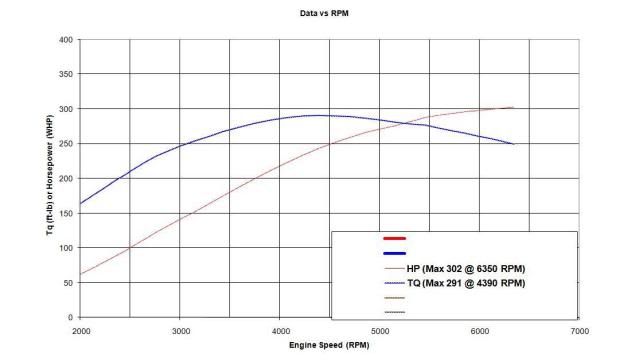

Here are my results of my dyno tuning session today with Bren. FWIW the dyno software has been proven to read about 10hp lower then another local mustang dyno.
Temps were hot today, and some heat soaking occured. This is a average of all runs. 306 two consecutive runs, and a heat soaked 298 (if i remember right) on another. The car is awesome! So smoooooth now.
Mods look like this:
VF-52
SPT catback
Tsudo DP
Perrin Intake
IAG up pipe
38mm EWG
Perrin TMIC
GT Spec lightweight pulley
Turbo XS MBC
This is all running 91 octane, and I think the EWG help with that. Running near 97% injector duty cycle on stock injectors. Also I ran into a tad bit of a UP leak at the manifold. Damned hard piped UP. Wish it had a flex. Thinking about added a Grimmspeed double thick gasket, and some extra muscle.
Tell me whatcha think.
Nate, Ryan told me you were going down to get tuned. Really nice numbers seeing how you are still on the stock injectors. You need to upgrade those puppies in a hurry.
I am kind of surprised your turbo didn't spool up on the tq side a lil faster than it shows. Maybe cause the injectors cannt keep up? Nice pulls though.
The injectors never once maxed out on their duty cycle. No issues there. The stock injectors I have out flow the older STI pink injectors of the later years. Those are all people ever need when running a VF series upgrade. Nothing needs to be done till I get a bigger turbo.

Nate, Ryan told me you were going down to get tuned. Really nice numbers seeing how you are still on the stock injectors. You need to upgrade those puppies in a hurry. I am kind of surprised your turbo didn't spool up on the tq side a lil faster than it shows. Maybe cause the injectors cannt keep up? Nice pulls though.
That's one downside to how the sheet reads, similar to a dyno dynamics. Torque is always late. Peak torque in his logs is around 3700 in 3rd.
