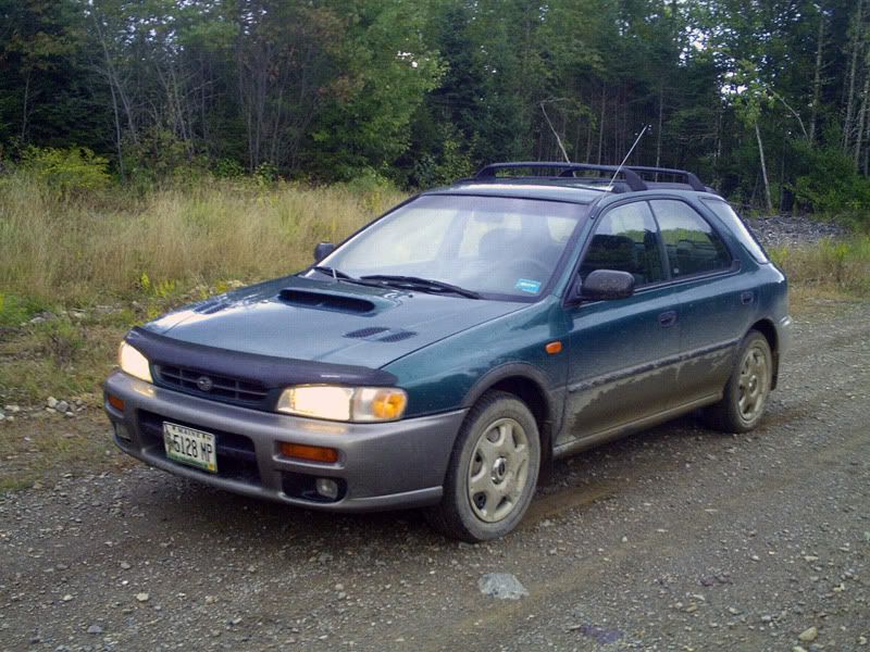

My car is a '99 Impreza OBS.
It was bought in '05.
It has the Phase 2 EJ22, 4eat.
Currently 215k miles.
Original motor, transmission, etc.
I currently get 24mpg.

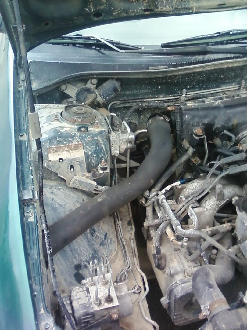

DIY CAI

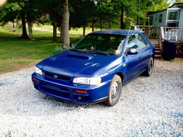

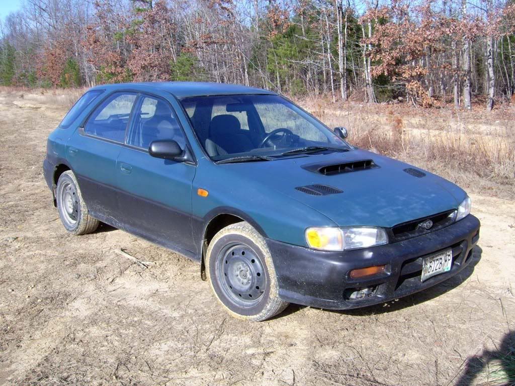

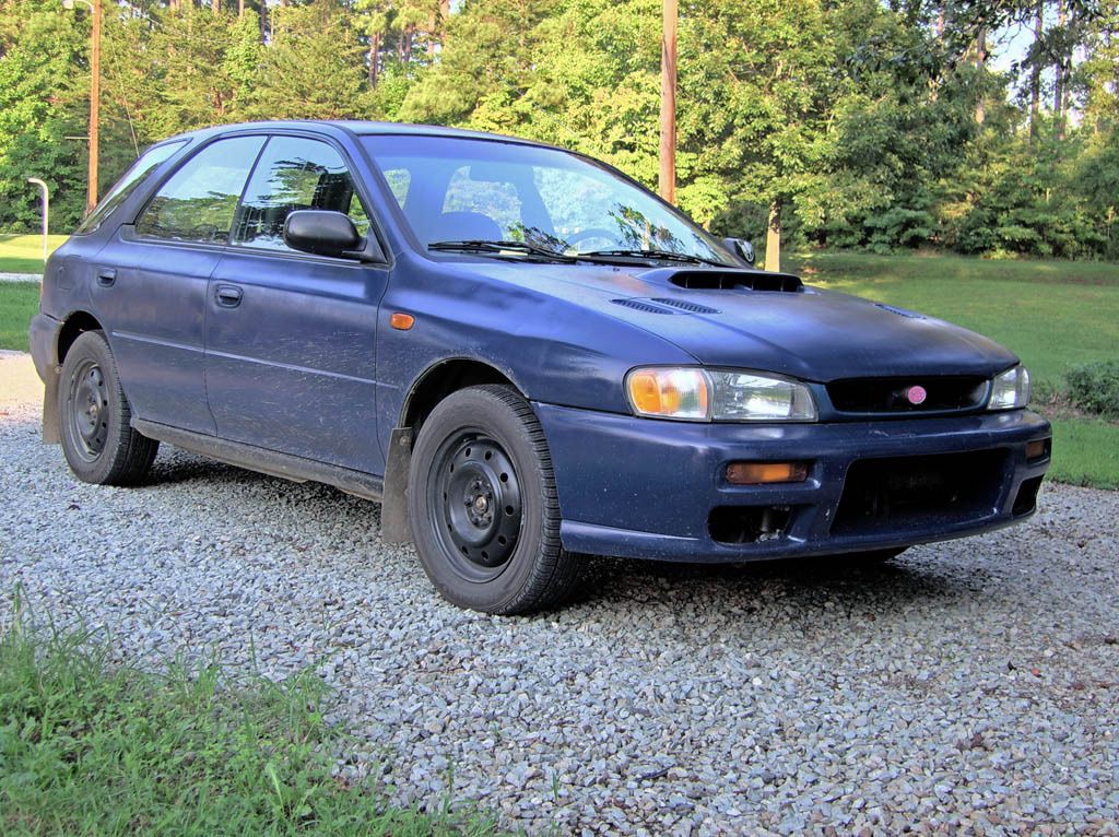

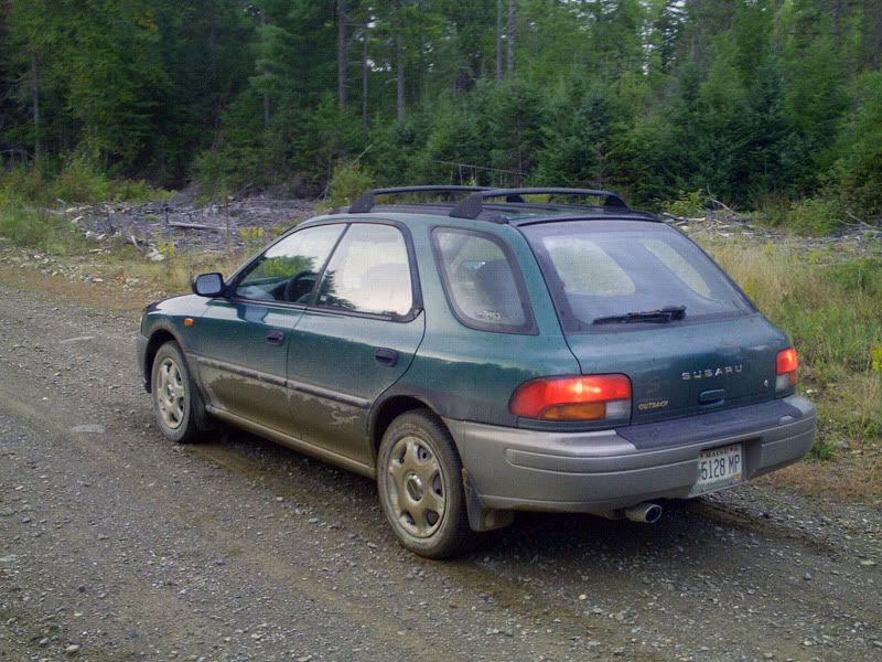

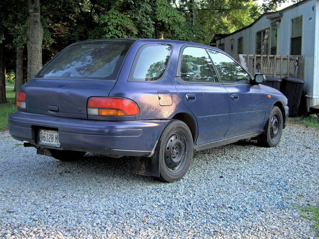

It has been painted twice. Was originally Green/silver, quickly repainted green/black, now I have repainted it Navy Blue. I'm happy with this color, but not the method I painted it. It was done with a roller and self leveling paint. It came out decent, and its very easy to touch up the paint. It just has a texture.

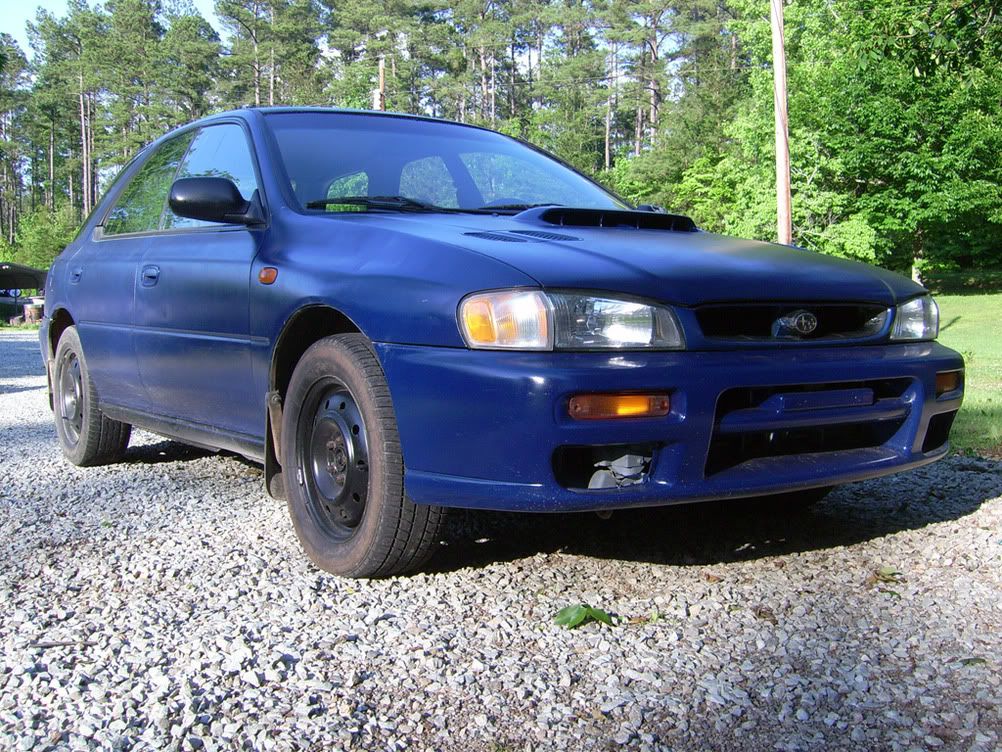

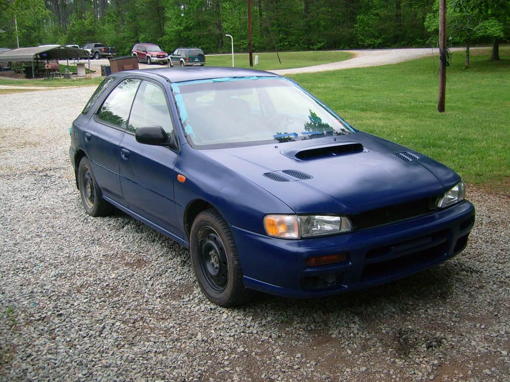

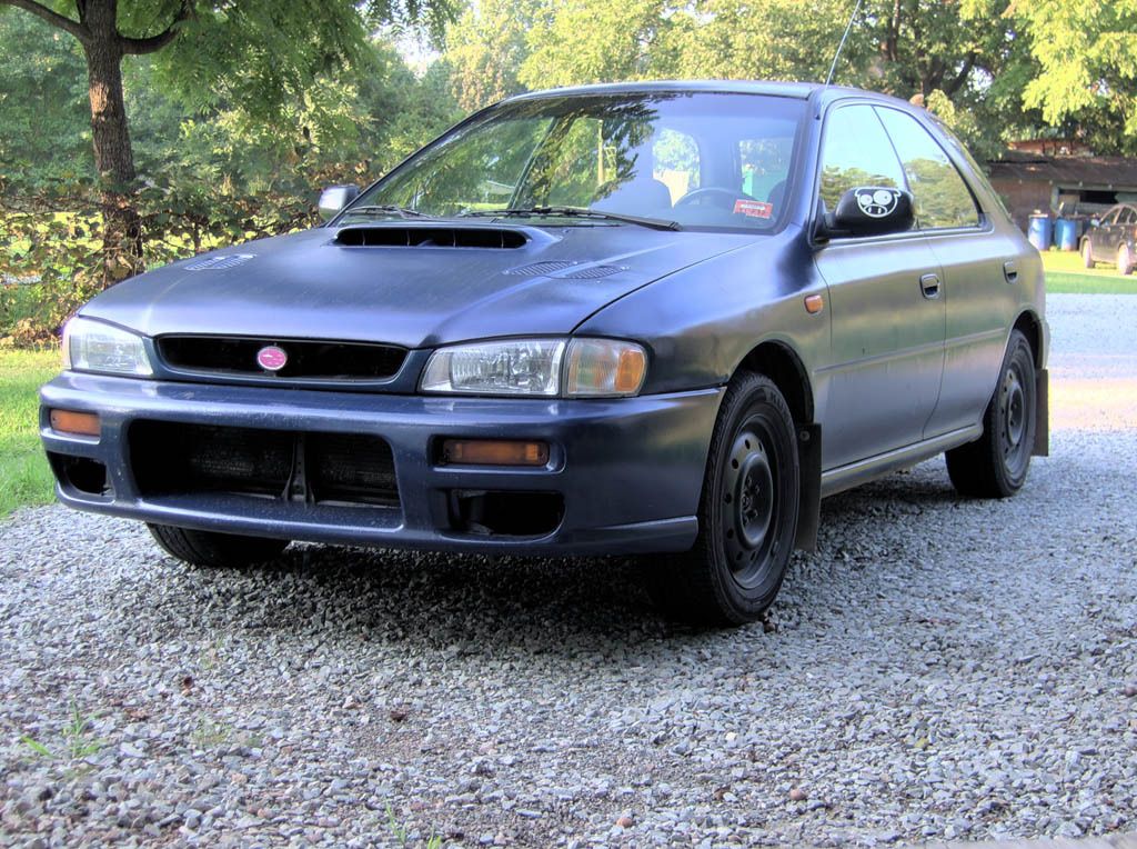

Now, pictures. In order from old to new.

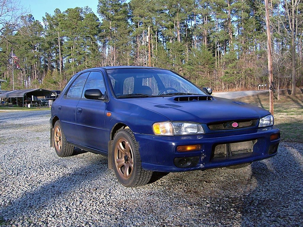

These next ones are once I got to NC;

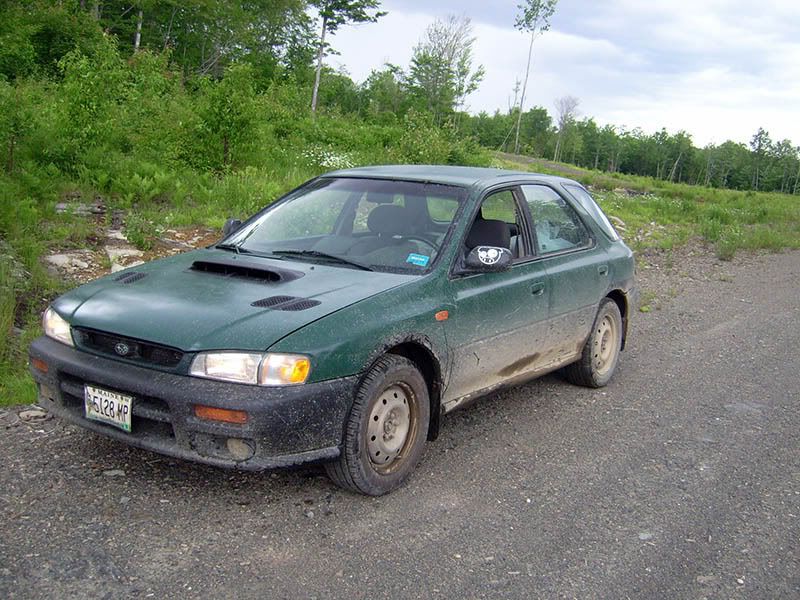

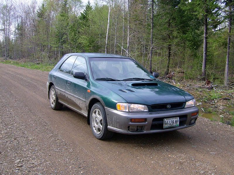

Some where on here, there is a few pictures of my car from the '10 snow drive. That was before I did any mods.

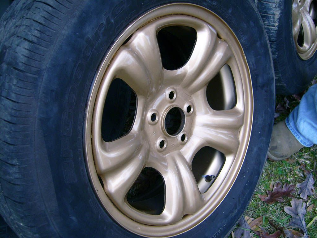

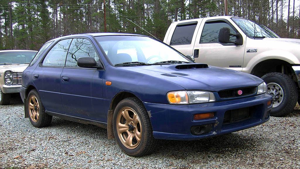

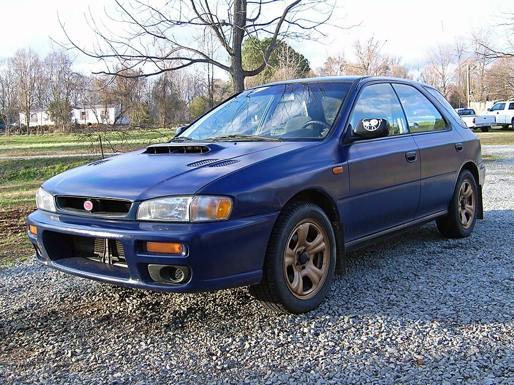

From an '04 Fozzie. Repainted them gold. Were silver but worn down to the primer.
Tires are 205/55/16 Glacier Grips.

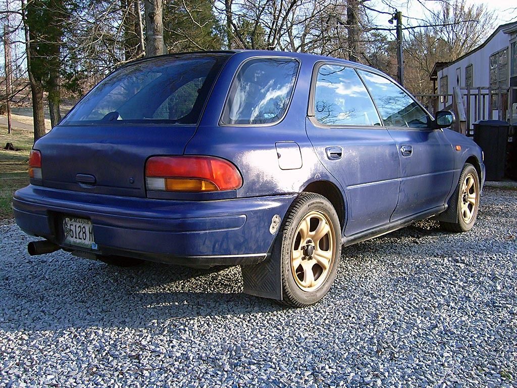

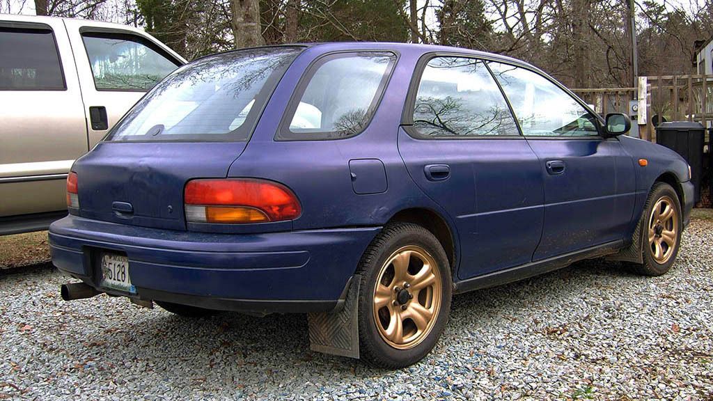

New rear bumper beam;

As for the holes from side molding, they're currently filled with some kind of.. well, I don't remember the name truthfully. Some sort of liquid metal I think. It worked alright, but if I had the choice, I would have welded in the holes and used filler to smooth it out.

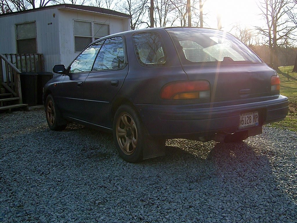

Here's some newer pictures;

Also replaced my rear bumper beam and fixed the back of my spare tire well, it was pushed in 2" or so. It made the rear look so much better, but it's far from finished.
Here's an old picture to compare. The easiest way to see the difference is by following the lip on the top of the bumper. In the old pic, you see it go up and under the hatch about half way across it. In the new pic, it goes all the way across evenly.

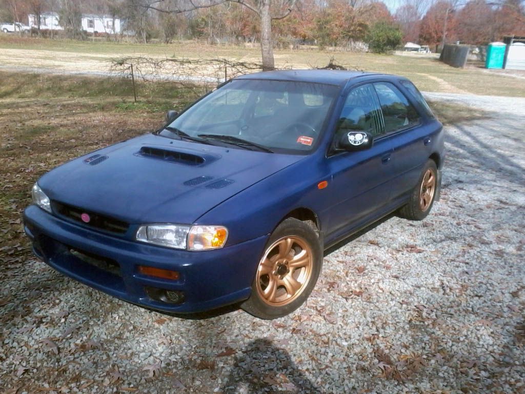

Heres another update.
Clear corners, new mudflaps, new hatch with wings, and front brake calipers changed to 2-pots.

I did make the intake, the tubing is from a late 80's Ford 302.
Updates; New wheels+tires and a new house!
2004 Baja wheels wrapped in 205/55 Douglas Xtra-Tracs
