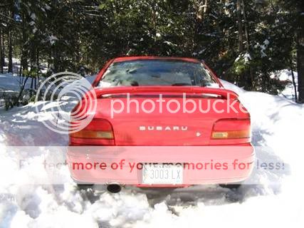

I bought this back around Aug of 08. I seem to recall the prior owner was Benjaman Moore, I guess some of you folks may know him, and this vehicle. Here are some pictures of it back then.

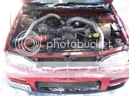

It came with many extras. As you can see it's an Impreza which was normally aspirated, but now has a large turbo. Yeah baby. Here's a list of mods
Optima yellow top
H&R Springs
AGX Struts
2003 WRX 2.0L engine with ~30K miles on it
VF39 Turbo
Pink Injectors
Blitz Turbo Timer
CAI

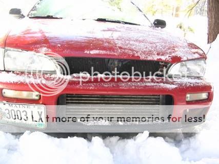

Greddy FMIC
Turbo XS BOV
Perrin Uppipe
Turbo XS Downpipe + Exhaust
Prodrive Axleback
UTEC ECU
WRX Front Brake rotors and calipers
WRX Sway bars
Steering rack bushings
Short throw Shifter
STi V2 Rear disc Brakes and calipers
JDM STi Version 2 transmission
Rear 4.11 Diff
ACT Clutch
Lightweight flywheel
