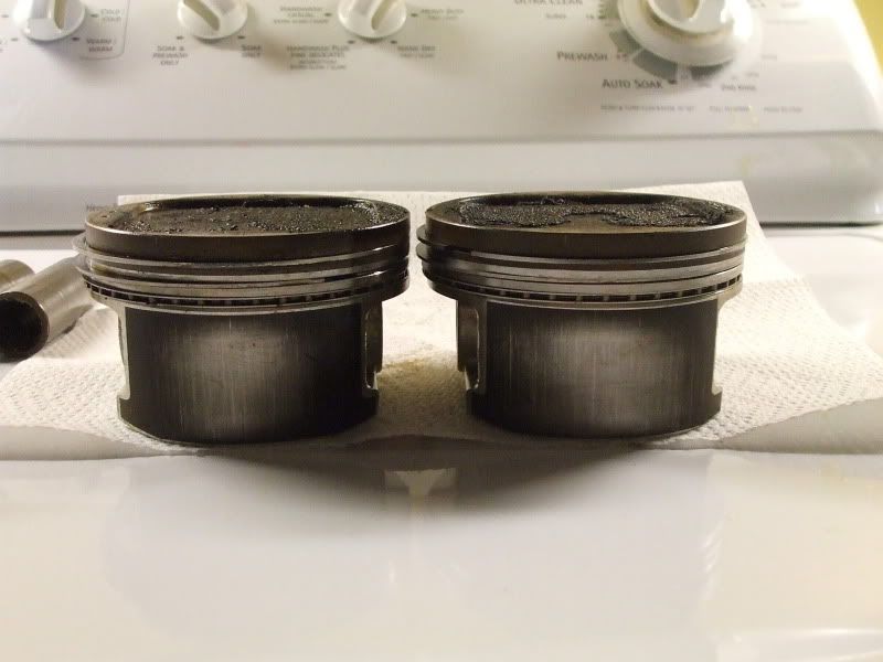

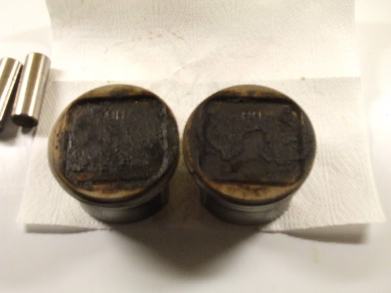

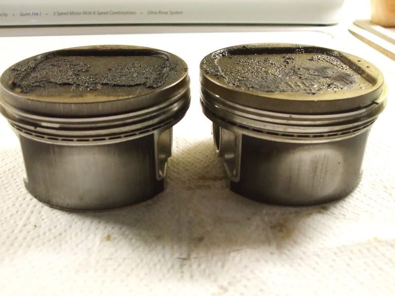

So I just want to get some opinions on the condition of these pistons... normal, not normal, etc. The sides of the pistons show some uniform scoring, but no deep scratches or anything... I've got a buyer on NASIOC for them and just want to make sure that they are OK. I don't want to stiff anyone...
These are just the passenger side pistons... driver's side are still in the block.
Ryan from seeing them in person I would say the pistons themselves look normal. Know if you sell them to the guy I would just make sure that he knows about your issues before the motor went. Maybe some new rings they might be good to go.
Ryan are the second rings wavy or is it just the pics? the piston on the left looks to have a bent second ring close to the ring gap??? could be me?? other then that slam the skinny pedal once in a while man holy carbon.
yeah the carbon is fairly fresh - still oily
The rings looked fine, but the ring gap (?) when it was inside the cylinder was a little too big for my liking....
there was a lil piston slap on the piston when she was still in the motor.
