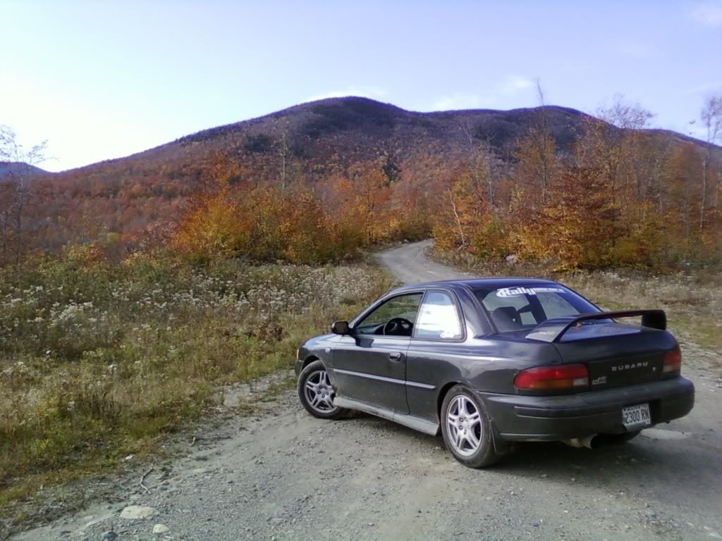

So Ive had the car for about 2 months now and have done some small things, lights, rims, Apex-i N1 exhaust and such but what to do next? any suggestions?
pretty much how I got it, after the body damage was fixed and Rally America decals

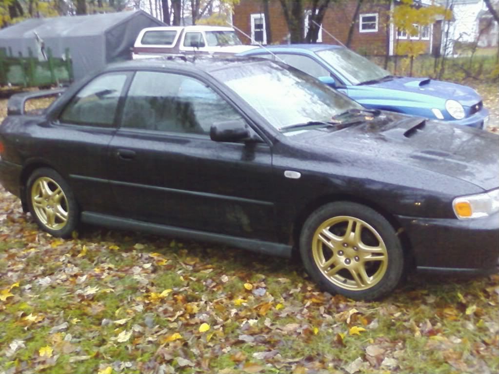

painted WRX rims
3 hella fogs, custom made bracket by me, scoops gone b/c i'm making one out of carbon fiber
when i had it up on the lift i noticed my rear sway bar was about the diameter of a sharpie:idk:
stock WRX takeoff rear sway and endlinks will be a noticeable upgrade, cheap.
Once again, Dave is right. I just put a WRX RSB with endlinks on my 2.5 and the difference was noticable at the first turn. You'll appreciate it big time!

Hey Ray is that dirt road across from the Pond Road on 156?
no its up in phillips/madrid area, it was a great spot
