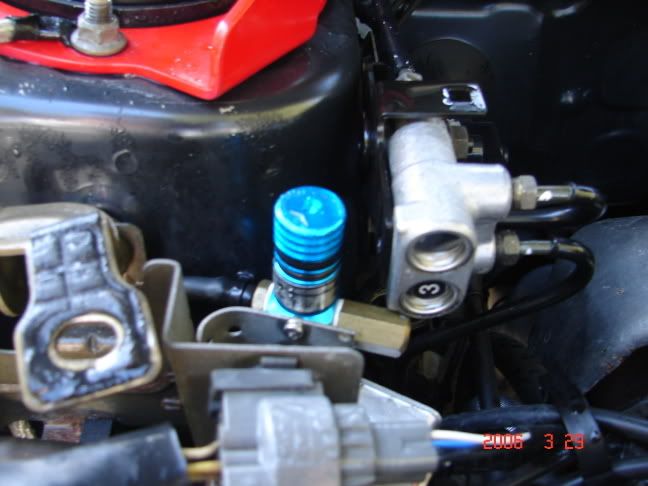

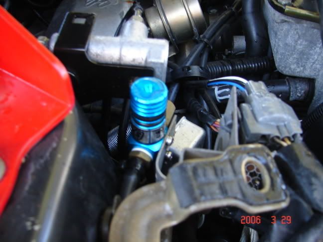

Here are some old old pics from a few years ago when I wanted to get it removed... but never got around to it.

You need the stock "T" assembly as well as a couple lengths of vacuum hose to connect the T to the solenoid and the solenoid to the turbo inlet pipe. You can buy the T for like $15 from the dealer, make sure the restrictor is on the compressor side, it's indicated by a painted dot on the hose.
Here's an image of the routing, courtesy of Cobb Tuning:
Check to make sure the solenoid isn't still mounted there before you buy a new one. When I got my wagon I could see where someone had unhooked the mbc and just ran a connector between the vacuum lines. The stock solenoid was still there but none of the vacuum lines were run to it. I picked up a tee fitting and some vacuum line and hooked it back up. Good to go. Luckily the line with the restrictor pill was still there. Good move getting rid of the mbc in my opinion.
