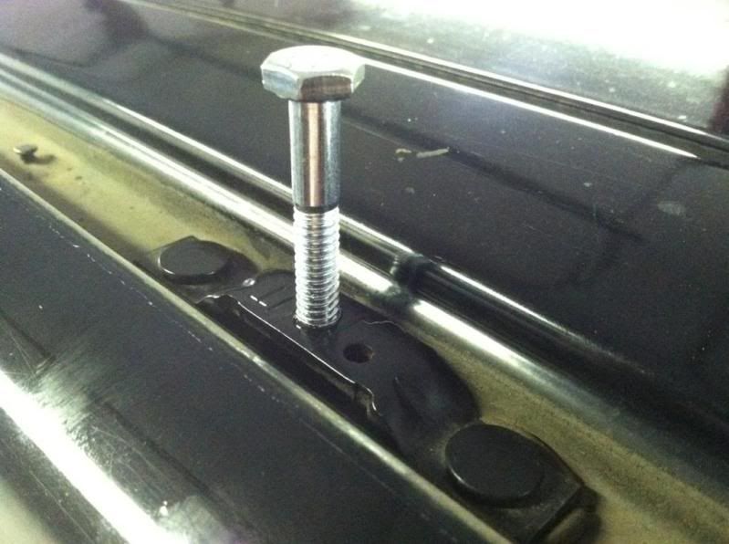

CoupedUpSubie FWD-FTW Sep 3, 2012 #4 I believe you can remove the trim inside the car and unbolt the brackets that are in the gutter area. Here is what I'm talking about, just the black part: Just curious, why are you taking them off? Last edited by a moderator: Sep 3, 2012
CoupedUpSubie FWD-FTW Sep 3, 2012 #5 Just went and checked on my car. Pop the trim off and move the headliner a bit and you should see 2 nuts on each leg.
