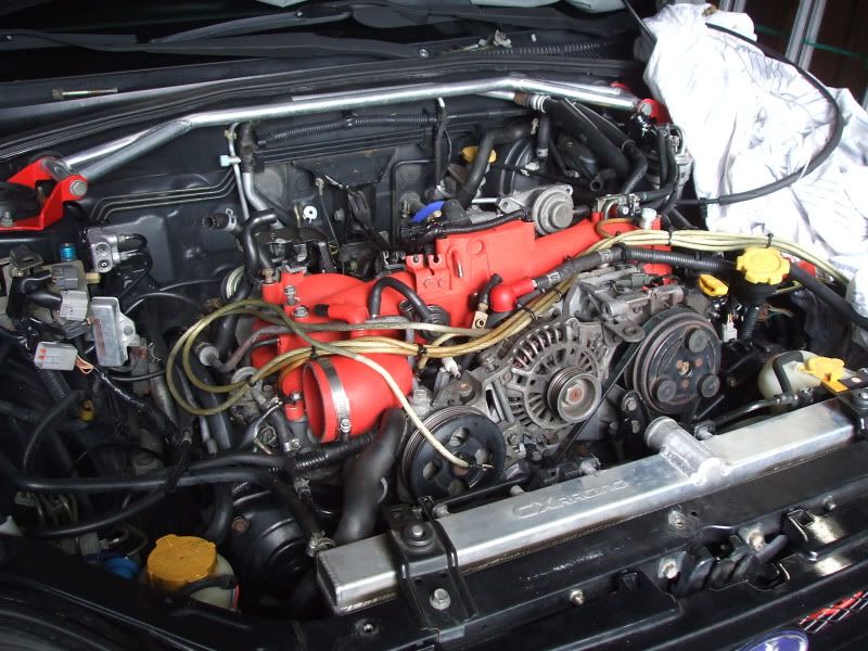

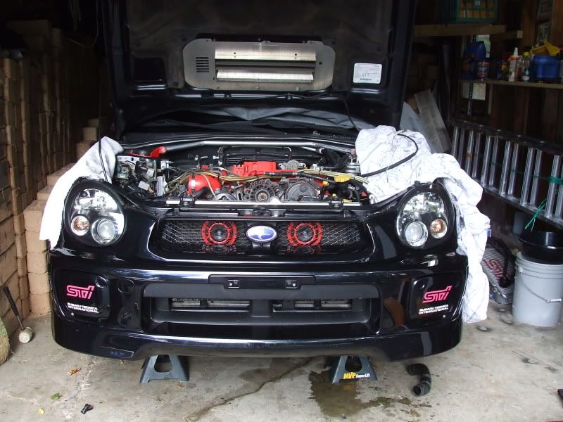

So this previous weekend, Sergei and I ripped the motor out and got it pretty much completely torn down. We didn't find anything "alarming", which we were really expecting due to the amount of oil I was losing. There was some significant carbon build up on the pistons, but nothing eye popping. We didn't get a chance to pull the pistons out completely, which will definitely unfold the story some more on what went wrong. The heads and the seals all looked fine. I'm sure we are going to find a busted ringland or oil ring on at least one of the pistons. My biggest concern was cylinder scoring. I was terrified of it. I certainly did not want to have to bore the cylinders bigger than stock size (99.5). Looking at the cylinder walls, they look fine with no scoring found (thank goodness!). Everything else looked fine. Like I said, we really didn't find anything alarming, which is a bit odd. I was losing a quart of oil every 200 miles!

Few pics from this past weekend. Big thanks to Sergei (Lobstah). He has been a life saver and I cannot thank him enough.
