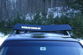

The old style is too wide to fit between the rails:

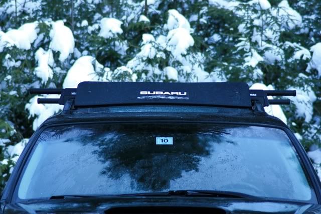

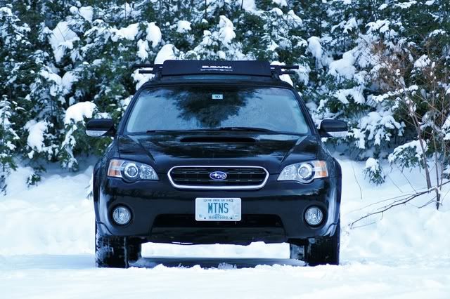

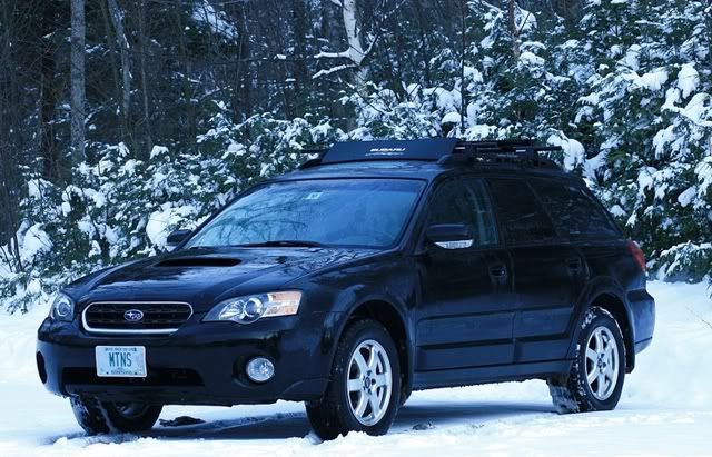

So I took one of my old fairings and carefully cut about 3.5" off both ends using a fine toothed saw (the plastic will crack if you aren't careful). I then filed the top corners so they were rounded, carefully drilled new mounting holes, and repainted it with black spray paint for plastic. The result is a narrower version of the old style fairing that works great and IMO looks good too. No sunroof issues either. I threw on an old Subaru decal I had and voila:
