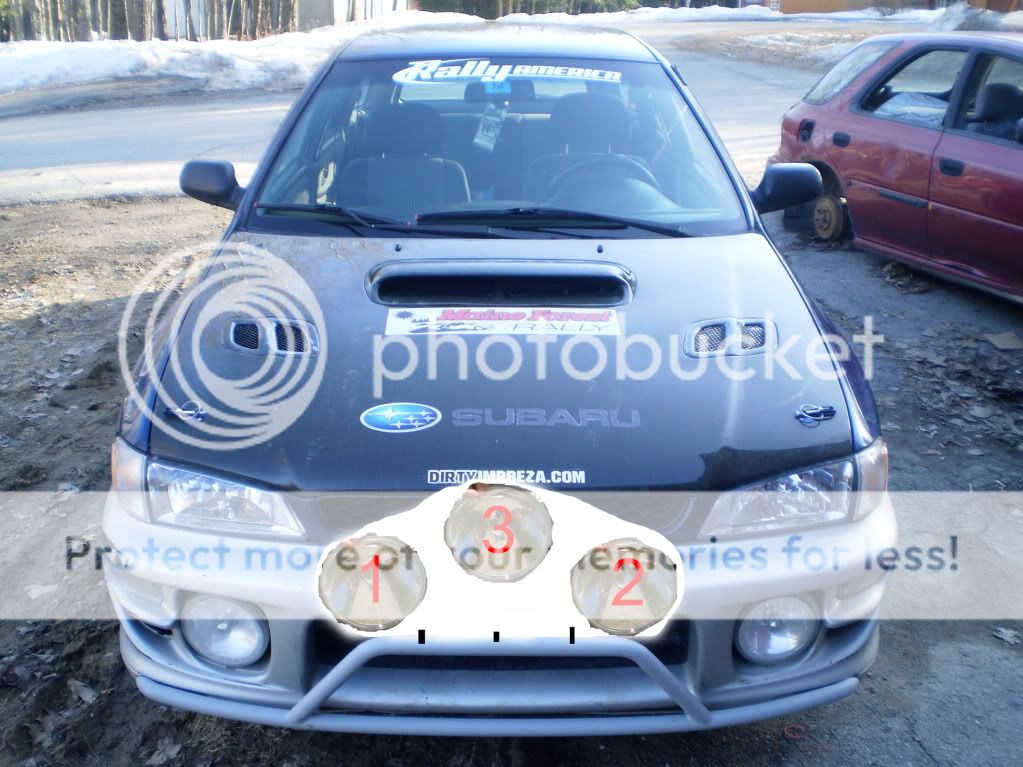

Yeah, not so much anymore.... The idea I have is to use the RI light bar to mount, making an almost EVO looking pod on the front.. Not even using the CF hood.. a rough sketch to come.. I have this master plan in my head... we'll see...

Boone, Inksi, This is the rough sketch I made up its not 100% to scale, but this should give you guys the idea.... Lights 1 and 2 will be angled out a little bit, from the front of the lights to the rear, there is 8 inches of room.. might make Light 3 rather steep.But, Im sure Light 3 can be lower a little bit to make it less of a pitch. The lights themselves are 8.5 inches in diameter. The black marks are anchor points for the front, where the rear I think I can make a brace that uses the radiator shroud or something.. Please, anyone with any ideas feel free to step in.. (paging Nigel, JoMo) heh The reason I'm going with 3 lights is one of my pencils is FUBAR, so no point of making 4 eh? oh BTW, these will most likely be convered to HIDs plus the Fogs will be HIDs.. and most likely be swapped out with another light.. we'll see

key thing with a light pod is to have both the leading and trailing edges of the pod well tied down. otherwise you get rockin rollin and vibration...bad for the fiberglass (not very resistant to repeated flexing) and really bad for quallity of the light thrown down the road.
keep the lite pod attached to hood only (there's good reason that rally cars do it a certain way). if the CF hood is too floppy to hold teh pod, replace that, not cook up a weird half baked pod design that won't work right. there's a whole thread on SS about the hardware to attach pod lites--check that, you'll save a lot of headaches.
as for the odd number of lites, get over losing one, man up and replace it and run a 4-light pod. scca road rally rulEz specify you may NOT run an odd number of auxilary lights. best do your homework NOW not later after working up the design, the mold, and the finished pod.

PS--why are you wanting a pod, rather than bolting lights to your nice lightbar??!!

This is more for my fun runs out in the woods. The reason I'd like to go with a pod is because the lights that I have do not have any back to them.. nothing to protect bulb connections and such.. I was trying to design a way to protect them.. Plus i don't have the assets to just go buy new. Believe me, i'd love to get a set of PIAA 80s for the bar... Or if you can find me a replacement Cibie pencil the same make as these.. I've looked endlessly..
