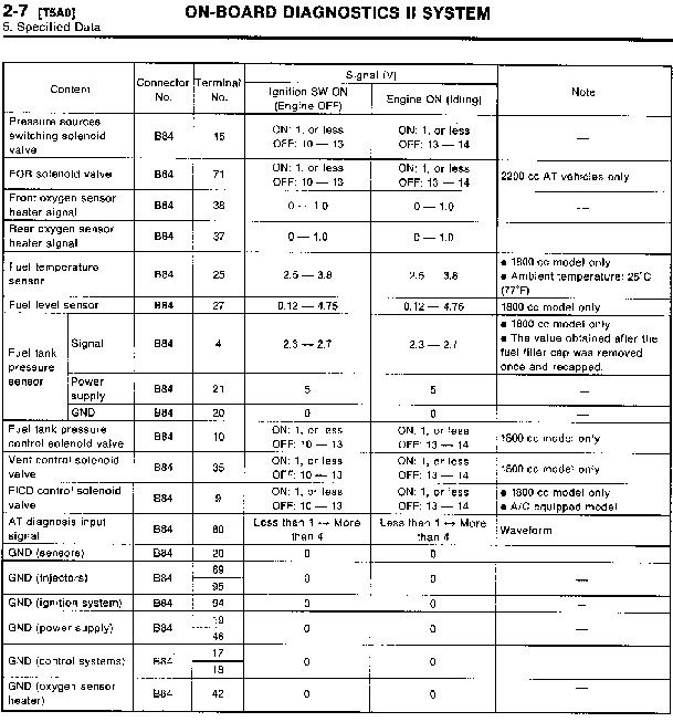

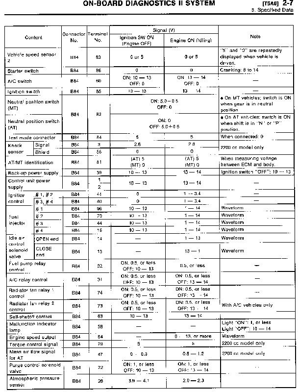

Hmmm. I'm not finding any pictures of the wiring we did, or the dash ripped apart ... but this is what it looked like when done!
EDIT: I just found this, not much but you get the drift. This is the donor car ...

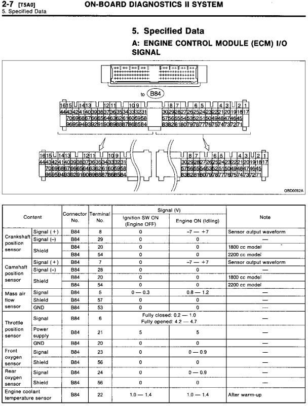

Some diagrams:

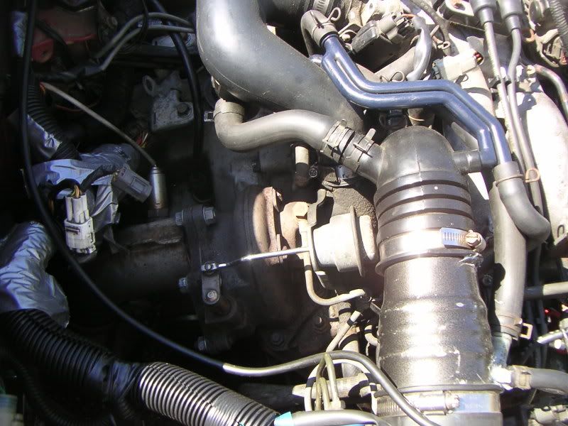

Notice the lack of intercooler and where the hell is that tiny little turbo?!
Oh, there it is! (Don't mind the duct tape, I ran out of electrical tape!)

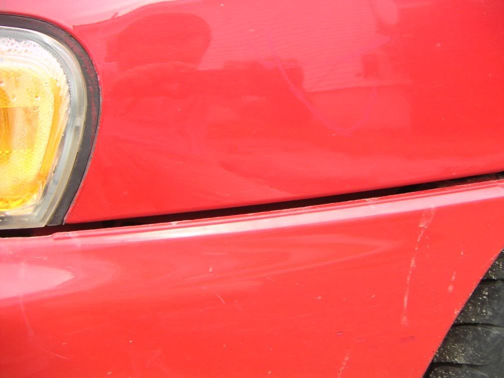

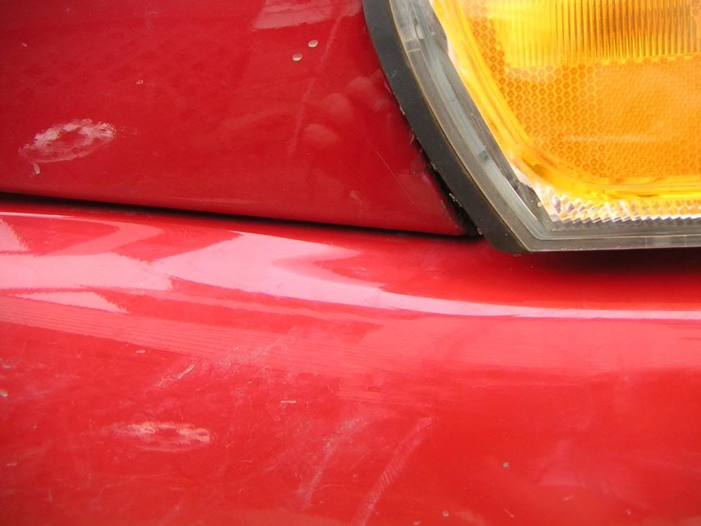

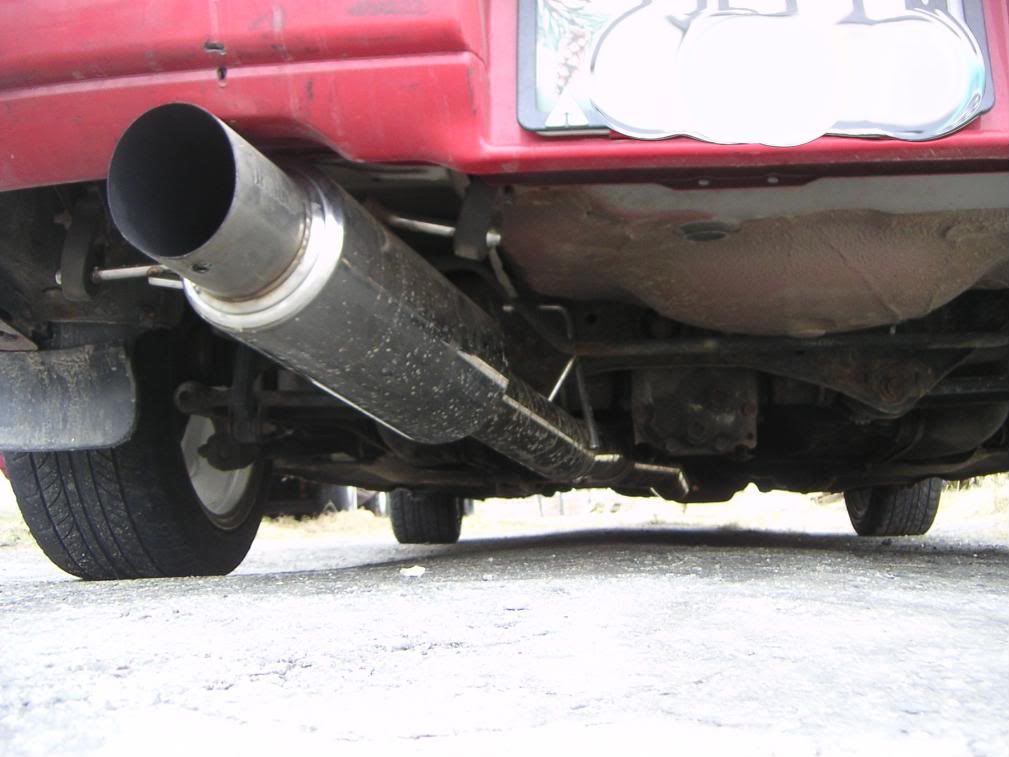

That wheel gap was killing me, so next I purchased a set of Megan Racing coilovers from the Radmeister. It was stiff, but the handling was great. I drove that for a little bit and then picked up an Invidia N1 Raceback exhaust. I LOVE this thing ... After installing the exhaust in my driveway, I went to take it for a little test drive. Backing out of the driveway, I tried to dodge a patch of ice and the passenger side front wheel went off the curb. Normally this wouldn't have been a problem, but don't forget about those coilovers ... the tow hook under the car SLAMMED down onto the curb. When I pulled across the street to see what the hell happened, I was VERY upset to see this:
How it should be:
How it was:
Oh yeah, here's the Invidia:
