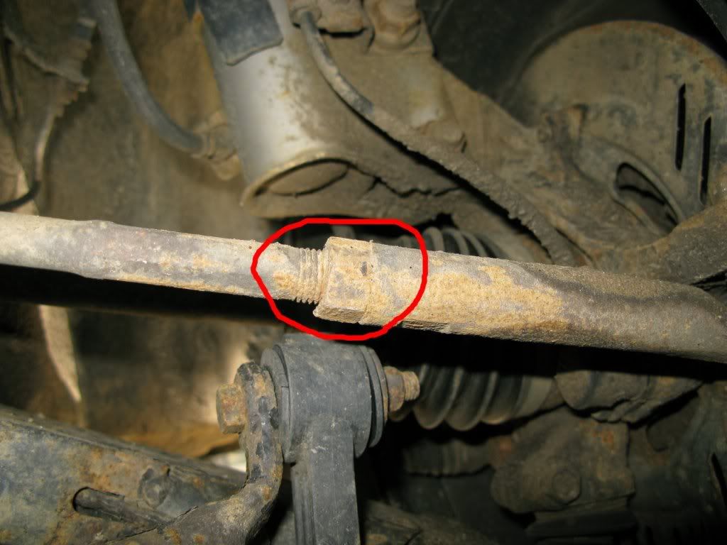

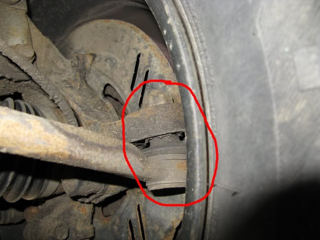

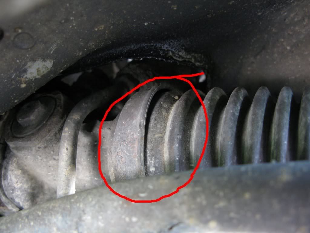

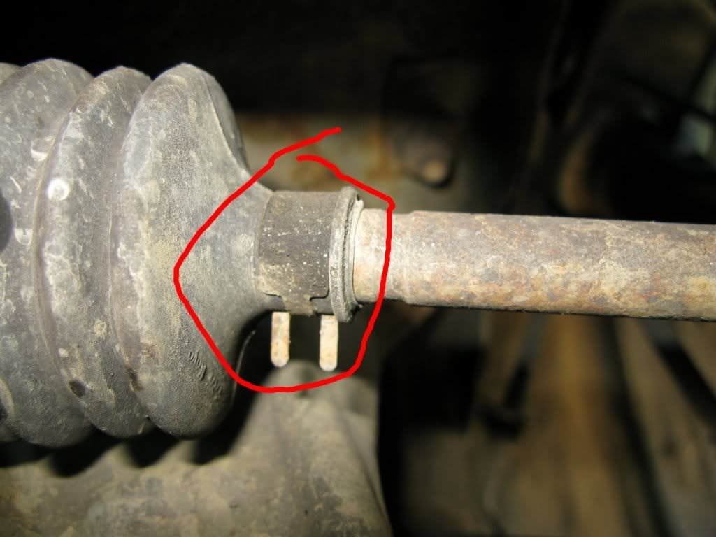

Anyway, I had some time this morning to jack up my car and take a better look... It looks easy enough to fix, but I took some pics to confirm what I think is right, and to help with a question...
First disconnect it here
then disconnect it here
this end of the boot is pretty obvious to get off..
How the heck does one disconnect this end? there wasn't any obvious way (to me...)
Am I missing anything? Or is it really that easy?

if your just replacing the steering rack boot the one end is clamped as you can see the other end should just pull off it slips up over a ridge so there is no need for a clamp on that end and there is no grease that goes in there you might find a little power steering fluid in there but you don't need to put anything in there just replace the boot.but ya it is a fairly simple job so have at it and get'er done
no need to pull the tie rod off steering knuckle, just unbolt the rod-end from that, and small end of boot just slides right off
when you reinstall fresh boot, you may want some sort of fastener to hold big end of boot over end of steering rack--good qual ziptie or metal banding
make sure to double-check inner tie rod end play (jack front wheels, wiggle wheels back n forth like steering, feel for play at inner joint), and replace that if needed while you've got things tore up

So if I follow you right, you are saying I don't have to do the first picture. Just start at the second?

So it stopped raining today, AND I have time. So I guess I'll get to fixing this. I'm looking at the manual for torque specs. How the heck do you get the correct torque (61.5 +/- 3.6 ft-lb) on the rod end bolt? There isn't any way to get a socket on it.

as for torque for rod end boltZ, pull em up tight against tie rod body and each other, ooff oof grunt grunt is about right. one nut snugs up against body of outer tie rod, the other is a locknut OK?
you are messing with Very Important Hardware down there, if yo are so unsure about all this stuff mebbe it's time to call in professional help.
