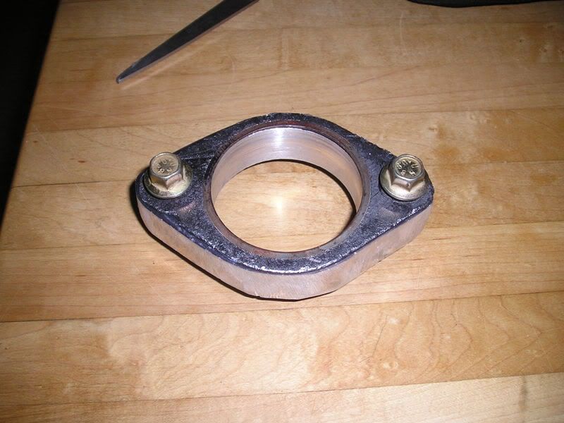

Yup just a bolt on for the Turbo guys from the cat back. You will just need 2 Kartboy XL Hangers. The hanger just behind the muffler does not line up but it holds togehter just fine most guys just leave it out. If ya got a welder it is real easy the make it work. For us N/A Foresters in which the mid pipe does not work. I just used the axleback and the XL hangers. This weekend I'm going to add a spacer at the flange to make it stick out a little more. Just something I made at work. But I'm having NO problems the way it is now. With the Catback from the STI on your XT it will be about 2 inches further out than the picture below. Which is PERFECT.
