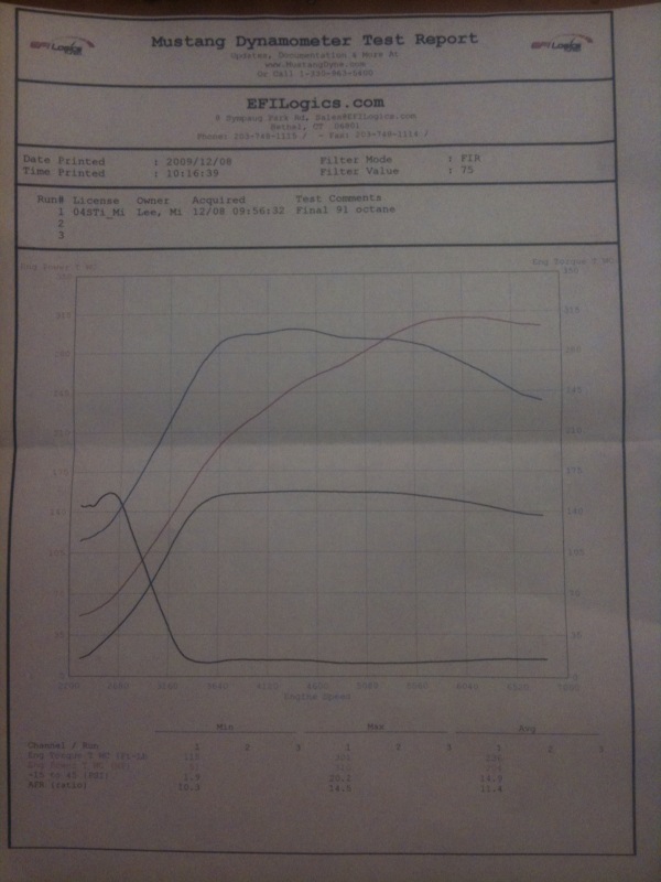

Long time, no post. Lots of goings on with my sti over the last few months. longblock exploded, brought it down to EFI. yada yada yada, picked it up today.
Supertech pistons, valves & springs, kelford 264 cams, dw 740 cc injectors, perrin tmic, blouch td06-20g, act clutch, K&N intake, tbe, grimmspeed bcs
310 whp at 6k, 301 wtq at 4300 mustang dyno
19.5 psi , hits peak boost about 3600. holds the power to redline
the power from 5k-7k is a huge upgrade from stock turbo and cams
conservative tune @ 91 octane, chris said about 30whp left on the table because of the gas.. (meth would help that nicely

very nice. that turbo is a really good one too. i'd love to drive that setup i'm sure it pulls hard and often
Yea I'm very happy with the 20g. It seems like lots of people overlook it for something bigger. I think it will work out well for street with some cone killing too.
I have a 20g on mine and love the quickness it pulls. I am surprised you didn't pull higher numbers? I have the same injectors and turbo. But, I have no motor work done at all. I pulled 330 whp and 330 wtq on Chris's dyno also. My boost is at 23 psi though.
I have the 3 inch inlet with the 8cm hotside. Headers and uppipe. with couple other things also.
How much was you motor work there at EFI? Would love to get pistons and connecting rods.
I dunno, what are your other mods? Did chris tune it? Like I said it's a pretty conservative tune on 91 octane.
