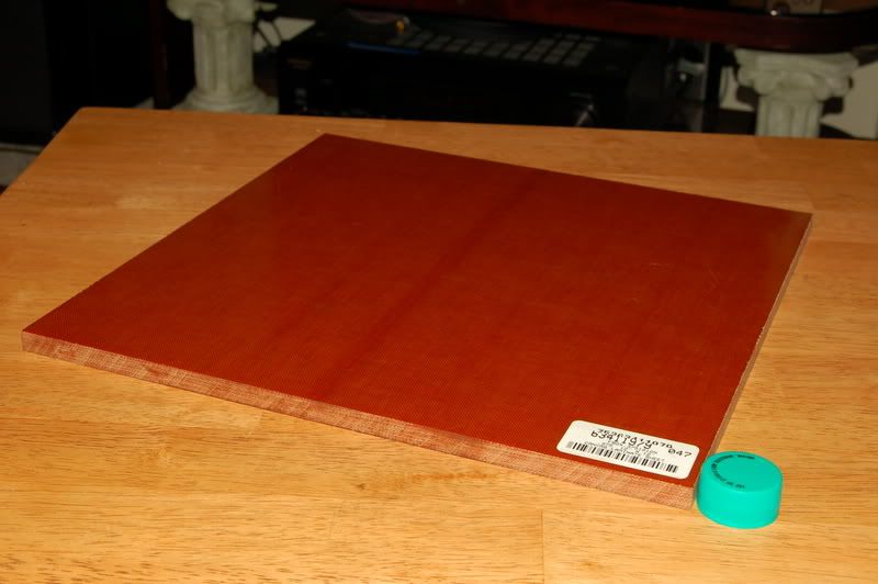

there are different levels of phenolic, make sure when shopping you're getting a good thickness (thicker the better) and the grade is good.
grade XX phenolic is paper layered and is raisin, really
grade CE is better, usually canvas layered and is kind of a middle ground for price
grade LE is like CE, but cloth instead of canvas
grade G7 is the best. its an awesome heat blocker and is what the pros use. now if it were $150 per square foot we could use it.
the grimmspeed spacers are grade CE.
____________________________________________________________
seth, although they would be easy to make, i dont think a mill would be the way to do it. laser cut is the way. you'd have some crazy chatter to deal with trying to mill something that thin all the way through while still holding it from the edge.
as for N/A vs. FI uses, both would benefit, but i still think FI would benefit more since turbo motors heat the intake though heat transfer as well as pressurized air being hotter (ideal gas law). yes water injection would help a lot more than a spacer, but water injection would also help an N/A car a lot more than the spacer as well. plus phenolic spacers never need to be refilled!
i can say that i'll let turbo motor cool to the point where the radiator, overflow tank and even turbo are room temp, the intake mani it still hot as hell.
if i could get the intake mani to cool as quick as the radiator i'd be happy.
mine should be done next week.
3/8ths of an inch CE, or about 10mm.
i'll probably be using it for a throttle body adapter as well, but in the 1/2" to 3/4" variety.
