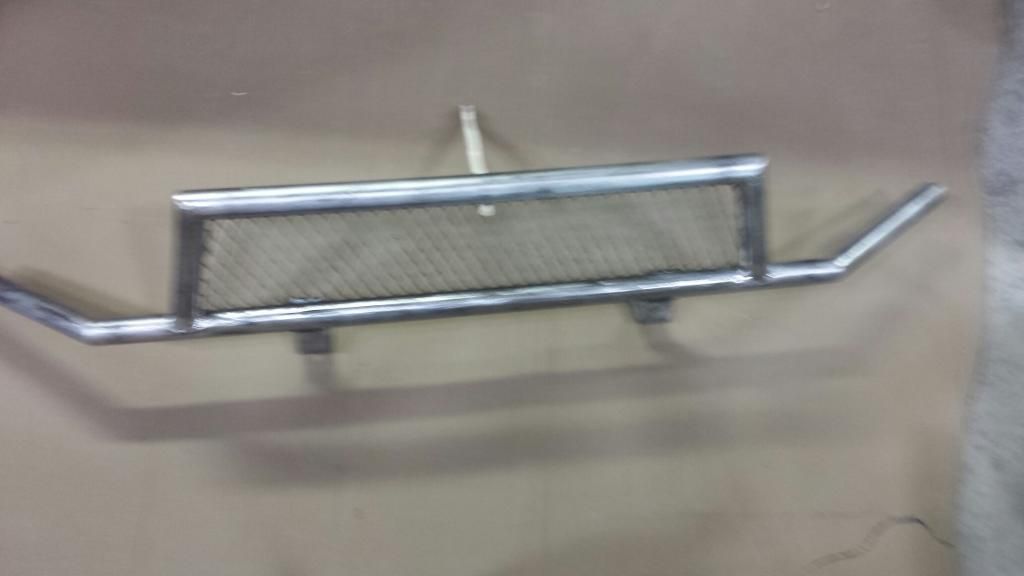

A few months back I figured the TS needed a brush guard so I made this up but haven't posted any pictures and decided now was a good time.

I used heavy steel for the brackets and black iron 2 inch steel tube for the actual guard.

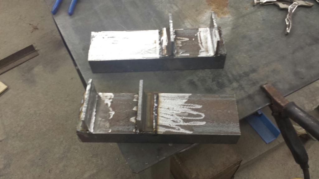

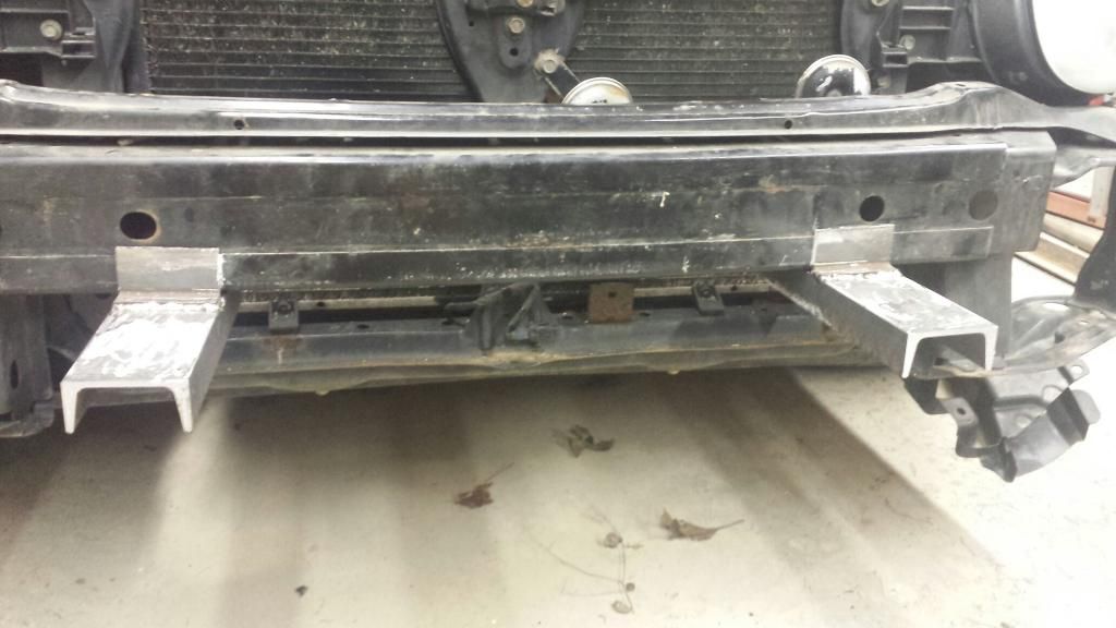

These two brackets fit around the front bumper bar and support the brush guard from the bottom
Drilled holes for bolts

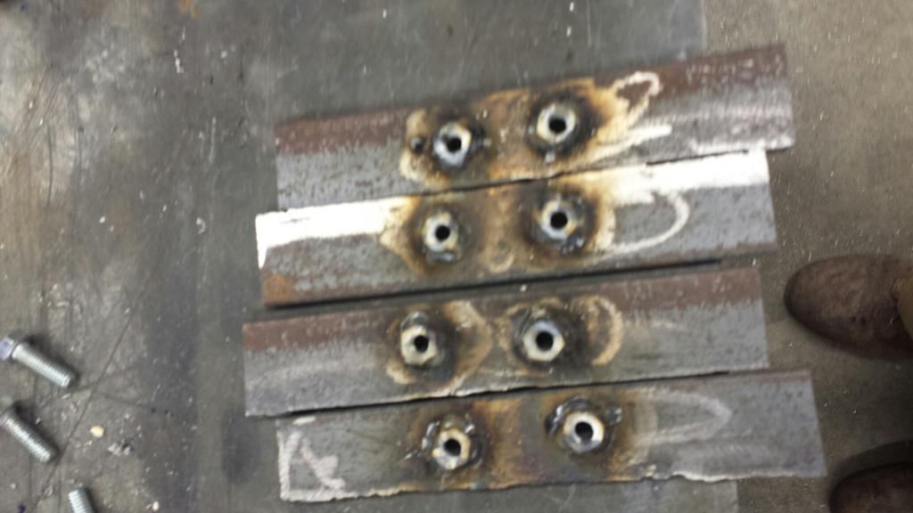

Backing plates that I fed through the bumper bar to bolt the above brackets into, with nuts welded on.  Acting as a big washer.

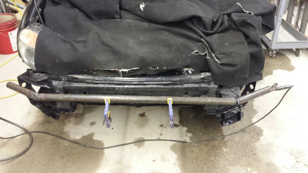

Mocking up the correct shape for the push bar.

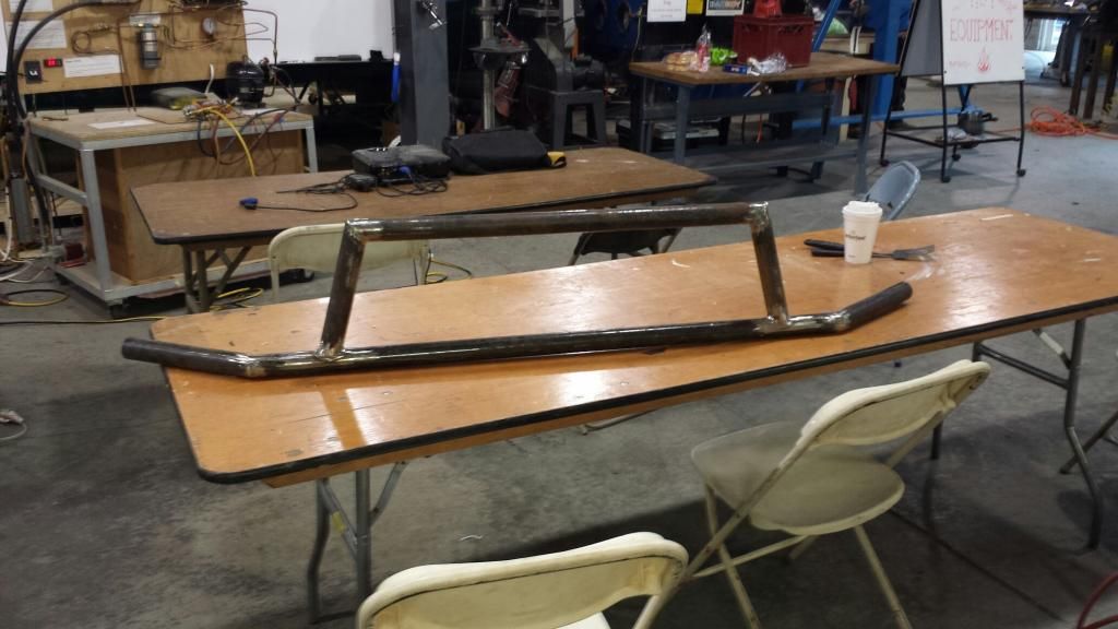

More fabrication

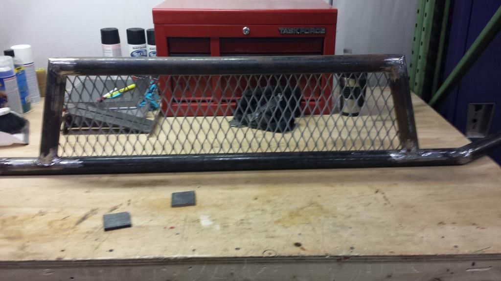

Added mesh to protect the hellas.

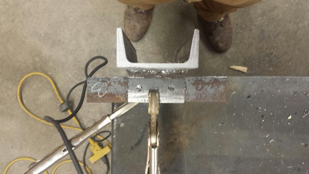

90 degree brackets welded onto the guard to attach to the bumper brackets

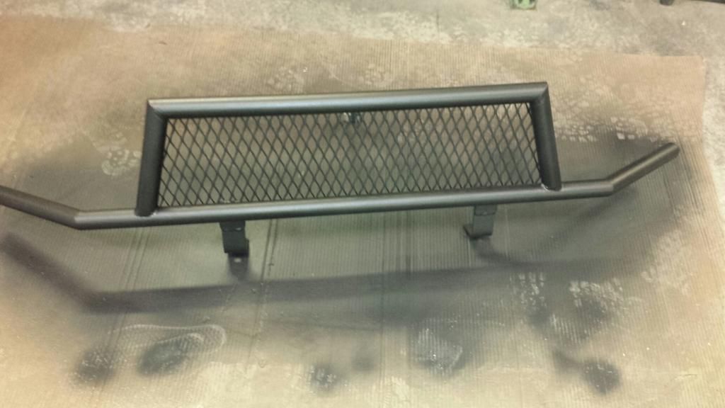

All ready for paint
Painted.  I used a textured truck bed liner spray hoping that it would be sufficient.
All mounted up.  Here you can see the brackets attached to the bumper frame.  I had to cut away a small bit of plastic to be able to get the bolts through.  The brush guard is probably overkill and is quite heavy.  It does however go through chain link fences which puts a smile on my face.  In hindsight or for anyone making their own guard, I would have gone with smaller tubing (2 inch is way more than enough).  Also I would have spent a little more time in the design simply because there is a lot of reflection from the hellas now that I had originally not taken into account.  All in all I am very happy with this mod. Definitely very functional
A good photo of how the brackets are mounted
