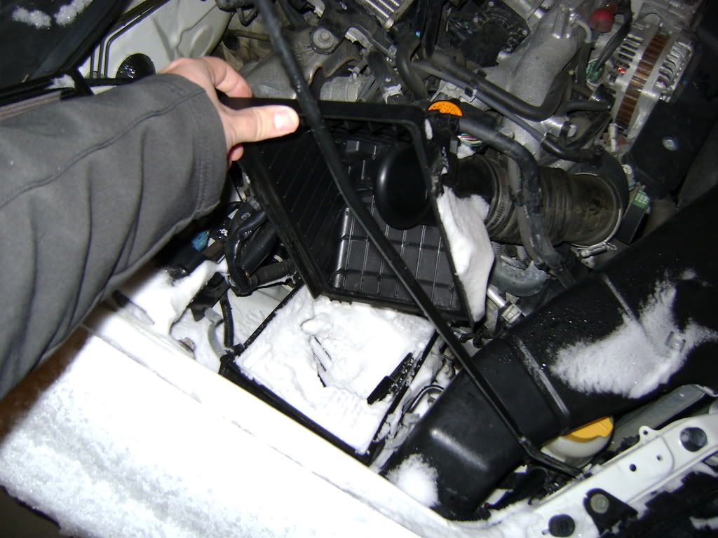

If your car is running weird or skipping and it is snowing,
CHECK YOUR AIRBOX!!
I just about died when I opened it up and it was FULL of snow!

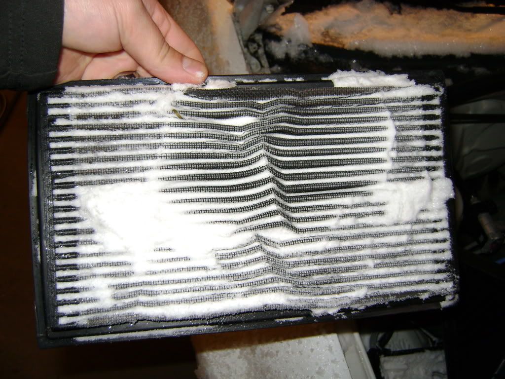

I was curious to see how much there was in the snorkus... but the air box was FULL and the filter was pretty packed too.

nah.. the snorkle had remnants of the snow in it as well.. that is the only reason I thought to look in the airbox.

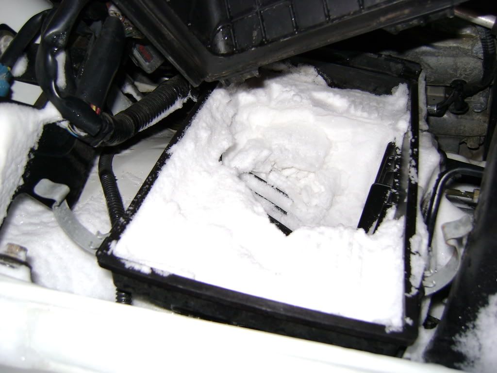

Ok.. I know none of you believed me the first time.
it happened again in the big storm on the 31st.
teh proofz:
Holy crap!
I'd be double checking the fender liners, put panty hose over the snorckle, or removing it for snow storms. Maybe tape up the hood crack where the air gets drawn. that's got to be murder on the MAF
fortunately there is no moisture or snow past the filter. it just clogs up.
granted this only seems to happen when it is in the teens or less and snowing. I think it is just too damn fluffy and gets sucked in.
Fender liners are all together, this is all coming in through the snork. I have been thinking of replacing the bolts with a pair of aluminum Dzus fasteners just for this reason.
