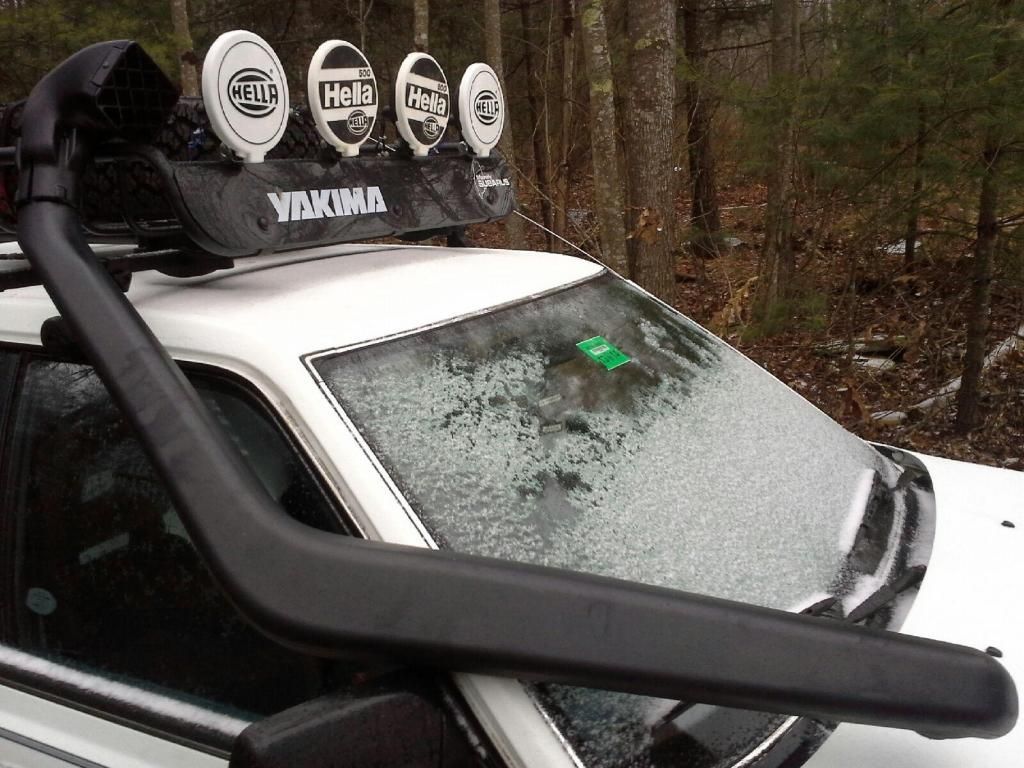

Got the plugs and PCV valve so far. Also got the other mod that I have planned. Snorkel kit is here! Probably will be a while before it goes on, but I have it. I'll get a pic at some point.

This is the snorkel I bought, obviously not in it's actual place lol

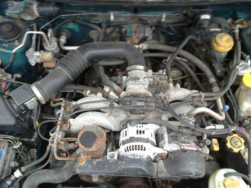

This is the EJ22 donor motor!

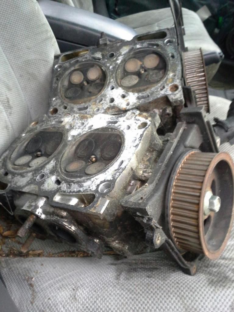

And these are the dual exhaust port heads I hope to use
Your 'car' is LOVING sick Jason, I may have to copy you with that snorkel!
Haha thanks Rick. It's getting there. Still quite a bit of work to do!

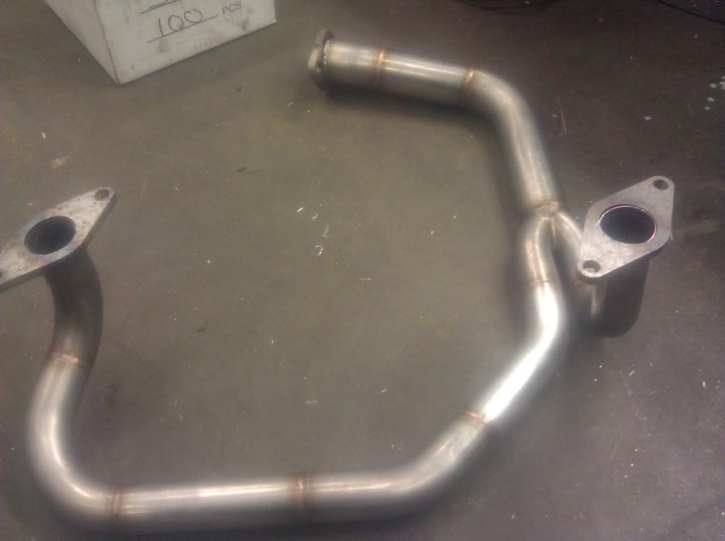

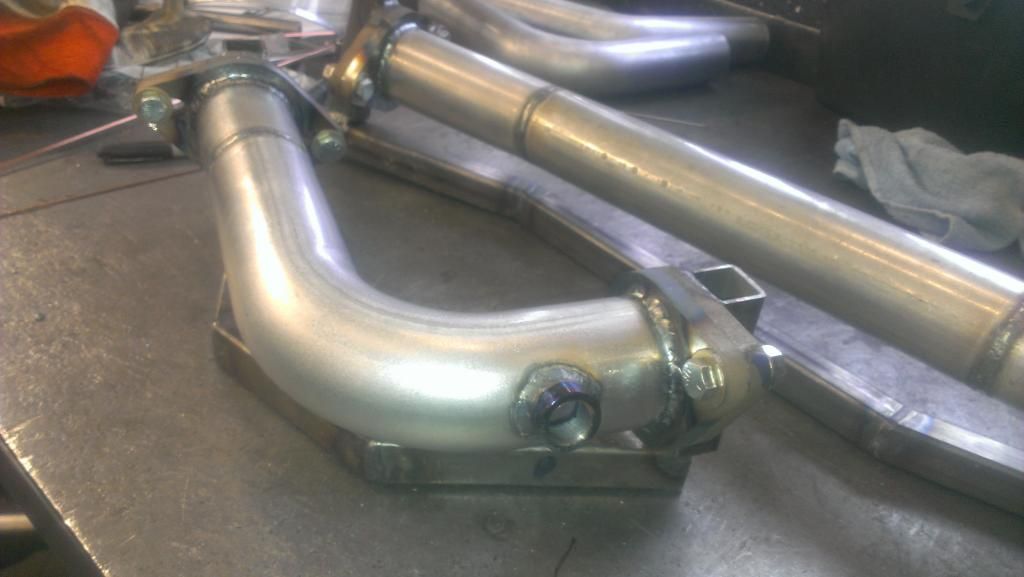

Just ordered a header for the new EJ motor too!
Obviously I won't be using the dual port heads.
Also bought this small piece too. This bolts right to the header pipe, and then I'll have to make, or have someone make the rest of the exhaust.

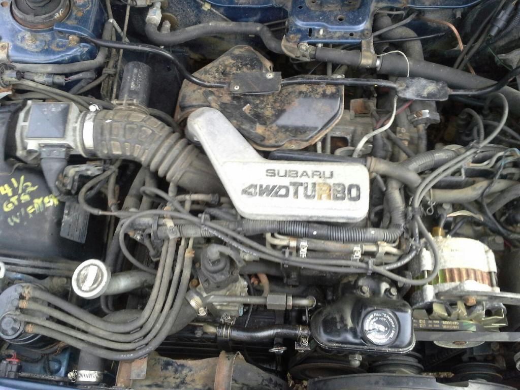

The EA82T in the parts car. Ran great when I went to buy the car, then stalled and wouldn't restart while trying to load it on the trailer yesterday. I'm almost thinking it broke one of the timing belts. I'll be using the air box to fit the EJ22 into the Loyale.

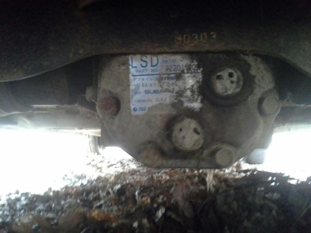

And this is eventually getting pulled out, the LSD chunk will be pulled out, have a 3.90 ring gear bolted to it, and then will be stuffed into a 3.90 diff housing after a little grinding for fitment on the housing. After building one before, I can't wait to have one in this car. Makes a lot of difference.
Got the header tonight, so now I have everything for the motor. The redrilled flywheel and adapter should be here fairly soon as well. I still need to pull the EJ22 and the harness so I can send the harness out. Really hoping that happens this coming week.
