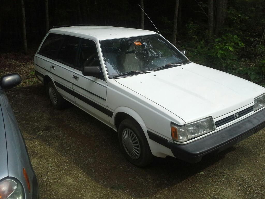

I'm loving this project though, those swampers will look badass on the wagon.
I already spilled the beans as to what it was either in this thread or the new car thread. But everything from that will be going on this......and some. And yeah I can't wait to have swampers on this thing lol.

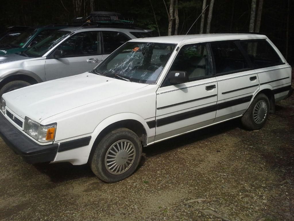

New painted fenders are on. Went on pretty good, but the front valance was a little rusty too, so I removed it, and will be neatly trimming the front fenders as I have on my other old Subarus. Gets rid of rust, and increases approach angle.

Leone is just the name for the Loyale in other countries. They did have different options than what the Loyales got, but they are pretty much the same!
I mentioned the Leone as being one of the more influential early Subaru's in a class project once. Let's see some Leone pics J
