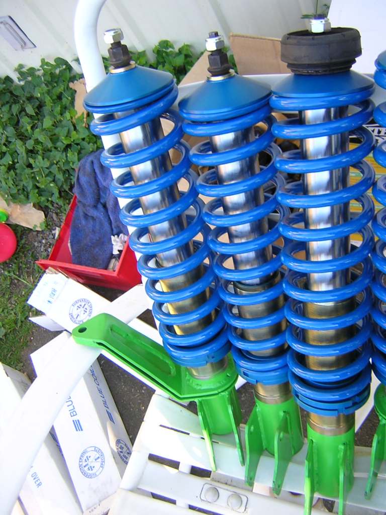

I don't have Johns setup on mine. Just Bilstein HD inserts.
I'll try to find a picture, I know there's one out there.
EDIT: That didn't take long...hahaha.

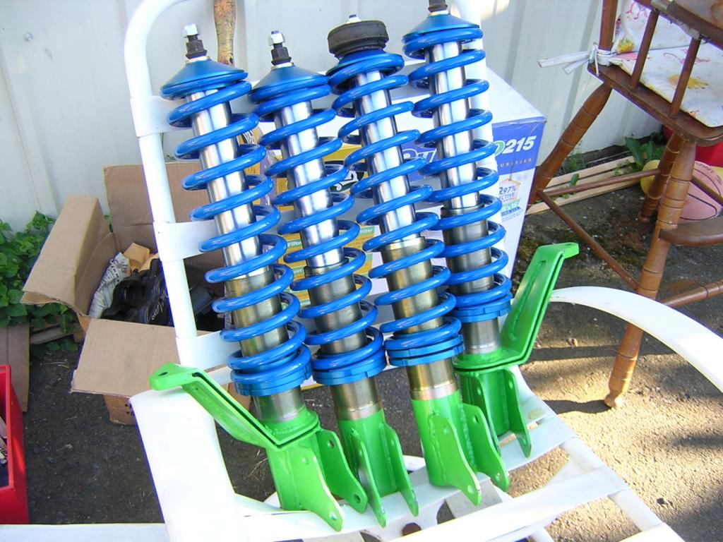

god i want those they look like sex, but the whole setup would run out of my price range, for a non stage rally car
They're not the same gravel struts as John uses, little smalller. The inserts are inverted struts though.
A grand for that setup isn't too bad considering what you were looking at. 2bennett's setup was more, and Koni's with a ground control setup would be more as well.

John's setup is all one piece. The coilover threads are attached to the shock body. The control arm brackets and steering arms are welded onto the shock body.
It comes as pictured there.
There's a bit of lead time with his setup as he has to fab them up himself.
Hell...if I can get ahead of even a blown 50mm gravel strut (they're rebuildable anyway), I would pull one of my stock strut housings out and take some measurements and fab one up myself to see how tough they would be to do.
