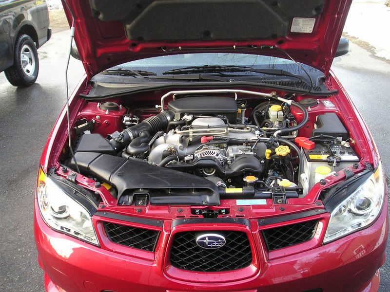

On your 07 if it is a non PZEV. I had an 07. In my honest opinion the best bang for the buck is a Good axleback. Prodrive or even a STI. Your stock diameter piping is more than big enough. Pre 06 it was a bit smaller. Also get yourself a WRX snokus and resonator for your airbox. It will fit great and will bring you much cooler air than the one you have stock. With this setup I had to keep the factory panel filter in because it would stumble just barley at 6k rpm's. As the stock tune could not keep up. you WILL loose some low end torque but gain some on the top end. On my 08 Pzev Forester the best setup is the stock one because as much as I like the sound there is a big lose in low end. I would rather have the low end and smooth pull to 5,500 rpm. These are just my opinions. And sounding faster and our butt dynos are not always true as if you were to use a stop watch. Below is a pic with the wrx snorkus on my 07 wagon.
I have a custon short ram, and wrx snorkel^^^^^^ and I ended up with the rallitex inner fender silencer delete, which is supossed to feed more air faster, but looks like it just makes it easier for debris to get lodged in the filter. and my axleback is stock wrx piping with ultraflow. flows like can but wayyyy quieter. I'm pretty happy with the sound now, and don't want to sacrifice it if the gains won't be well worth it
