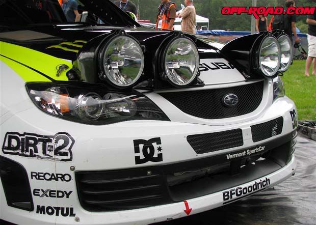

so im bringing the carbon fiber thread back from the grave cuz i was wondering how hard it would be 2 make CF light pod kits. 2 pods, each with 2 lights like this
Since your not trying to save weight fiberglass would be a better application for Light pods. That wouldn't be that had you'd just have to make each side individual since they're different. If I was still at my old high school I'd totally make a set for u man
