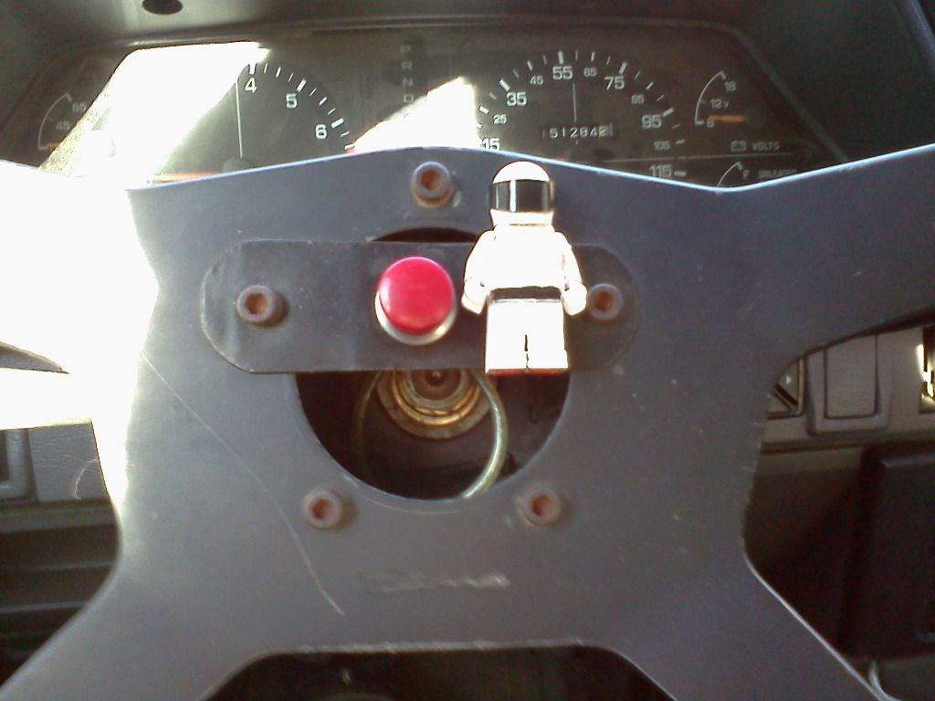

Some say he used to be a Lego pirate, and that now he's been painted white... All we know is HE'S THE STIG.
