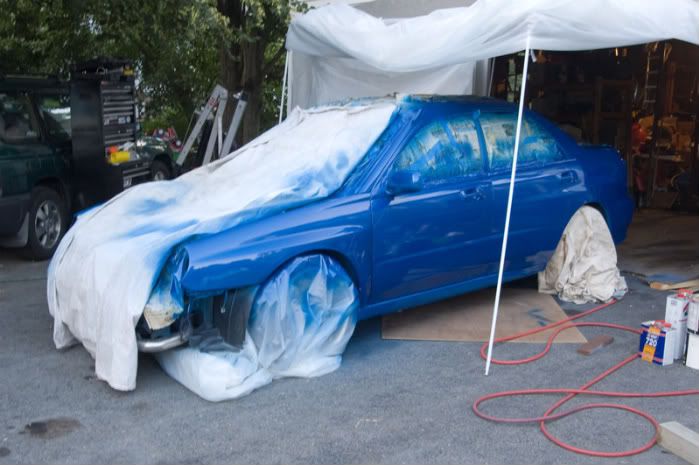

Seriously though - awesome stuff. I didn't know you had the equipment to take care of that. How'd it turn out? Any issues? It was kinda windy down here - any there? Looks good from this distance.
i just put painters plastic up all over the inside of the garage although with the motorcycles in there i couldn't fit the whole car, hence the pop-up w/ more plastic. there are fans at the far end for a draft and i left the bottom of the opposite end open. i needed to roll it out that far to do the clearcoat though, its harder to spray that without really good light. i'll obviously be posting more shots when its done. :occasion14:
the air compressor i bought was picked out so that it'd have enough gusto to paint with. it does it with ease (only runs about 1/4 the time). 25gal oiled twin cylinder craftsman professional. the gun is a cheaper gun, does the job though just as long as its set right. paint is BASF limco with a german clearcoat. i forget what the primer was.
