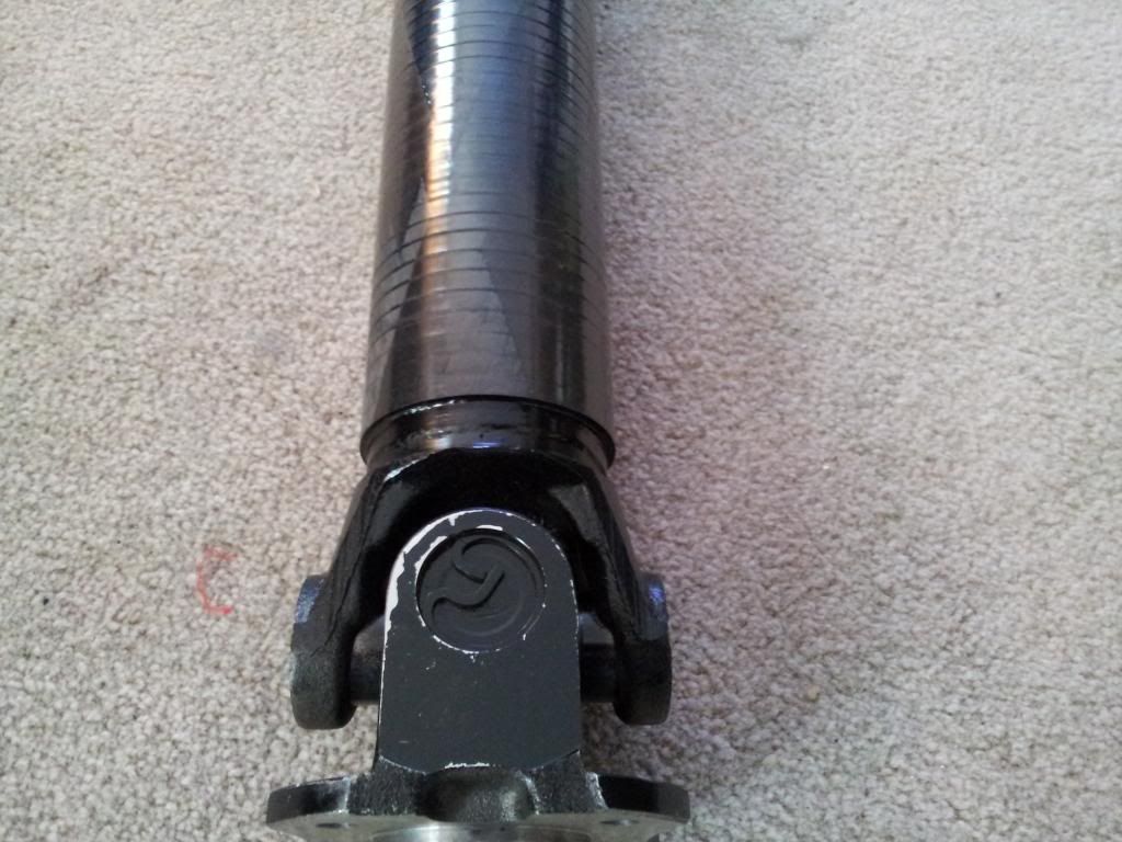

The drive shaft just came in. It is beautiful. Too bad no-one will see it once it's installed. Everything looks to be of high quality, it definitely feels heavier than I expected, but I put it on the scale and it is 14.6 LBS on the nose. Here's a few pics, I'll post before and after acceleration vids doing a roll on in 2nd or 3rd once I get around to doing the install.
