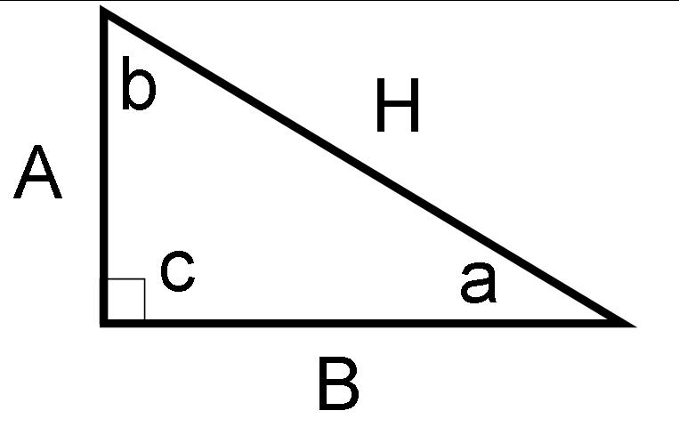

somebody please explain to the stupid chick why you need an alignment when lowering. was I supposed to when I raised mine? :help:
Most likely, yes.
You need an alignment when you do anything to your struts/shocks because you can't ever be sure you put them back at the exact same camber you had before.
Moreover, raising and lowering a car will change the caster, which also affects how the car corners.
As for toe... I don't know. :headscratch:
B = control arm
H = strut spring
A = ride height
When you alter A and H by decreasing (or increasing) the length of H, you change the values of a and b. In car terms this equates in changes to camber. As mentioned, the toe will also be changed (not 100% clear on the mechanics here but it absolutely happens).
