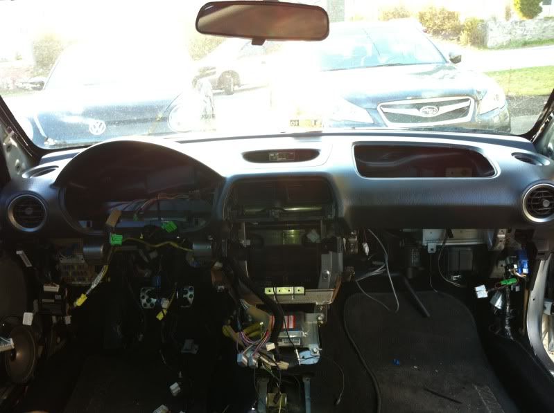

Got another wagon!!!

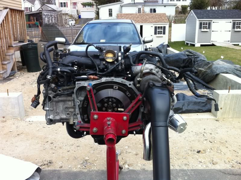

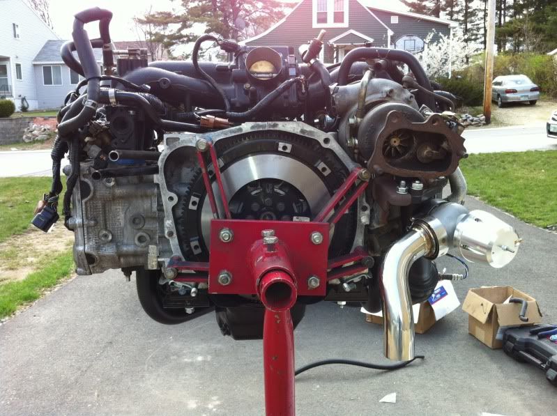

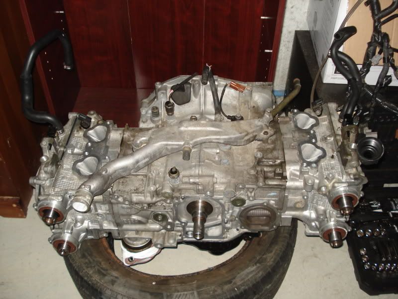

Well thanks to Chris' (Apkarian100) help, finally started to get my motor back together!
Here is some pics of the progress. Ill take more as we go.
As you can see, we set up a pretty sweet engine stand/work bench in my basement haha

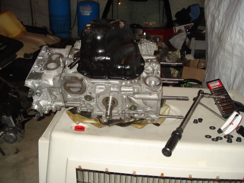

Some more pics of the progress. Got a little carried away with taking pics of the EJ25 stamp haha
Whats slowing us down is looking up all the torque specs and having to dig through all the bolts that Lobstah had thrown into containers from when he moved...

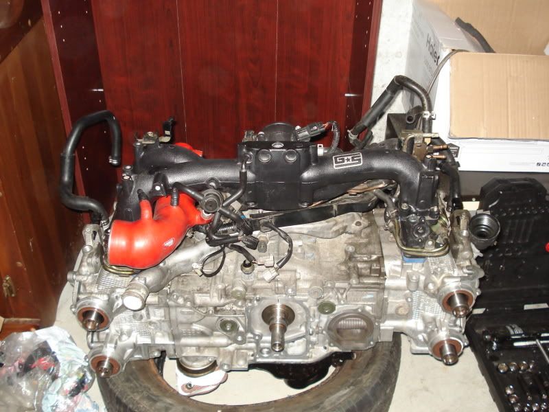

KS Tech 9.5mm Phenolic Spacers
Grimmspeed Ported, Polished, and Coated Intake Mani, Throttle Body, and TGV's

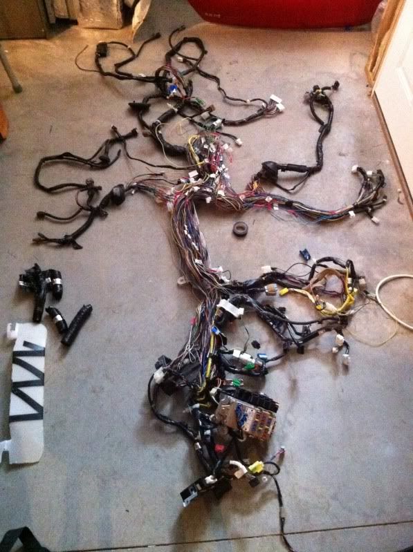

About an hour and a half and 3 rolls of tape later!
And now partially in the car!

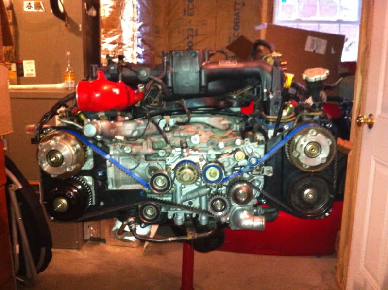

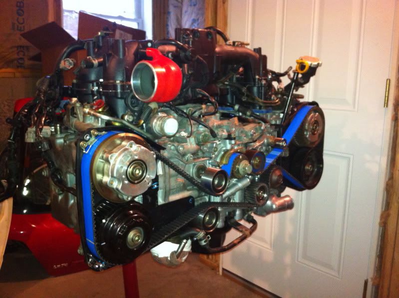

Today is the First time the motor had actually been on a stand the entire build haha
Timing is done, clutch and exhaust is next, then dropping it in!

I'm glad you were able to finish the wiring without me! It's sad though, I think I've spent more time on your car in the last year than I've spent trying to get my own running!
