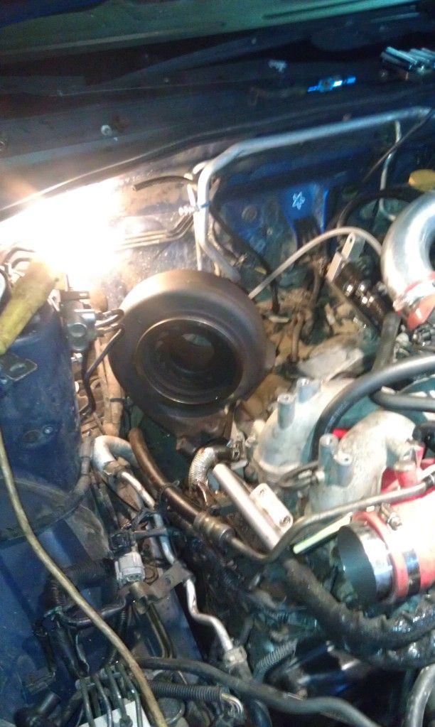

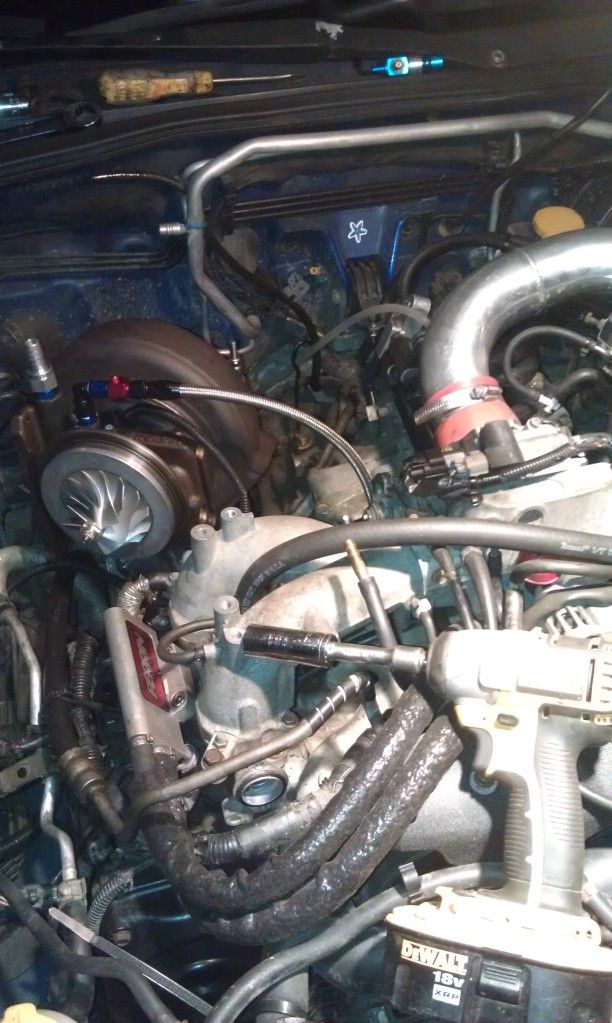

Teaser pic of turbo sitting in the corner of the engine bay. Im hoping to begin installation and fabriction by mid may, and completion by june.

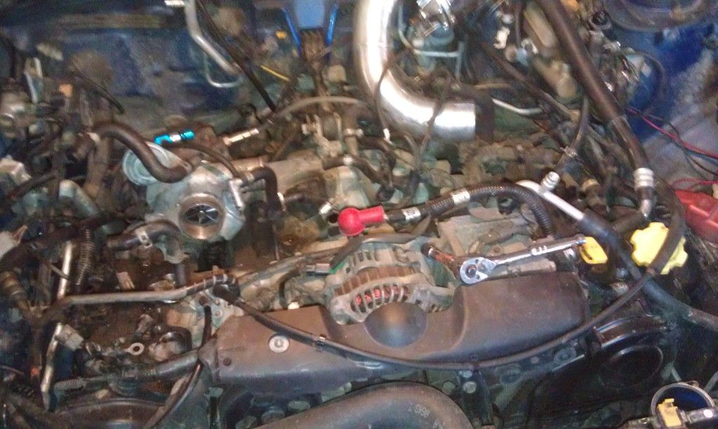

Updates/ pics to come, holset is in the car, need to finish some lil.things and get it tuned, hoping to have it on the road soon, these last two.weeks without it have sucked.

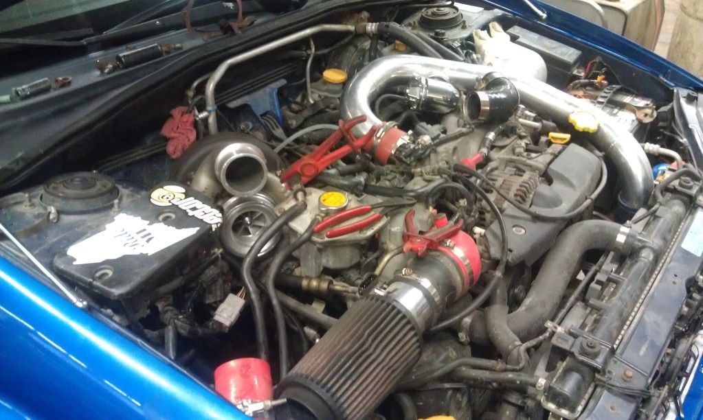

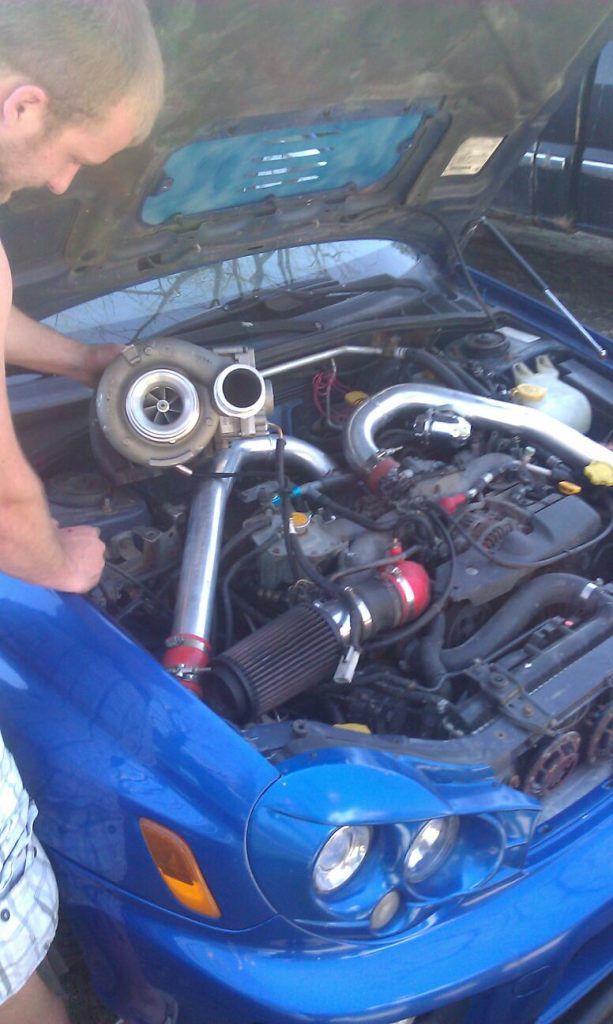

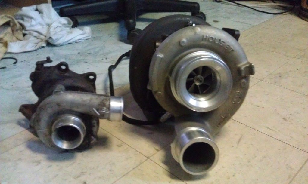

td04 vs the holset

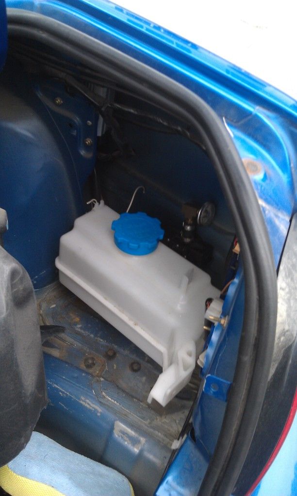

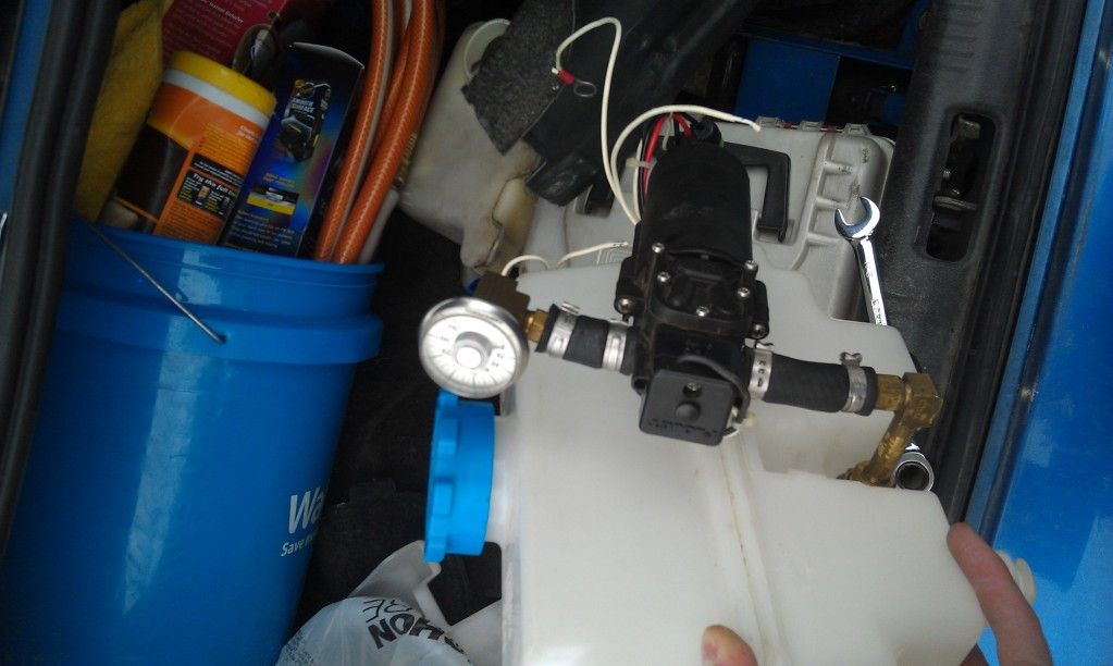

meth setup
needed somethin stronger..

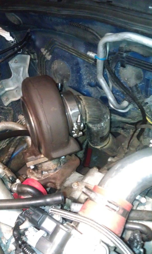

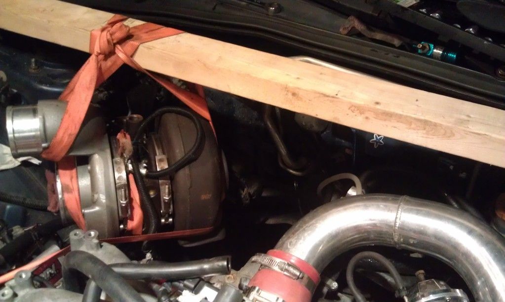

test fit

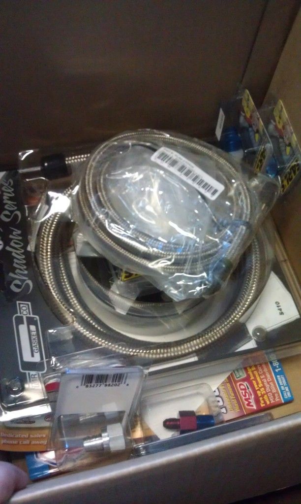

goodies

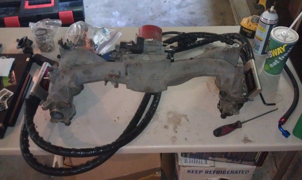

prep for rails
anddd actually goin for it

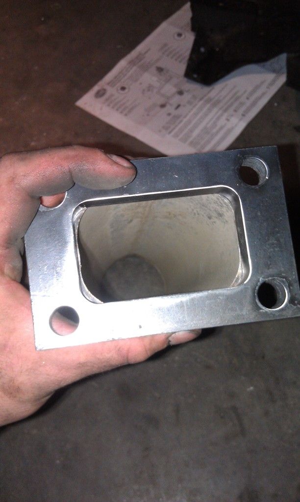

goin from round..
to not..

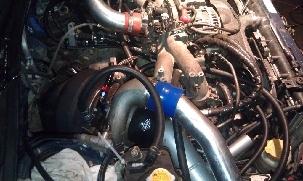

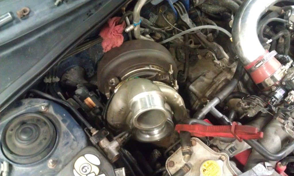

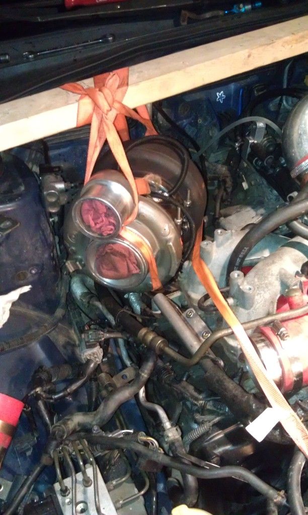

hot side sitting in there

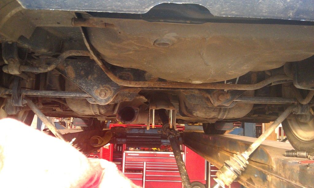

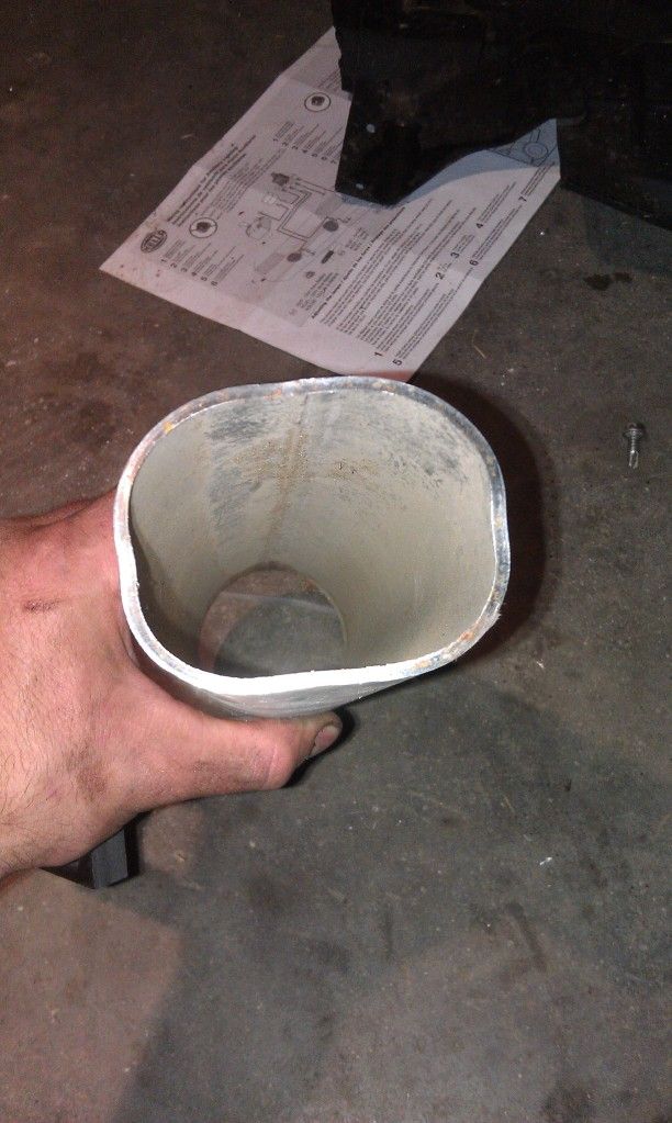

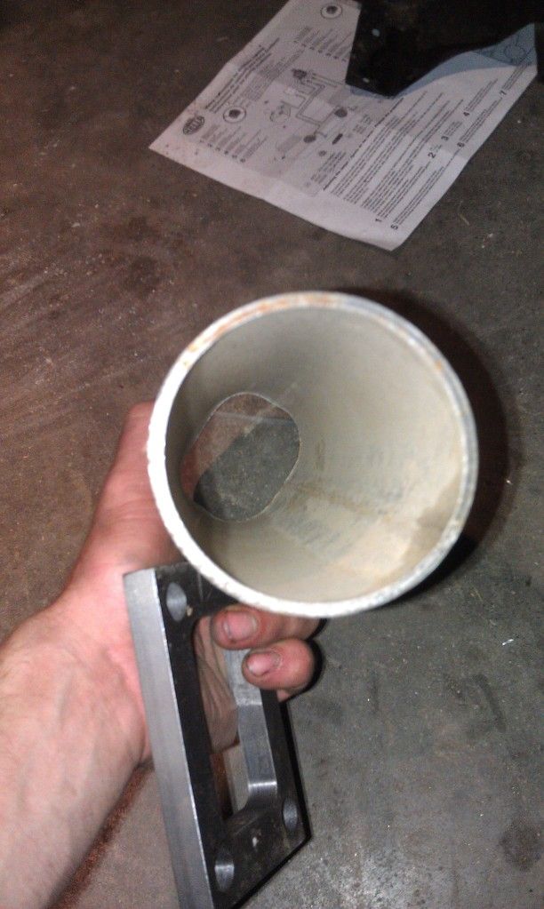

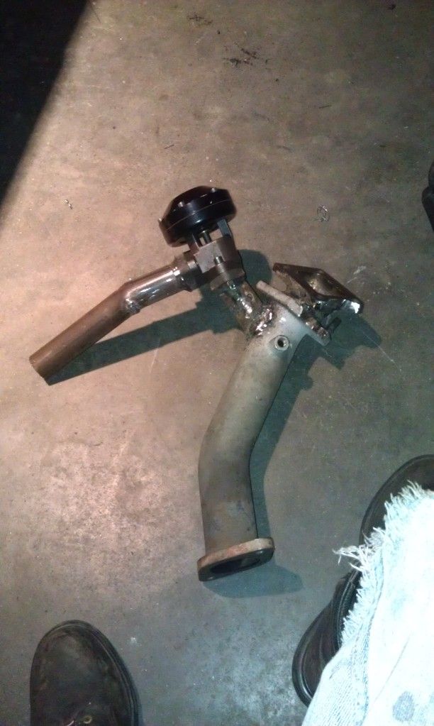

down pipe fabbed

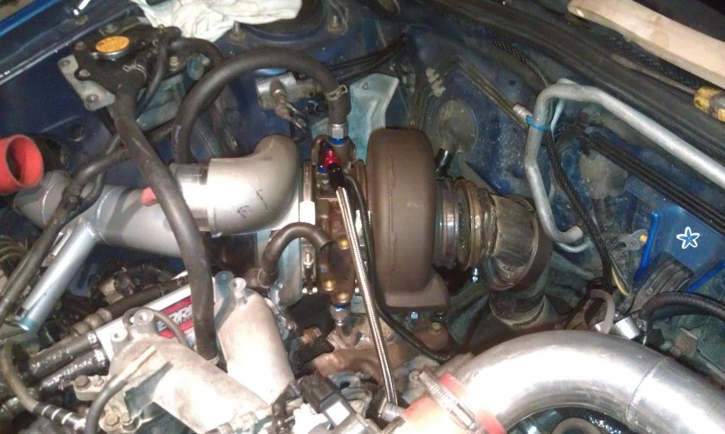

workin out some oiling lines
ewg

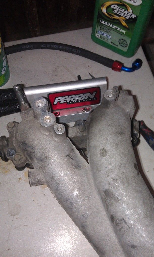

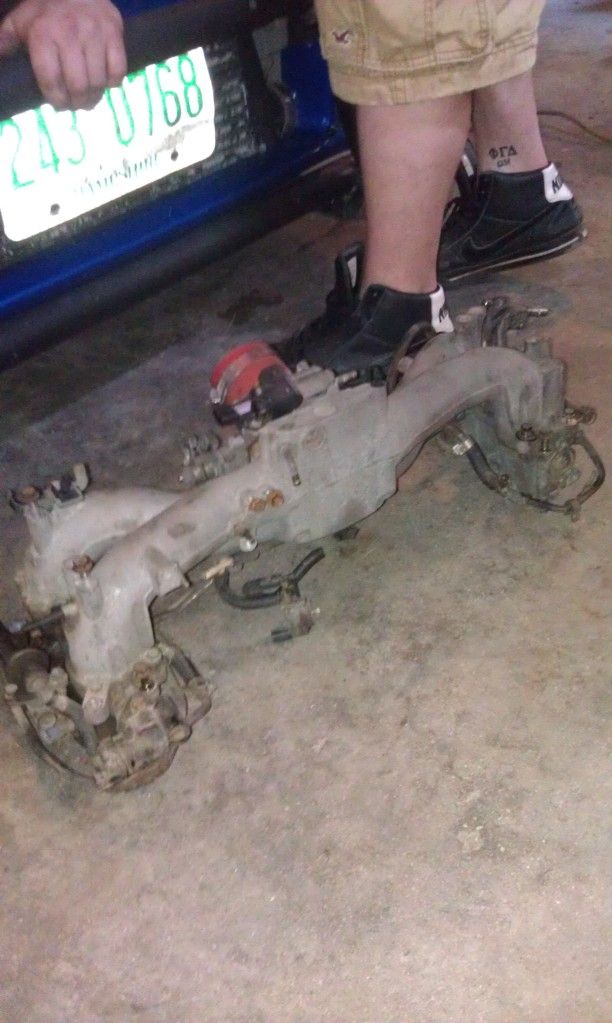

intake

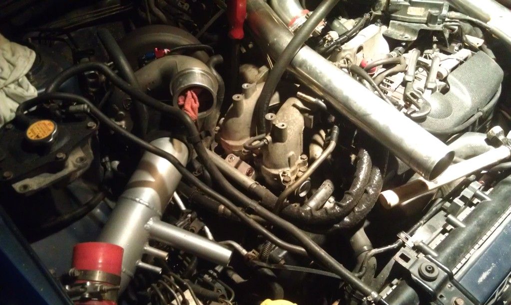

as it currently sits...
