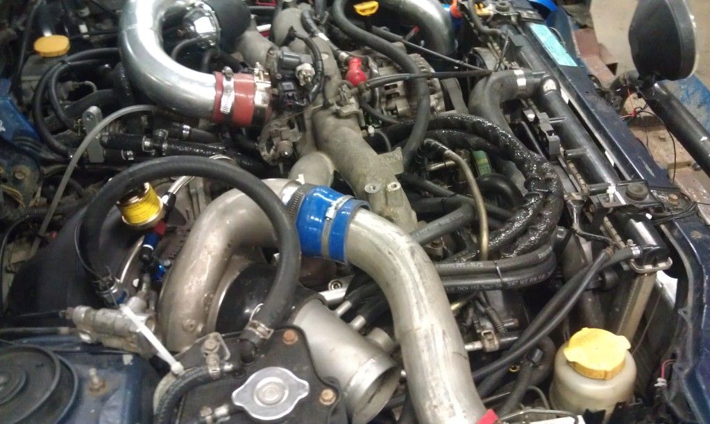

holset he351ve bugeye
holy bawls, that's awesome.
Puttin' that TD04 to shame

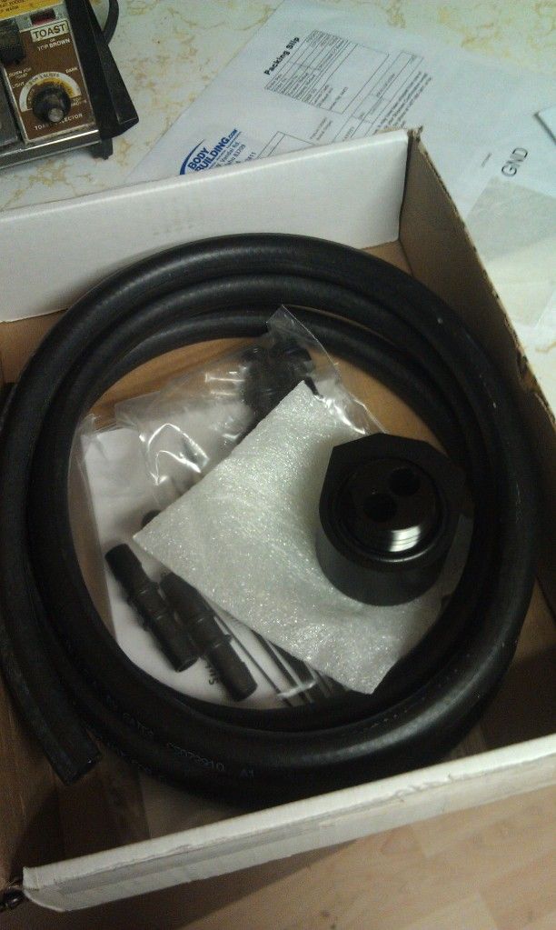

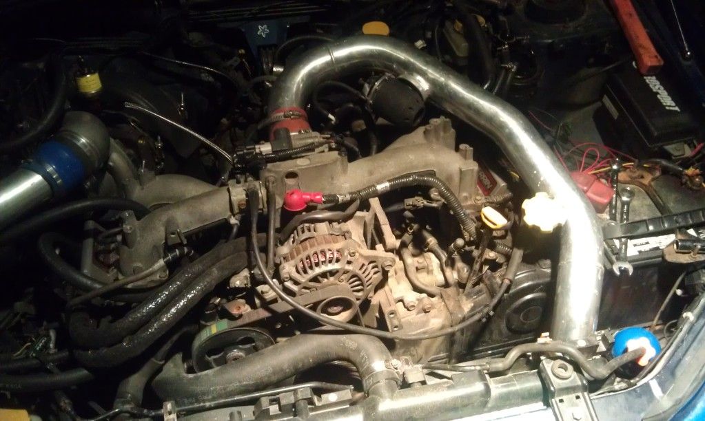

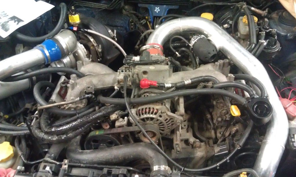

She will be fired for the first time when I get out of class, need to wire oil pressure sender so I can know oil pressure at the turbo, and ill take her off the jack stands for the first time in 3 weeks
Need to tune the oil pressure to the turbo, by adjusting the restrictor

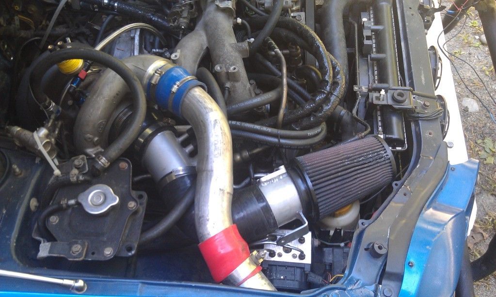

haha yes it would be. ive deleted my AC compressor, lines, condensor, etc now, so now i need to figure out how to mount the alternator there and then going rotated will be really easy, no spacers
putting the 15lb EWG spring in and 6puck after work then tuned this week and then just funnnnnn hahaha, videos will come

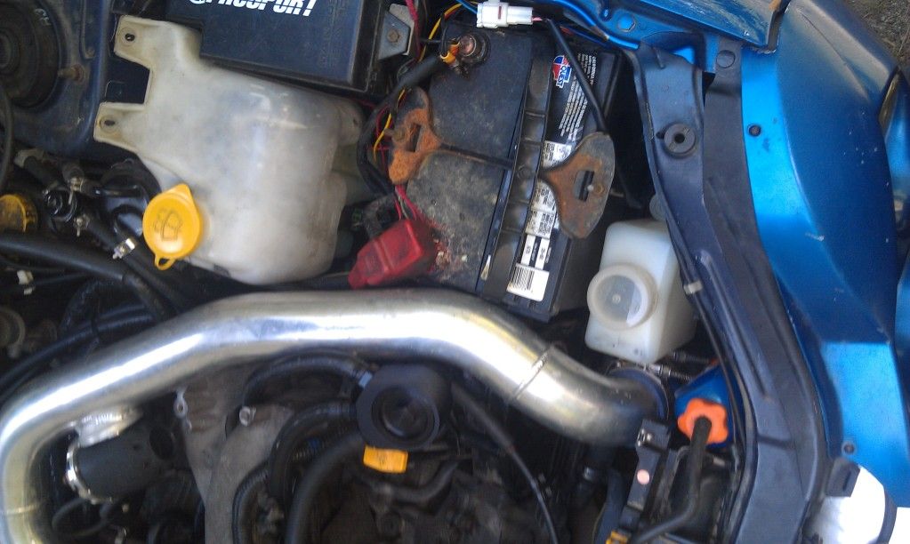

A/C deleted
A/O separator

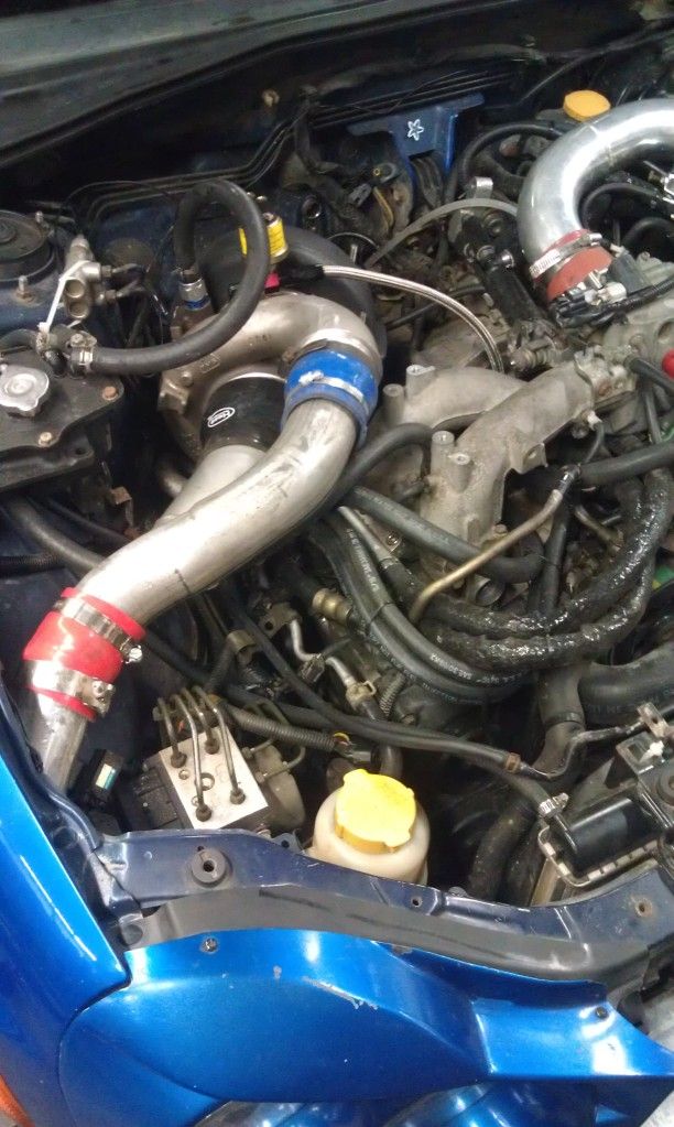

new charge pipe
moddin the intake
IC spray tank
current temporary intake, but MAF tube is rolled to a better postion
thanks man...and cars been running great at 22psi, hopefully this week it will be bumped up to 25ish and introduce antilag and FFS to the mix
